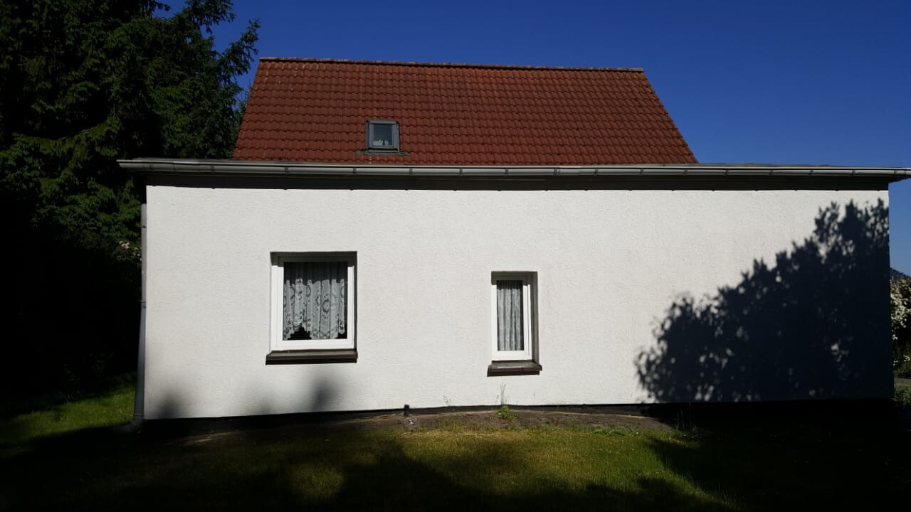

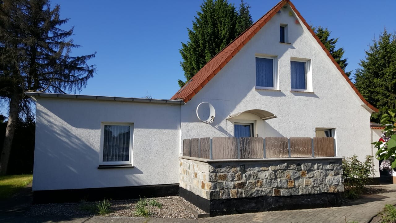

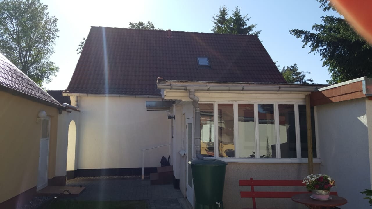

Today, I’d like to share some pictures of the exterior so you can get an idea.
South side
West side with extension
North side
East side entrance porch
East side porch, planned to be removed
Best regards, BastiI haven’t read the first 20 posts, but I want to say: the porch should stay!
The house looks charming and cozy. The porch is completely underrated. You can overwinter plants there, sit comfortably on cooler days, or shelter a grill. There’s enough space for a terrace as well. Please reconsider tearing it down...
SebastianDr schrieb:
Unfortunately, there are no more recent plans, and it is also not documented, In that case, a current survey needs to be conducted, initially even rough sketches made by non-professionals will do. Hopefully, there are still people around who witnessed the renovation and can be interviewed – that can also provide useful information.
I haven’t read the first 20 posts, but I want to say: the veranda should stay! That is probably a causal connection. The veranda itself may have its advantages, but: while the main house is old-fashioned but solidly designed, and the rear extension seems reasonably done (though certainly requiring upgrades in terms of modern thermal insulation for a main house), the veranda extension, as far as I can judge from the photos, looks like a makeshift job—something even Westerners at that level could have botched.
