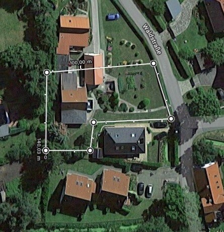

but as I said, still in the brainstorming phase. As mentioned, please share the plot details here, then interested contributors will gladly join the discussion.

Hello again, it’s been almost a month since we last posted here. I wanted to share an updated site plan of the house.
The gray roof areas indicate the extensions. The smaller one is planned to be demolished; it currently houses a porch that makes the hallway and adjacent areas quite dark. The larger extension contains the bathroom and a living room; the bathroom will remain but with an added skylight, and the living room will be opened up toward the existing living room to create one larger space.

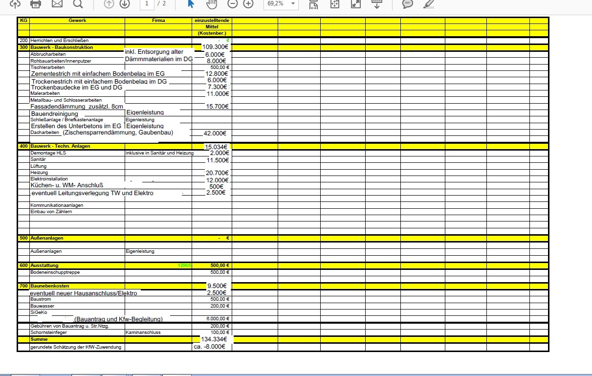

We had an architect visit to discuss the basic feasibility. We spent about an hour walking through the house, measuring, and explaining our ideas so he could provide a rough cost estimate.
The result was the table below, which unfortunately doesn’t match my expectations. The cost was €180 (about $195), and the calculations seem incorrect or unclear— for example, it’s not clear where the costs for the windows are included, etc.

There is a veranda here, but it makes the hallway and everything else very dark.Please expand the series of visual representations to include photos – and two additional drawings: ground floor (existing) and upper floor (planned).SebastianDr schrieb:
It is not clear where the windows are locatedI don't see them included there at all.https://www.instagram.com/11antgmxde/
