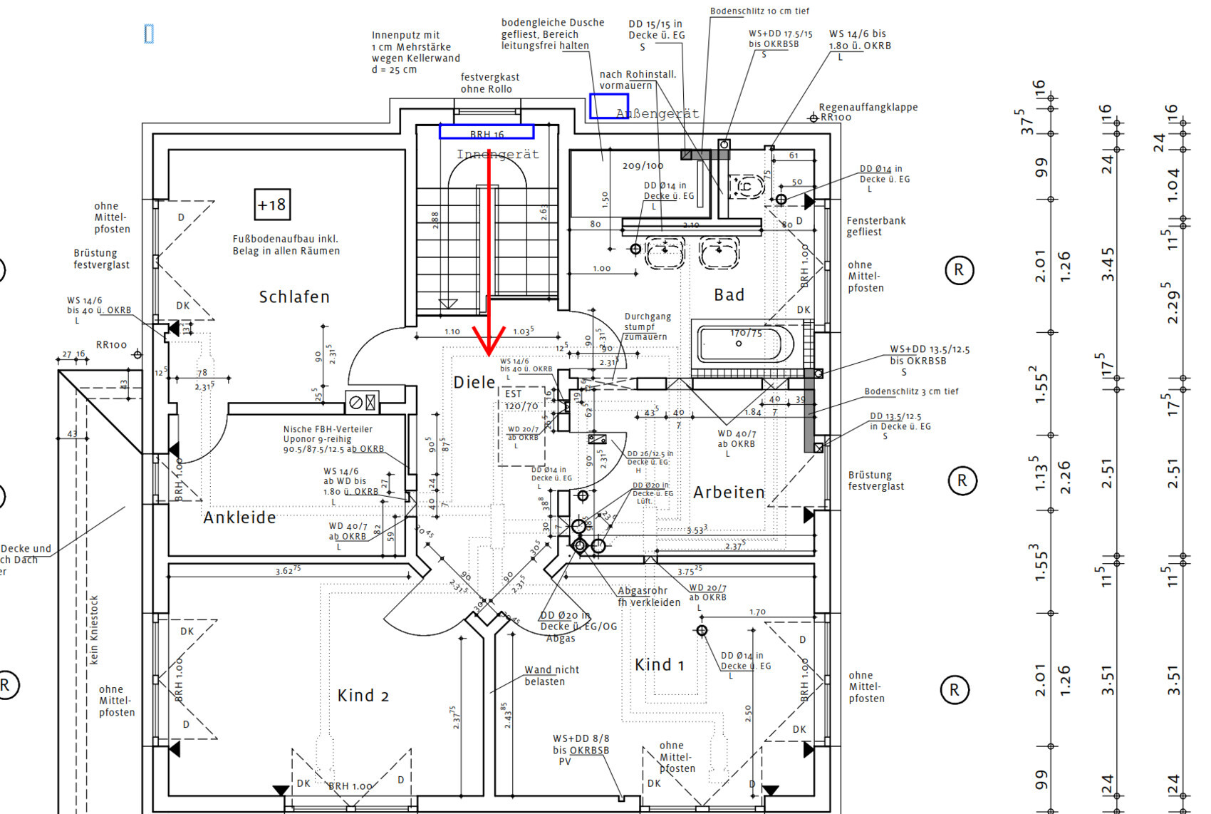

We have a stairwell with a half-landing and an adjacent wide hallway upstairs.
The idea is to install an indoor unit in the stairwell, above the window, directly below the upstairs ceiling. From there, the unit could blow air along the hallway and, with doors open to Child 1 / Child 2 and the bedroom, at least some cooled air would reach those rooms. Possibly supported by a oscillating fan placed in the hallway. The system would run in the morning until just after noon, when no one is home anyway. This way, the house would be pre-cooled during that time and wouldn’t keep heating up continuously. As mentioned, the goal is just to lower the temperature by about 2°C (4°F), not to cool all rooms evenly and draft-free down to 18°C (64°F).
The outdoor unit could be placed next to the ledge, and the piping routed straight up in the corner, even though that is on the north side, where our trash bins and firewood are stored. So it’s not exactly the most attractive spot...

Floor plan of a residential house: Sleeping, Hallway, Bath, Work; red arrow marks Hallway.

I have looked into this topic a bit myself and also talked to an HVAC specialist.
Your plan probably won’t work as is. We were recommended a split air conditioning system with three indoor units (for the three bedrooms). Personally, I would install ceiling units connected through the attic and mount the outdoor unit on a roof bracket.

Please keep in mind that cold air sinks. So it will flow down the stairs while the warm air from the ground floor rises. I assume that Child 1/2 will not benefit at all from the air conditioning with your current plan. RFR has already mentioned something similar.

thank you for the reply. The "proper" solution would be 3-4 indoor units, that’s clear. However, I want to avoid the effort, and especially the condensate drainage for the distributed indoor units would be challenging. That leads to using units with integrated pumps and all that kind of stuff. I would also prefer to avoid drilling through the upper floor ceiling. We have a concrete ceiling there, and making larger openings is not something you can just do easily.
I will probably consult local HVAC professionals soon.
