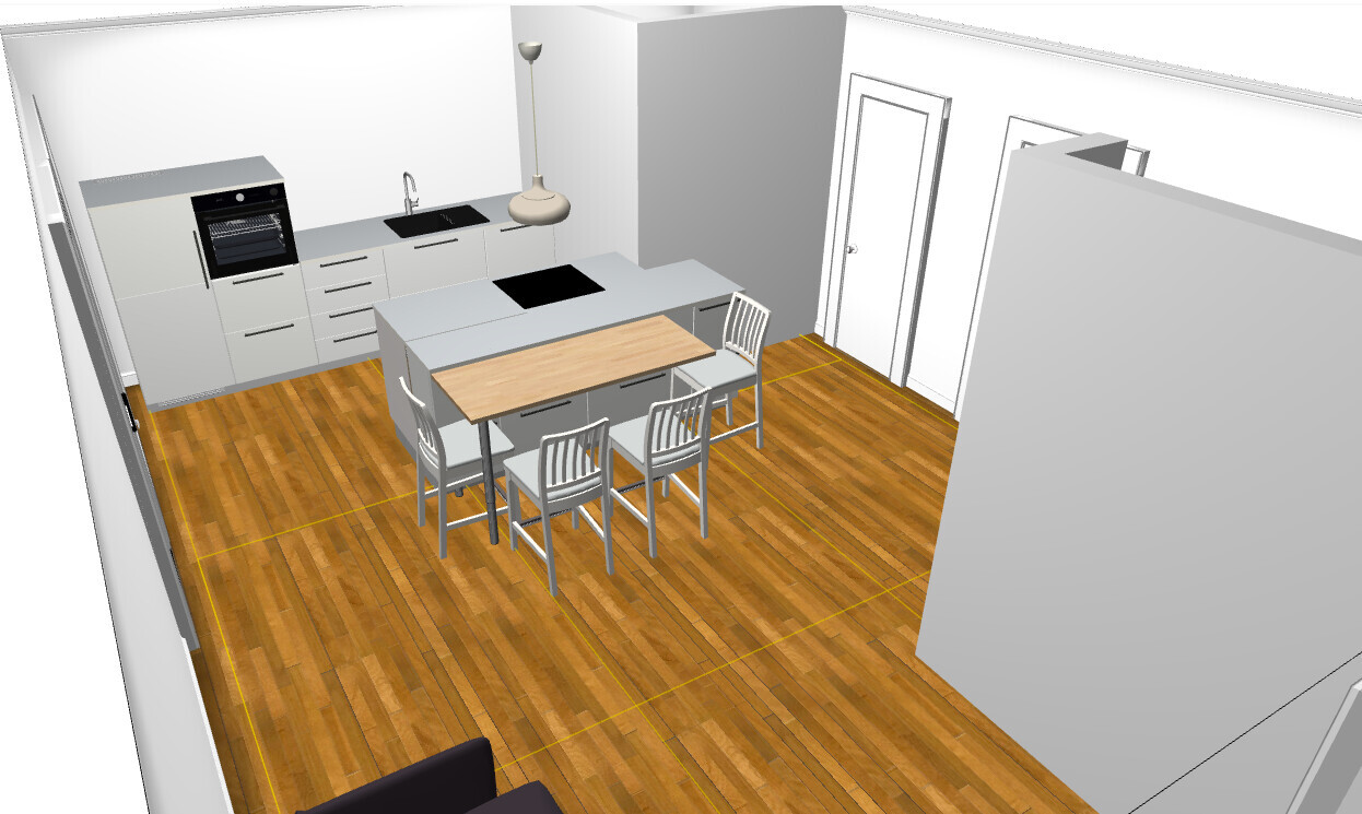

knalltüte31 Dec 2020 11:20Thank you for the many suggestions. Unfortunately, the program (IKEA Metod Planner) cannot handle some details, such as a dishwasher installed higher up (which is more important to me than an oven placed higher). The kitchen island with the table would also be slightly adjusted in size (the island a bit narrower to allow for more table width). But overall, I already like it quite a bit. 😉
After past and current discussions with my family, I will be hosting all celebrations for the next 10 years, such as Easter brunch, Boxing Day (the second day of Christmas), and others 😎 (I haven’t had the opportunity for many years due to lack of suitable living space). Therefore, the table must be able to accommodate 4-5 people regularly (for weekend breakfasts, etc.) and be significantly expanded on the occasions mentioned above. This is now possible with the current plan.
I’m happy to receive suggestions and improvement ideas nonetheless.
As a note: I would prefer not to have open shelving or upper cabinets. There should be enough storage space without them, right?

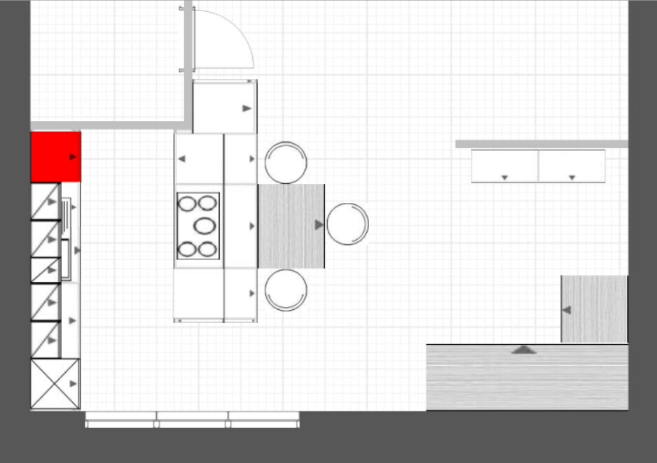

knalltüte31 Dec 2020 12:07Strange, there was just a post from @Bertram100, and now it’s gone??
But I had just read it and swapped the sink with the cooktop. Probably the right choice, since the sink is used more often, and this way the grease spreads less in the room (the cooktop is planned with an integrated downdraft vent / recirculating extractor).
On the right, where the oven is shown, the dishwasher would be placed at a convenient height (the software doesn’t allow this). The oven could go, for example, below the cooktop.
The suggestion about half-height drawers already came from my sister, who has some taller ones (for aesthetic reasons), but unfortunately the upper level of those drawers is just empty space, so they are not very practical.
I had already mentioned that the island should be narrower overall. Unfortunately, I can’t draw this in the planning tool here. If more people come, the table can be rotated 90° and extended further.
Bertram10031 Dec 2020 12:16Yes, zapp, you’re right. I wrote down some basic things and only later realized the thread was already on page 10 ;rolleyes: So I figured the basics have probably already been mentioned.
I would now move the sink slightly to the side so that there is only a narrow edge left (about 15cm (6 inches)). On the side you choose, you can also install the dishwasher raised within the wall cabinets (counting from the edge, either the first or second cabinet – better the first right away). That way, with one motion, you can sweep trash into the hopefully raised bin under the countertop on the island, rinse plates briefly if needed, and then turn into the dishwasher. When unloading, all dishes will naturally end up on just one side of the dishwasher, which is very practical.
With Ikea, it’s very easy to install a dishwasher in a raised position. That’s no problem.
The two towers are perfect for storing various small items. I hope you realize that. I would go up to the ceiling with them, like in your first design. It looks more appealing visually, especially since the kitchen is always in the same room.
I think you have planned a drainboard next to the sink. You can skip that, it’s not absolutely necessary. This way you gain more workspace.
Possibly, I would consider making the island a bit less deep. Not less than 80cm (31 inches), but around 90cm (35 inches) would be very good for working and help define the room’s layout. This will increase the distance from the island to the living area slightly. Shortening the island is just cutting. Just shorten it so the length matches a multiple of Ikea front widths. I once had 90cm (35 inches) depth and used three 30cm (12 inches) wide panels as side panels. It looked good.
I think this room will feel very comfortable.

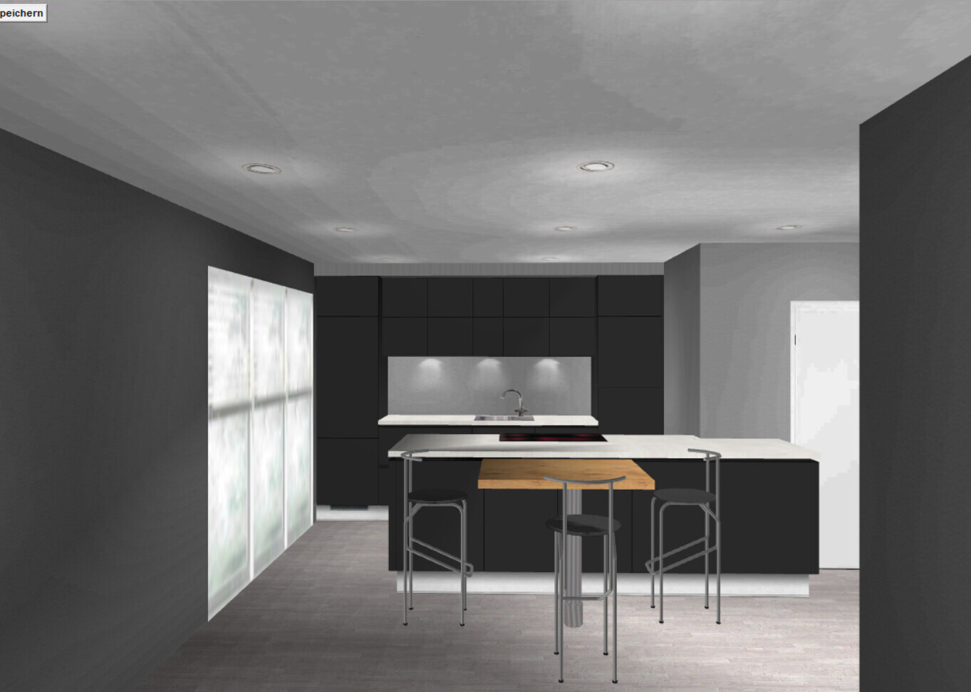

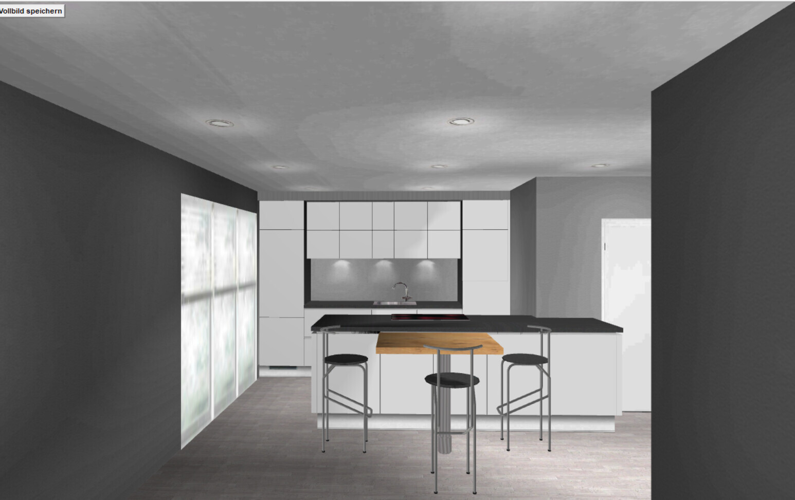

knalltüte31 Dec 2020 12:41Bertram100 schrieb:
... I think this room feels really comfortable. 🙂I agree ;-) Thanks for all the helpful suggestions. I’ve now added upper cabinets after all; it makes the wall look more balanced, and you can never have enough storage space.And about your concern that clutter tends to collect on the half-height cabinets—you hit the nail on the head. I currently have a unit with a fridge and pull-out pantry, and it’s covered with “junk” (well, there’s a nice tin of rusk, but everything else should really be cleared away).
Bertram10031 Dec 2020 12:48Looks good! I prefer it with upper cabinets. I see that you moved the sink forward. You could use an 80cm (31.5 inch) cabinet there and install a 60cm (23.6 inch) sink right-aligned. Then a 40cm (15.7 inch) cabinet for trash (with a tall drawer on top), and fill the rest as generously as possible. I have the same setup, and after the sink and trash, I have another 60cm (23.6 inch) cabinet. It’s very convenient: knives, cutting boards, cereal bowls, and cutlery all in the 60cm (23.6 inch) unit. Everything right at hand, “sister, scalpel, and Tupperware.” You have it all in front of you.
I would install the dishwasher elevated in the tall cabinet on the side. Really practical.
