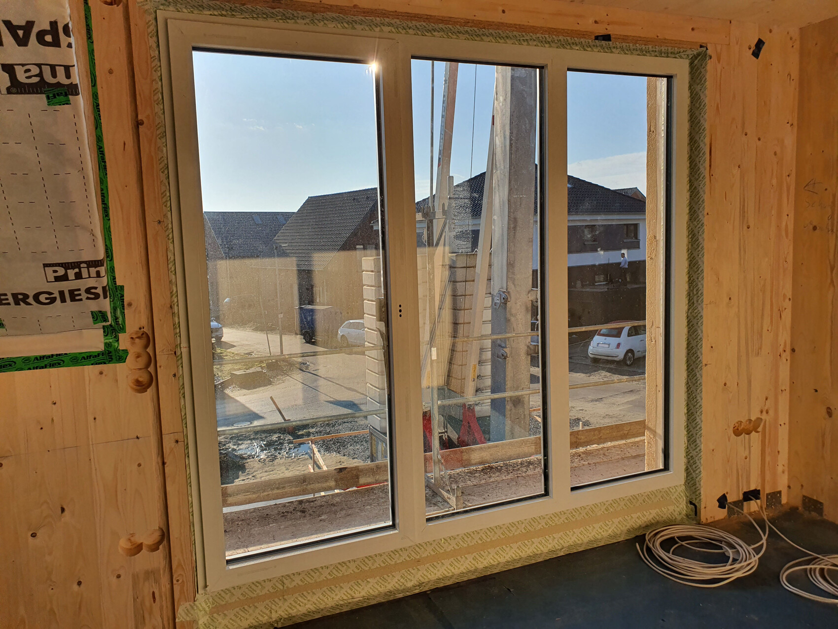

Unfortunately, it seems that a few centimeters have been lost during the planning process between the terrace element and the wall. I will measure tomorrow to see what the actual situation is after the window installation. Originally, 65cm (26 inches) was planned...

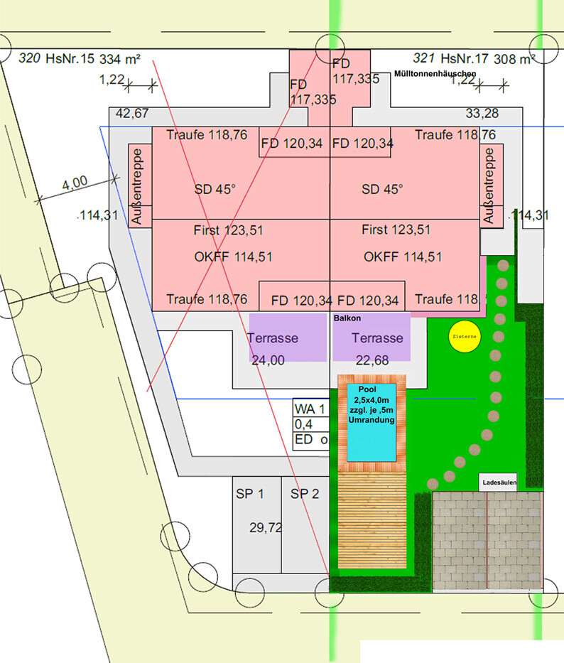

Here is a very early site plan to better illustrate the purpose of the south-facing view (though some minor changes have already been made after consultation with the neighbor to the right). The location and orientation of the pool will probably still be adjusted slightly. The wooden deck shown will be the sliding cover and upper insulation (lockable) for the pool, and will usually be over the pool. So the picture shows the pool "open".

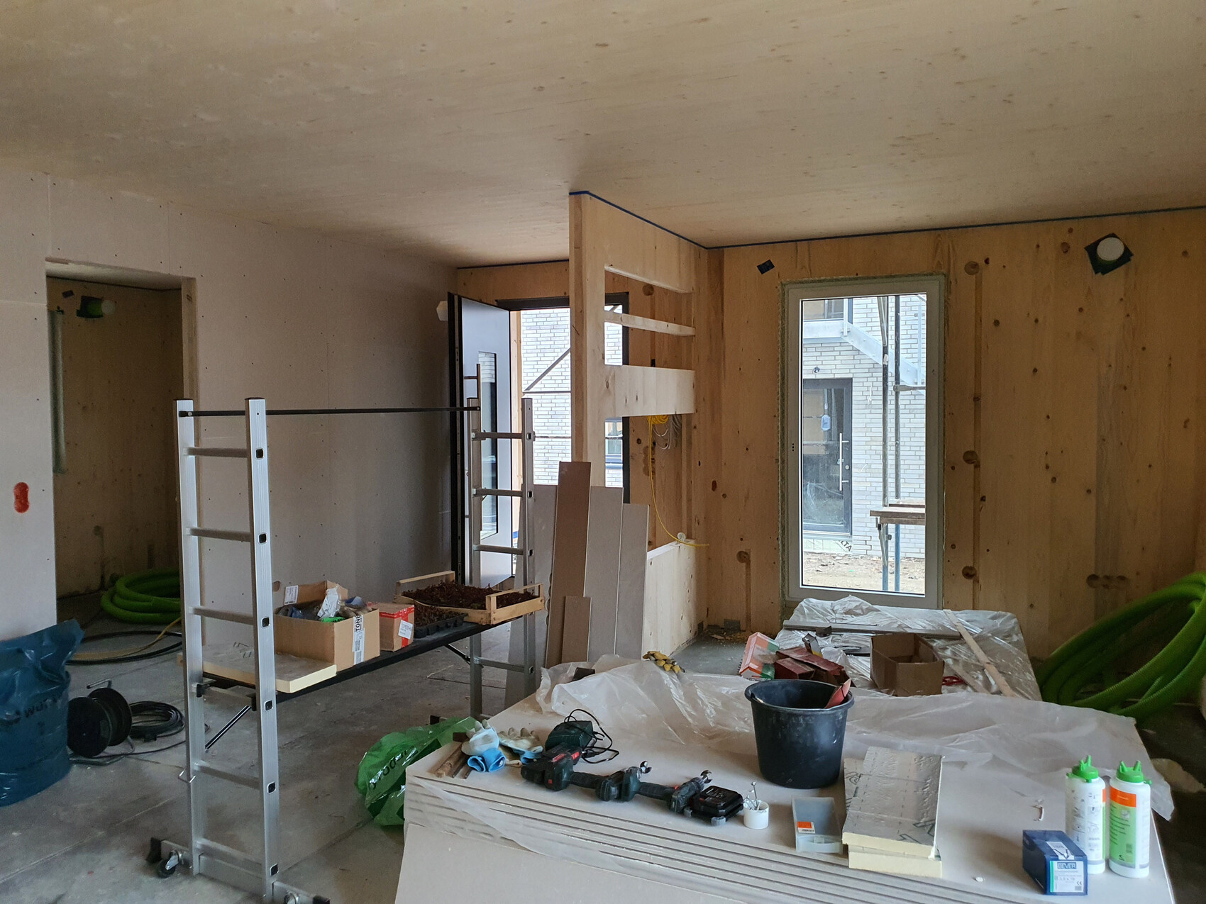

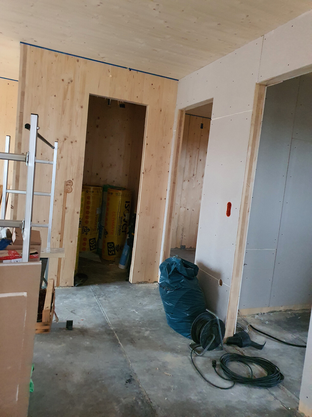

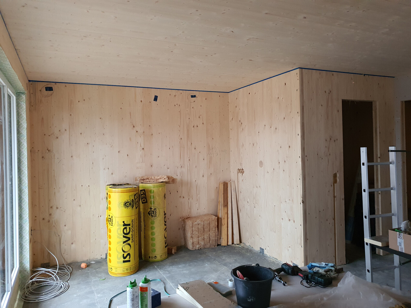

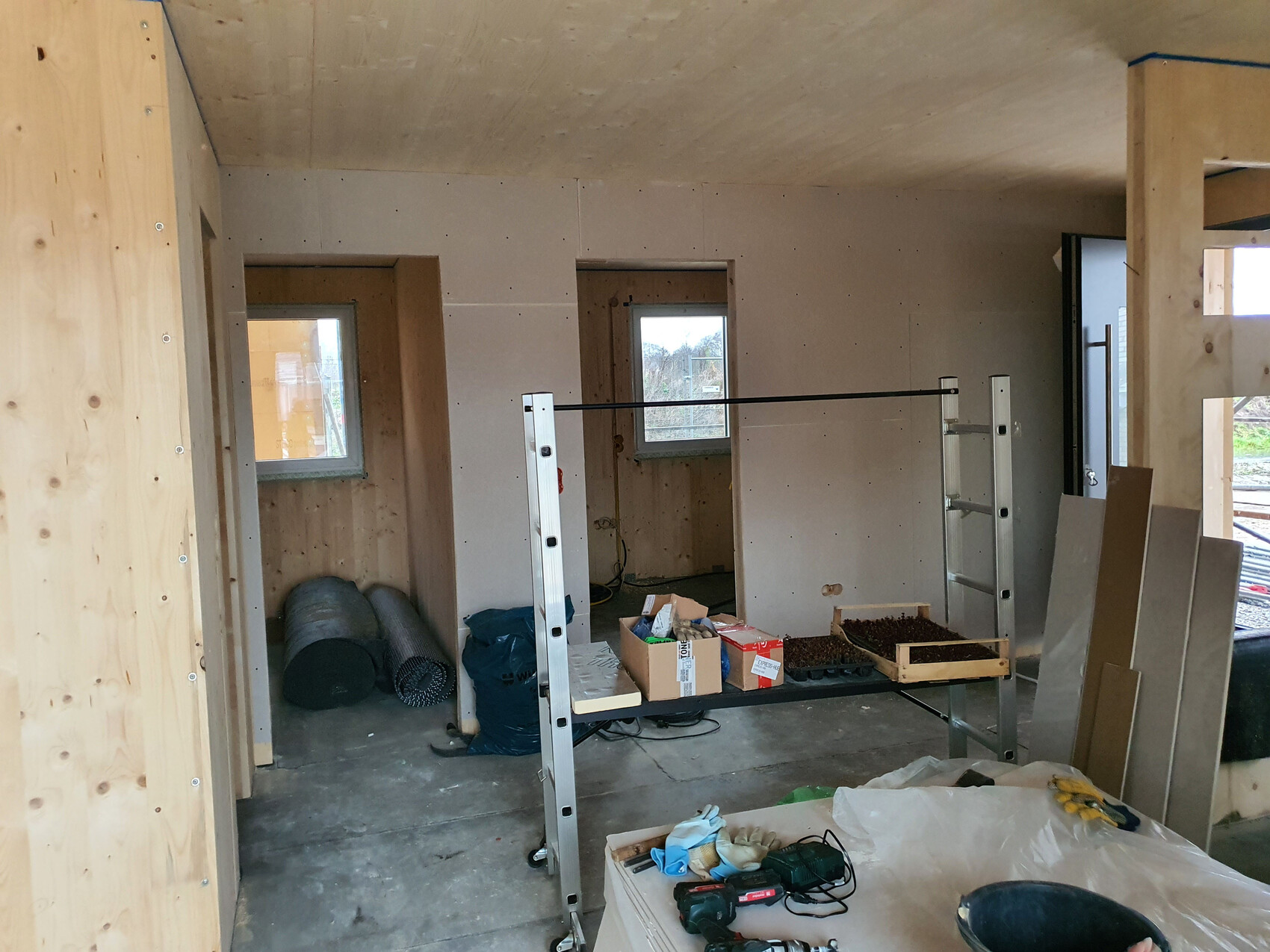

Here are some recent pictures of the open-plan kitchen and living area... Although the first photo is from the upper floor, the window element is the same on the ground floor (the door is the left element).
