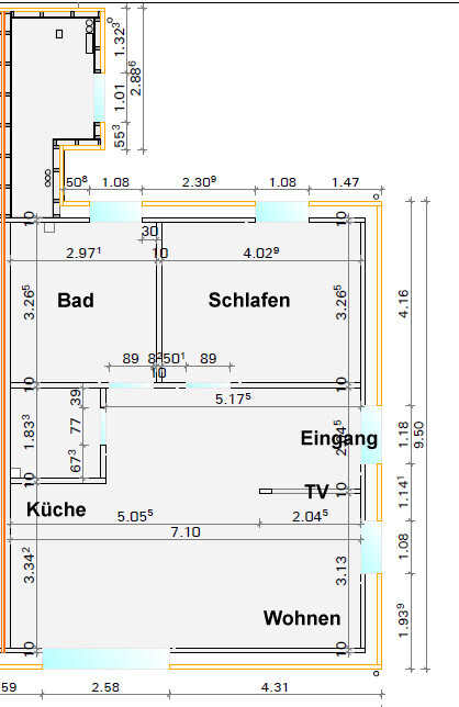

I am aware that the actual living area (entire apartment excluding the terrace) is only 59m² (635 square feet). Are my wishes even remotely feasible?

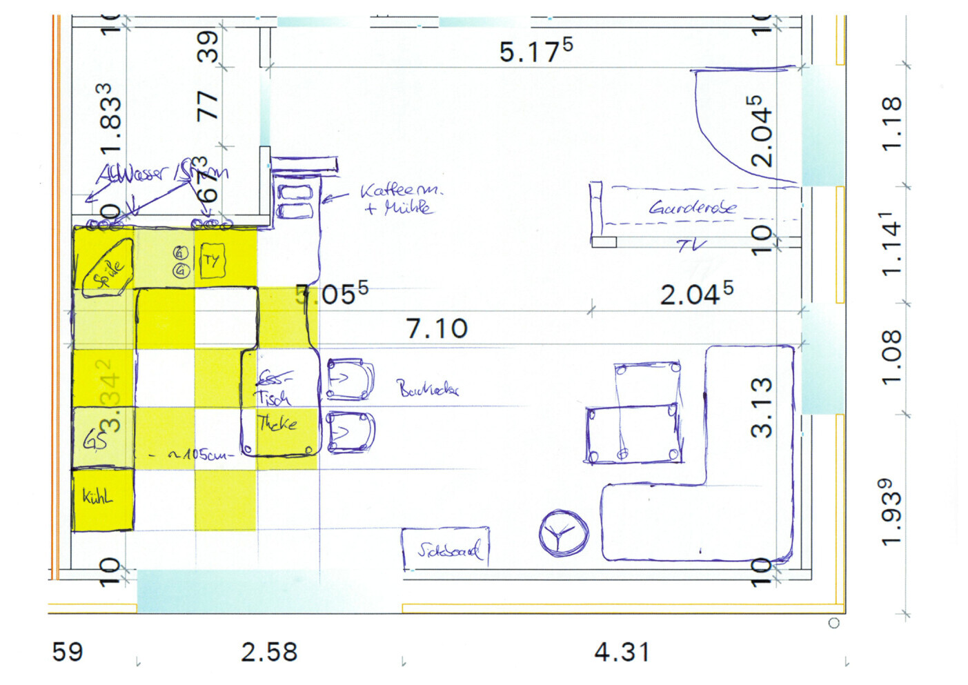

Bertram10020 Dec 2020 23:32Is the small room next to the kitchen a utility room or some kind of pantry? It would be practical if the room or part of it could be added to the kitchen.
If you want to avoid the kitchen taking up too much space, you could simply design the entire left wall of the plan as the kitchen area. That would be a bit tight and cramped, but it could work. It’s nicer with a small island in front. The table would then be roughly oriented towards the entrance/hallway and the sofa placed in the living room corner. I would prefer a smaller sofa over a smaller kitchen. After all, you don’t use the sofa as often, and there is no loss of comfort with a smaller, non-L-shaped sofa.
A Teppanyaki grill is overrated. It often just ends up sitting in a cupboard. In a small kitchen, I would keep such extras mobile and store them away. A downdraft extractor fan takes up space in the base cabinet and is definitely not a good idea for a smaller kitchen with limited storage.
Where are the water and electrical connections located?
I’m also thinking about how to make better use of the wasted space in front of the room doors. I would probably install a (half-height) dry stone wall where the left door frame of the utility room is, so that the small area would be considered part of the open-plan space.
knalltüte21 Dec 2020 13:03If @ypg has ever been justifiably laughed at 😎 I would now like to share my planning so far (as mentioned: I’m not creative) and respond to or keep waiting for constructive suggestions from @Bertram100.
The small room is the utility room, which will house smart home technology, the UV system, and the washer-dryer. The wastewater connection can be seen in the utility room at the bottom left as a small square. I can install electrical wiring wherever I want (we’re doing it ourselves). Currently, 2x 3 outlets are planned in the partition wall to the utility room. The common wall itself must not be chased; here I plan to run electrical lines inside the appliances or beneath the countertop and then have appropriate surface-mounted or built-in sockets. I expect to be able to run the dishwasher wastewater in front of the wall as well. For example, I would like the counter to be supported by only two slim supports, attached to the kitchen side with appropriate spacers (counter supports?).
In my current apartment, I don’t have an exhaust hood at all. A “normal” wall-mounted hood is out of the question. Since we have a controlled ventilation system, only recirculation is possible. I could imagine a wall-mounted chimney hood or slanted hood on the utility room wall as a last resort. But I would prefer a downdraft ventilation system, even if it takes up space in the base cabinets. I mostly need dishes just for myself, not a 12-piece set or seven pots and pans... so only limited storage space is necessary.
It might seem unusual to build an entire semi-detached house and then only use a small part of it myself, but I believe there are plenty of smaller single apartments or households that still managed to create a “stylish” kitchen (some even under less favorable conditions).
So I’m just trying to get the best out of the given circumstances and would be grateful for support. Also gladly from @ypg, whose often creative contributions I do appreciate 😉
I would remove the counter and replace it with a dining table. This offers more space than just for two people and you don’t always have to walk around the counter.
The idea with the coffee machine is nice, but in practice it’s probably really annoying if you have to walk around the counter for that as well.
