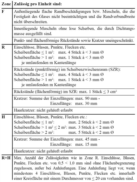

The windows are installed. Unfortunately, there were issues such as the attached glass damage, which cannot be photographed clearly with my mobile phone camera once installed, as the image always becomes blurry (glass is difficult to photograph).
This blemish is clearly visible from both inside and outside at a distance of 2 meters (6.5 feet). Do I really have to accept this according to regulations and case law? At least that is the information provided by the representative of the window supplier regarding acceptance.

If I did everything correctly, I googled this and read that shells are allowed 🙁That is no longer in zone F, but H. At least the one on the right in the picture (though the angle is difficult).

Bauexperte18 May 2016 19:56Glass Manual -
**8.6 Guideline for Assessing the Visual Quality of Glass in Construction
This guideline was developed by the Technical Advisory Board at the Institute of Glazing Crafts for Glazing Technology and Window Construction, Hadamar, and by the Technical Committee of the Federal Flat Glass Association, Troisdorf. Status: May 2009
**Source: Glass Manual; image included
I’m still a bit clueless and can’t quite assess the photo. Is the shell located in the middle of the glass or near the edge? The gray strip (?) confuses me 😕
"F" would not be objectionable, as it is at the edge; with "H" (pane), the situation looks very different, and the window supplier’s assistant should reconsider.
Best regards, Bauexperte

This concerns the right shell, which is still visible after installation. This means it is NOT on the edge and therefore not allowed. Basically, the guideline states that the shell must not be visible after installation.
As mentioned, as long as payment hasn’t been made, your position is quite good, and it should be a matter of honor to deliver defect-free products. Once payment has been made, you have to consider whether it’s worth making a big issue out of this. If they do not respond properly after a reasonable defect report, you have to decide whether to pursue the matter legally.
