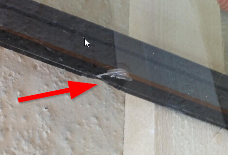

The windows are installed. Unfortunately, there were issues such as the attached glass damage, which cannot be photographed clearly with my mobile phone camera once installed, as the image always becomes blurry (glass is difficult to photograph).
This blemish is clearly visible from both inside and outside at a distance of 2 meters (6.5 feet). Do I really have to accept this according to regulations and case law? At least that is the information provided by the representative of the window supplier regarding acceptance.
If so, I would find that unfortunate, as I would then have to purchase a new pane at my own expense... 🙁.

Small crack visible in the wall component next to a dark strip
It seems to be about this "bubble" that is still visible after installation. It would bother me.

It’s probably about this "shell" that remains visible even after installation. It would bother me.
Exactly. Thank you.

I guess I’m a bit too clueless 😀
Anyway – we have to fix even the tiniest scratches ourselves. So your "shell" will hardly be something to be dismissed with tolerances... I’ll take a look at the guidelines tomorrow; unfortunately, I won’t have time before then.

Apparently, this is permitted according to the guidelines.

If I have done everything correctly, then I have googled this and read that seashell tiles are allowed 🙁
