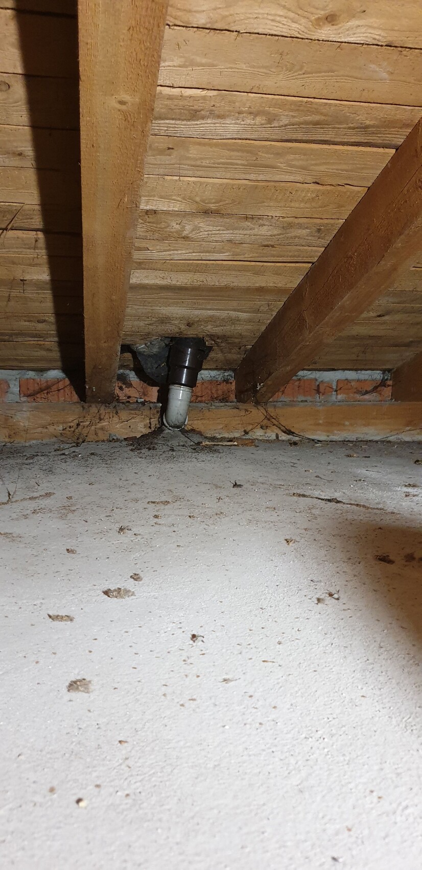

Dachboden mit Holzbalken, staubigem Boden, grauer PVC-Rohrverbindung und Ziegeln.

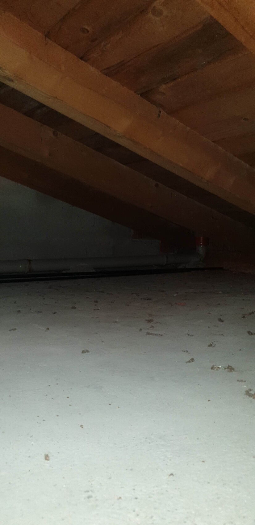

Kellerdecke mit Holzbalken, schwarzem Abflussrohr und weißem Winkel über staubigem Betonboden.

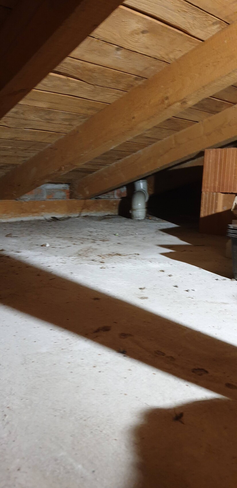

Kellerraum mit Holzbalkendecke und Rohrleitungen entlang der Wand, staubigem Boden.

- Also, can you tell me what those strange pipes are that run from the concrete floor through the roof?
thx
The pipes you see are the vent stacks for your wastewater system. They run through the roof to the outside. I didn’t use a mask—only if you’re working with mineral wool insulation, then wearing one is definitely advisable. Otherwise, there’s nothing major to worry about with these insulation boards in my opinion. Have fun and good luck! 🙂

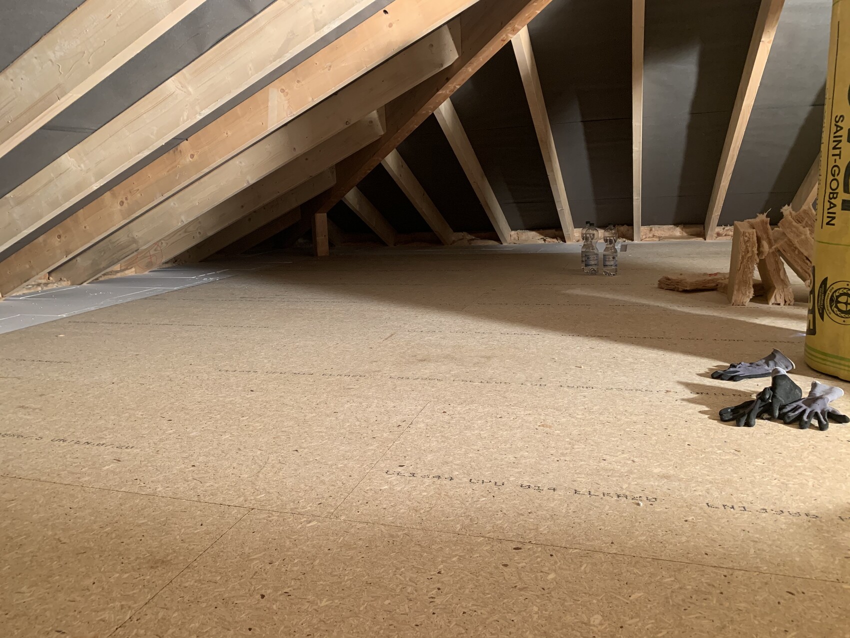

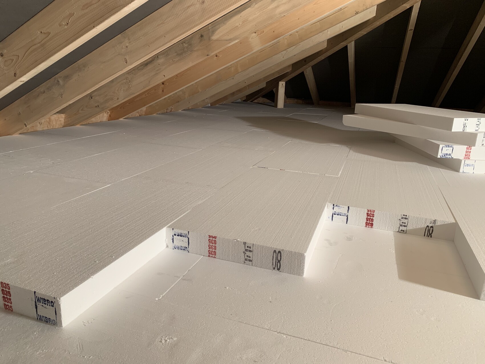

Once you have finished with the two layers, I recommend placing compression fleece between the masonry wall and the wall plate to prevent thermal bridging through the wood. Take a look at image No. 1.
Roof space with wooden beams, insulation material, gloves, and water bottles in the background
Roof space with white polystyrene insulation boards, wooden roof truss, stacked boards
