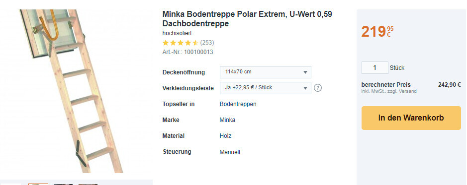

nordanney3 Nov 2020 11:16chippy79 schrieb:
I calculated the U-value using the proposed new setup with 16cm (6 inches) EPS 035 polystyrene boards: 0.19 is not eligible for funding!
So a) worse insulation and b) not €500 cheaper, but only €60 (€2,200 minus 20% funding = €1,760).
The answer to your question is clear from that.
nordanney3 Nov 2020 16:20chippy79 schrieb:
Are there any alternatives to buying a new insulated model? Any ideas?Sorry, I’m not familiar with this topic. I haven’t looked into it yet. But as far as I know, it is also subsidized.N
