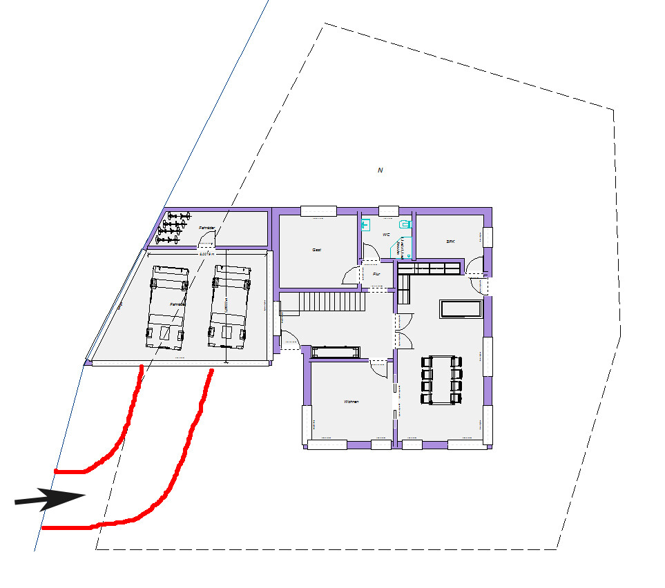

kaho67419 Aug 2019 14:53
a) What advantage is that supposed to have?
b) That would really only work for a carport; with a gate, you’d first need about one and a half meters (5 feet) of wall on the left side.
a) Light, light, light – from the west.
b) Nobody really wants a gate at the carport anyway.
Dear original poster, are you allowed to build right up to the edges with outbuildings, as is common on most building plots? Or is it different where you are? As I said, the driveway will stay where it is. I just want to move the carport around the corner.
19 Aug 2019 15:43
@kaho674
Take a look:
Too bad about the driveway. However, you can also angle the driveway by 90 degrees and place the garage facing north with the entrance to the south.
I would consider trying that out.
kbt09 schrieb:
Having the entrance facing west would be an advantage.
That contradicts the position of the driveway here.
Cayman
19 Aug 2019 15:46
I don't see any reason why building right up to the property boundary would be a problem. I haven't found any information against it...
kaho67419 Aug 2019 15:47
I don’t quite follow now. Somewhere
@kaho674
Take a look:
??? What exactly do you mean now? Kerstin and I both thought the house faces west. What is contradictory?
kaho67419 Aug 2019 15:52
Apparently this is confusing. To clarify, this is how it is supposed to work:
Floor plan of a house with a double garage, interior layout and red access road to the property.
19 Aug 2019 15:53
kaho674 schrieb:
I don’t follow now. Somewhere
??? What do you mean now? Kerstin meant the house opening to the west, and so did I. What contradicts?
Am I mixing something up? I read south. So: driveway on the property at the bottom left of the plan would be allowed. Center left on the plan would not... where is west? Let’s say this much: I understood that Kerstin means left side of the plan.
