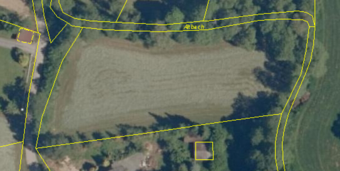

After initial discussions with the architect, we are still not 100% satisfied, so I would like to ask the forum for suggestions. At the moment, I feel like I’m at a dead end with no way out, as every idea does not achieve the desired effects. The idea of having a secondary apartment is generally not bad, as housing is very scarce in our area.
Development Plan/Restrictions
Plot size: 4000 sqm (1 acre), of which 800 sqm (0.2 acres) is buildable
Slope: slight north-facing slope (approx. 1 m (39 inches) over 20 m (22 yards))
Roof type: flat roof
Architectural style: Bauhaus
Development plan attached
Style, roof type, building type: flat roof, modern
Basement, floors: basement, ground floor, first floor
Number of people, age: two adults, a child on the way, minimum 2 children
Space requirement ground floor, upper floor: 175 sqm (1880 sq ft)
Office: home office
Guest bedrooms per year: 15
Conservative or modern building method: modern
Kitchen island
Number of dining spaces: 8
Fireplace: yes
Balcony, roof terrace: possible, not planned
Carport
Utility garden
Planned by:
-architect

Am I confusing something? I read south.
So: the driveway at the bottom left of the plot would be allowed. Middle left not.. where is west?
Let’s say this: I understood that Kerstin means left on the plan. So south is basically “down.” I would almost call the shaded side east, as it faces fully onto greenery.
On the south side, about 10m (33 feet) away, there is a higher hedge/shrubs.
Yes, the view is of course important as well. But for an all-around happy package, sunlight needs to come into the house first. It enters from the south and in the evening from the west. Only early risers get it from the east.
You don’t look at the greenery all day long; at some point, you also read a book. Then you want light inside the room, even in winter. The terrace can still focus on the view to the east.
