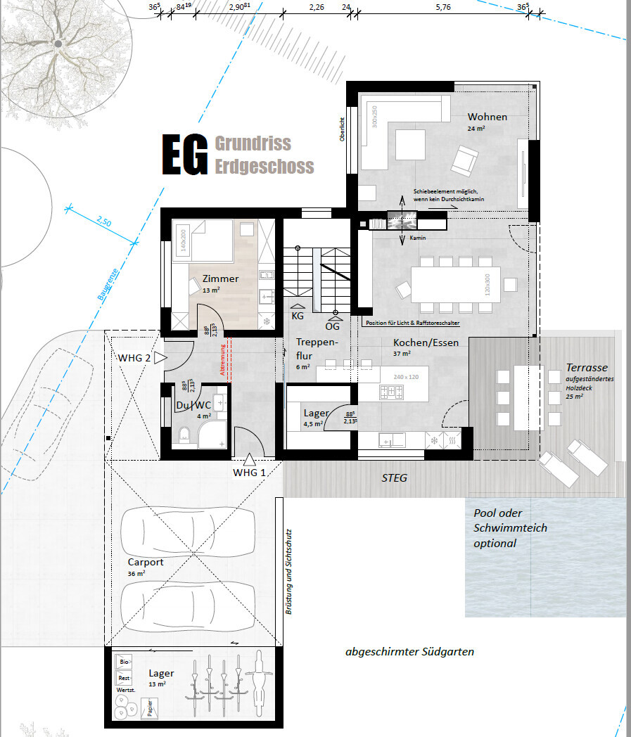

the open design, the first floor is perfect. Views from the living and dining areas as well as from the kitchen into the greenery
What don’t you like? Why?
Kitchen next to the staircase, pantry on the south side, staircase on the north side, living room in the northeast

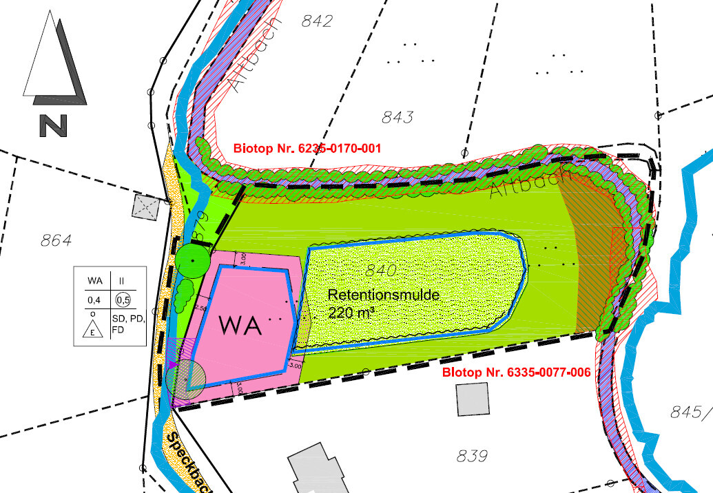

Topographic plan: green area with retention basin, biotope, and watercourse.

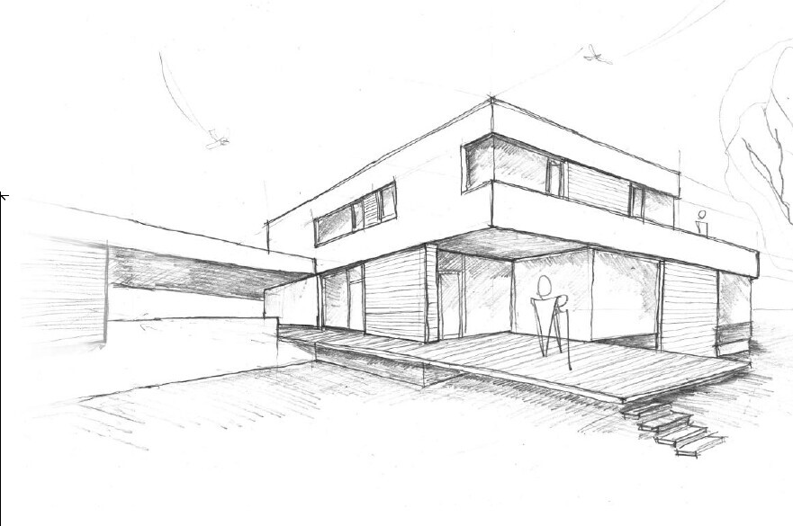

Modern, two-story villa in sketch style with terrace, steps, and person at entrance.

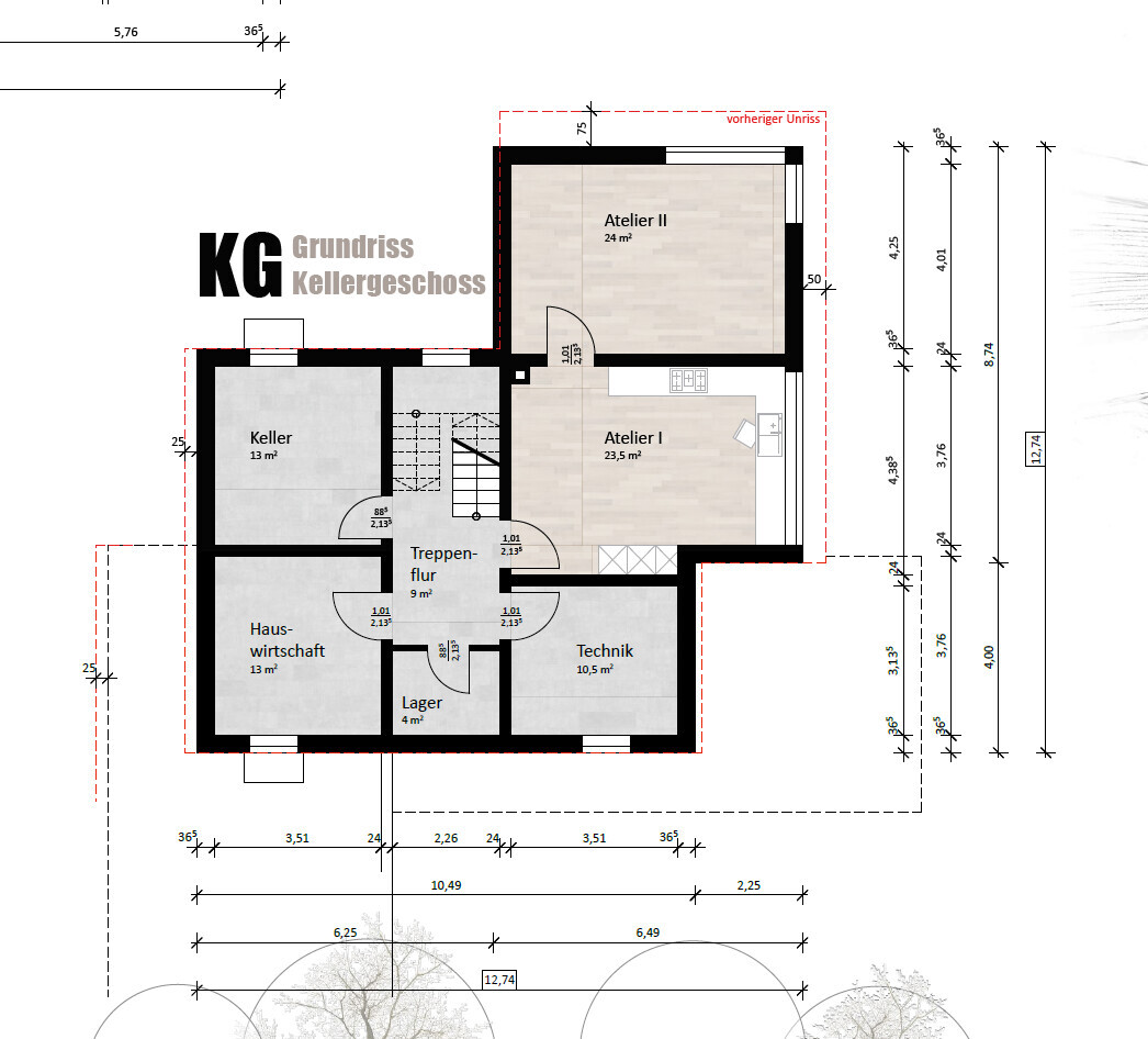

Basement floor plan: studio I & II, technical room, cellar, storage, utility room, stair corridor.

Ground floor plan: living, cooking/dining, room, shower/WC, stair corridor, terrace, carport, storage.

Just from a brief look, I find the two children's bedrooms quite small compared to the very spacious rooms (is a bathroom of 18m² (194ft²) really necessary?). The huge dining table feels too bulky. The kitchen should be redesigned.

Could you place the house on your plot and also mark north (N) on it?

The Bauhaus style is not defined by a specific appearance but primarily by function, realized in a clear, consistent, and minimalistic way through a symbiosis of design (in this case, architecture) and craftsmanship. This design is not Bauhaus but incorporates visual elements that recur in some Bauhaus houses.
Nonetheless, I find the house design very attractive and appealing. You seem to place a strong emphasis on sociability. From that perspective, the kitchen being open to the hallway is a bold and consistent choice. I like it.
On the upper floor, there are arrows labeled "view." It might be worth considering giving the children a bit more space combined with these views. With a slight rotation (even if only the upper floor is rotated), you might be able to create three rooms with a "view."
Is there no view on the ground floor?
What about the access path and visibility from "outsiders"?
How is the orientation (already mentioned)?
5 Aug 2019 22:17
Kitchen facing the stairwell, pantry in the south, stairs in the north, living room in the northeast
However, we don’t know where north is on your house.
