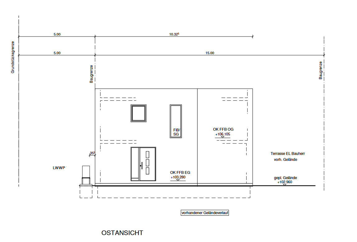

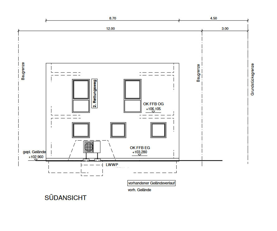

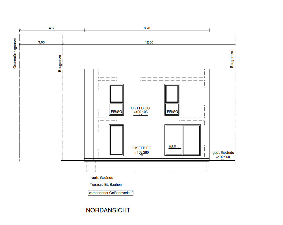

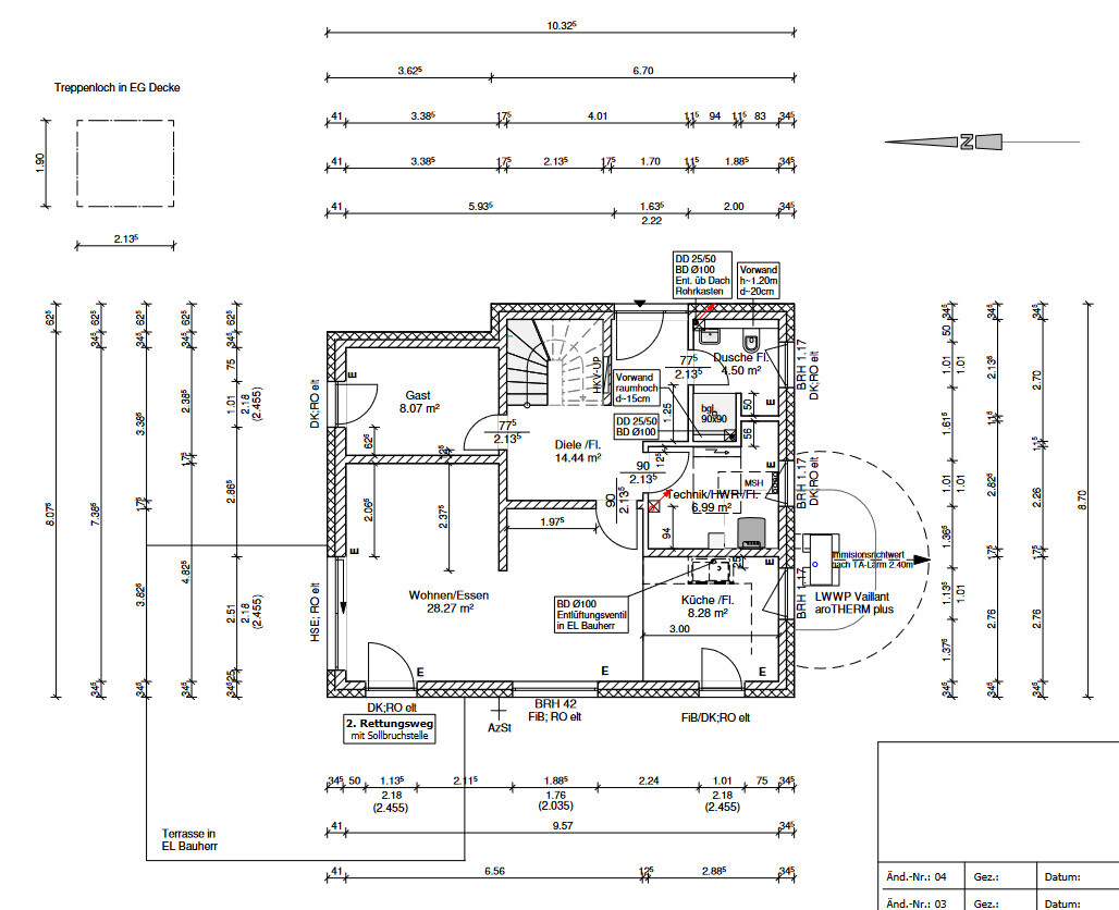

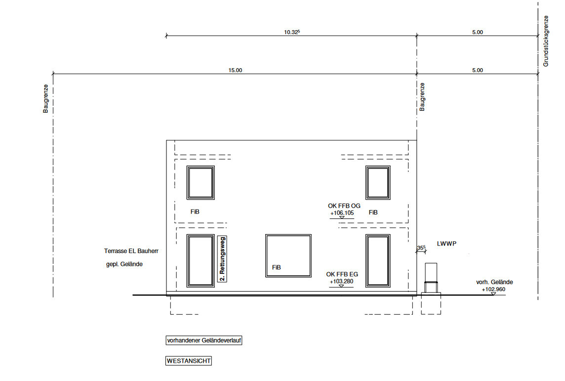

MansionHello dear building community!
We are several months further along in the planning process, financing is secured, and the development of our zoning area is almost complete. We hope to start construction by the end of the year. We are currently finalizing details with our general contractor and are especially interested in your opinions and experiences regarding our window layout. We are not yet completely satisfied with the exterior views. The windows have not been ordered and can still be changed.

How wide is the passage at the entrance between the stairs and the wall? 80 or 90 cm (31 or 35 inches)?
You mention an open ground floor, but that doesn’t match this complicated ground floor plan...
Why such major changes from the previous layout? This is basically a complete redesign?
The site plan is missing, ideally with the house drawn in.
Also, try adding some furniture, especially the kitchen. The space isn’t very large, so careful planning is necessary. At first glance, an island doesn’t seem feasible. A U-shaped layout, in particular, can significantly limit cooking with more than one person.

Mansion schrieb:
Based on the floor plan of a gable roof house with a high knee wall from a South German eco-friendly prefabricated timber construction companyWhy choose a donor design with a completely different “blood type”?SoL schrieb:
Why such major changes compared to the previous floor plan?
This is practically a complete redesign?At least it’s a respectable improvement — unfortunately, the "style" of the façades still looks like stamped parts :-(The façade layout somehow reminds me of pixelated graphics in Btx, kind of “left-aligned” as if sketched in a word processing program ;-) (but at least not symmetrical).
Myrna_Loy24 Sep 2022 19:4711ant schrieb:
Why choose a donor design with a different blood type, of all things?
At least it’s a considerable improvement – unfortunately, the "style" of the façades still looks like stamped panels :-(
The façade layout somehow reminds me of pixel art in Btx, roughly "left-aligned" as if sketched in a word processor ;-) (but at least not symmetrical).It reminds me of shoebox houses, like the ones my kids sometimes make as crafts. So I guess neither of them will be architects. 😀Besides the roof, I would also add greenery to the façade.
