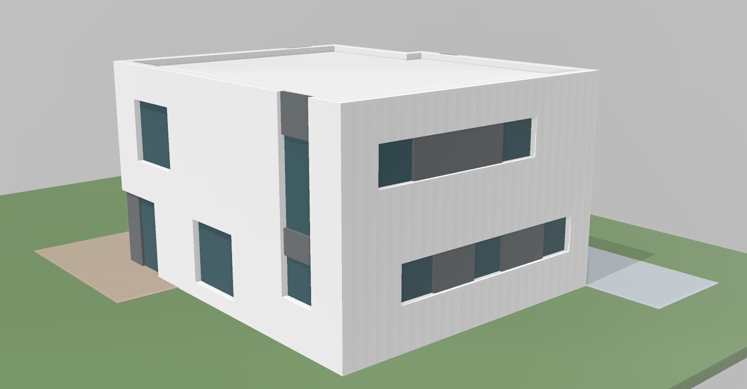

We are several months further along in the planning process, financing is secured, and the development of our zoning area is almost complete. We hope to start construction by the end of the year. We are currently finalizing details with our general contractor and are especially interested in your opinions and experiences regarding our window layout. We are not yet completely satisfied with the exterior views. The windows have not been ordered and can still be changed.

Dislikes and reasons: exterior views on west and south are still unusual and need getting used to

What do you consider especially good or bad about it? The garden is very important to us. In our opinion, the rectangular floor plan suits the plot better than a square one to maximize use of the land (sun on the west terrace). We are three people, and I primarily work from home, my wife occasionally. That’s why having 4+1 small rooms was important to us.

xMisterDx28 Sep 2022 00:06Mansion schrieb:
We are building 135 square meters (1450 square feet). The fixed price is confirmed. Maybe now it becomes clear why I can no longer do a redesign. It simply gets too expensive because everything would have to be recalculated based on the daily current prices.
(...)Don’t let that unsettle you. If everyone built to what is considered "basic standard" here, only the top 10% would live in their own houses, while the rest would be stuck in prefabricated blocks or underground shelters.
derdietmar28 Sep 2022 14:20derdietmar schrieb:
There’s still potential to make something out of it.I like it, it looks so much more modern 😀 As my username suggests, I also have a cube-like house. My windows, however, are much larger to make it look right. The appearance of your house is more like a cheap flat-roof design from the 1960s. But you can see from Dietmar’s suggestion that with some façade design and changes to the windows, you can already achieve a lot—without significantly increasing the window areas.
