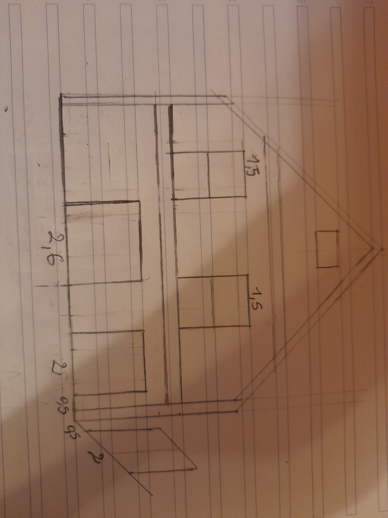

So, I like it: the office on the west side with the chair sunny 😀
But now about the floor plan.
I think it’s better to place the dressing room entrance at the beginning of the bedroom; that makes more sense and is also cozier for the bed, meaning the person sleeping.
I’m not so fond of the exterior views; I would at least add some asymmetry to the garden side and create a larger window section in the dining area. That would add some character.
The shower won’t work like this: the space isn’t high enough for the showerhead.
We also considered whether to plan a seating window instead of a door on the south side of the dining area, or do you mean, for example, to enlarge wide doors at the corner of the dining area, for example both 1.5m (5 ft) wide instead of 1.13m (3 ft 8 in) and 1m (3 ft 3 in)?
9 Nov 2020 15:38
RaInEli schrieb:
We also considered whether to design a seating bay window on the south side of the dining area instead of a door, or do you mean, for example, wider doors at the corner of the dining area, maybe both 1.5m (5 feet) wide instead of 1.13m (3.7 feet) and 1m (3.3 feet)
No, I don’t mean a seating bay window, just something like a corner window. The 1.13m (3.7 feet) one towards the corner, and then a 2-meter (6.6 feet) door window at the same corner but in the other direction. In my opinion, this symmetry doesn’t look good here because the house is relatively wide. I would experiment with the patio doors there. On the upper floor in the same direction (west?), the facade could handle the outer windows being brought closer to the central one. This might only be about 40cm (15.7 inches) or so, then the lower ones adjusted somewhat, but not symmetrically… consider how you plan to furnish the terrace.
Personally, I would tend to plan wide windows with a window sill because with wide houses that looks more harmonious; furnishing options are also better, and the light distribution inside the rooms then spreads more horizontally, matching the room proportions.
R
RaInEli
9 Nov 2020 20:25
No, I don’t mean window seats: just something like corner windows. One side 1.13 meters (3 ft 8 in) towards the corner, and then on the same corner in another direction a 2-meter (6 ft 7 in) door window. In my opinion, this symmetry doesn’t look good here because the house is relatively wide. I would experiment with the patio doors there. On the upper floor, in the same direction (west?), the facade could handle the outer windows being positioned closer to the middle. That might be just 40 cm (16 inches) or so, then the lower ones adjusted somewhat, but not symmetrical... think about how the terrace will be furnished.
Personally, I would rather plan wider windows with a sill height, as this looks more harmonious in wide houses, offers better furniture options, and the daylight distribution in the rooms then extends more horizontally, matching the rooms.
So I tried to sketch it out—roughly in the direction you mean?
Sketch floor plan of a building with several rooms and corridor; roof gable visible.
9 Nov 2020 20:29
Yes, that's roughly what I mean for the ground floor... For the upper floor, I meant windows with a parapet.
