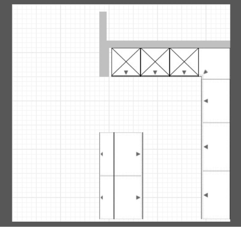

Kitchen like this

evelinoz schrieb:
Kitchen layout like this
[ATTACH alt="1605073360665.png"]53386[/ATTACH]
Thanks for the picture

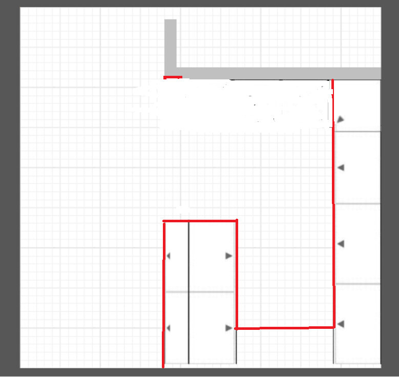

11 Nov 2020 07:15
That would work just as well, wouldn’t it?

Pinky030111 Nov 2020 07:34
No, because that creates corners that are less practical to use.
Nico238
11 Nov 2020 08:14
Pull-out drawers become difficult in this case.
Are regular small doors still installed at the lower section nowadays, or is that considered old-fashioned?
In our current rental apartment, we still have a kind of rotating corner cabinet, which is actually quite practical.
