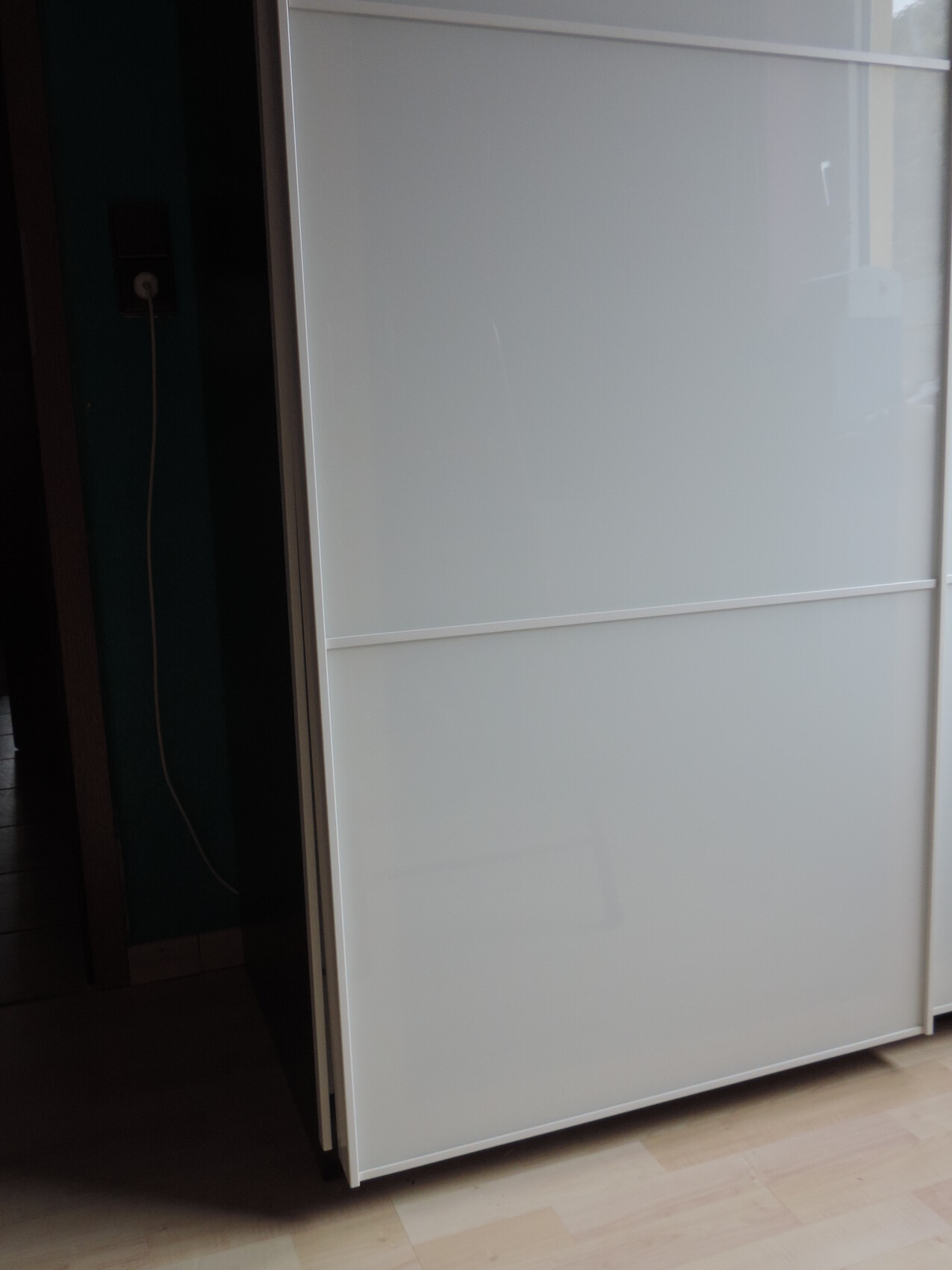

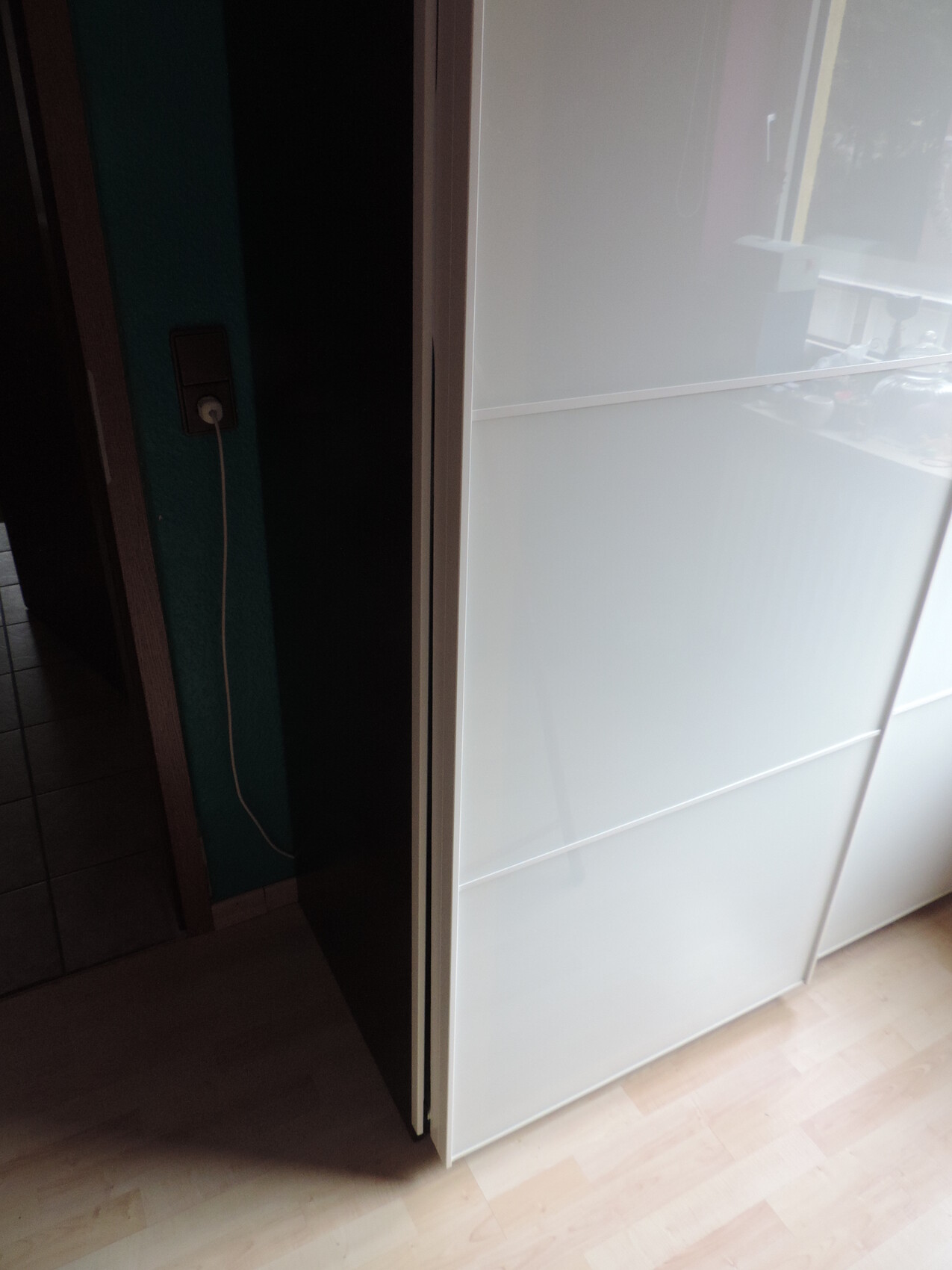

I have one with white glass sliding doors. Yesterday, I had a problem where one of the doors kept getting stuck in one spot. We then realized it was in the wrong track, which caused a lack of space between the two tracks. However, yesterday I didn’t notice this gap yet, and the lines/hinges on the glass aligned perfectly (now the lines are more on top of each other).
Today, when the door was put into the correct track, it could finally slide all the way to the other side.
BUT on the left door, on the left side, there is a gap, meaning the door is not sitting as it should.
There is no gap at the top, but it gets bigger the further down you go. When I push the door forcefully to the left, just to see if the gap would close, the door wobbles strangely upward (sorry, not the best description).
Here are a few photos:
P.S. My father thinks it’s because the cabinet is “uneven”. It is slightly, but yesterday the door still fitted well and there was no gap, so that can’t be the reason.
I hope you might be able to help me. I’d rather not leave the cabinet like this. Thanks in advance.
Best regards, Christina

IKEA-Experte26 Jul 2015 18:33Hello, you can try adjusting it as shown on page 32, with the left side up and the right side down.
