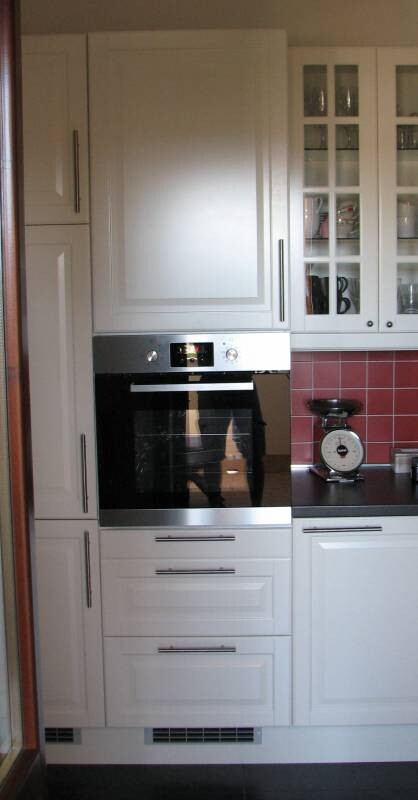

we gave it a try and bought a 90 cm (35 inch) door along with the narrow drawer (about 9 cm (4 inches) wide), which is actually meant to be installed below the oven when using the standard base cabinet.
As mentioned above, we got the drawer slides (IKEA sent them to us free of charge!). The first issue, however: the hinge holes on the 90 cm (35 inch) door are positioned about 0.5 cm (0.2 inches) further away from the top/bottom edge compared to the 57 cm (22 inch) door we had before. This also applies to the 34 cm (13 inch) door, which I initially wanted to combine with the 57 cm (22 inch) one. Does anyone know why this is? The result: the door now hangs about 0.5 cm (0.2 inches) higher than the door of the neighboring tall cabinet, even though I raised those doors to the maximum and lowered the 90 cm (35 inch) door as far as possible (this can be seen in the photo).
Installing the oven slides was not a problem, although I had to get the drill, because the mounting plate is not compatible with the three pre-punched hole rows of the tall cabinet (is this normal, or did the IKEA employee send us the wrong model?).
By the way, the stability mentioned above is not an issue with our setup. The only downside is that the oven does not sit as firmly on the slide as on a shelf and can shift about 0.5 cm (0.2 inches) back and forth if you shake it vigorously (on the shelf, it could be pulled out slightly if you pulled the handle too hard). I will have to think of a solution for this.
Apart from that, the two remaining gaps above and below the oven (each slightly less than 1 cm (0.4 inches)) bother us a little, but since we did not want to lose storage space under any circumstances (the alternative would have been the microwave), we now have to decide whether we can live with it.
Here is the picture:
P.S.: Don’t rely too much on the IKEA kitchen planner. They often only know the basic dimensions and usually don’t foresee how the final result will look. It’s best to plan everything carefully yourself. The IKEA planner might help to find some creative solutions. In several cases for us, their ideas didn’t work out in reality or were unsuitable.
