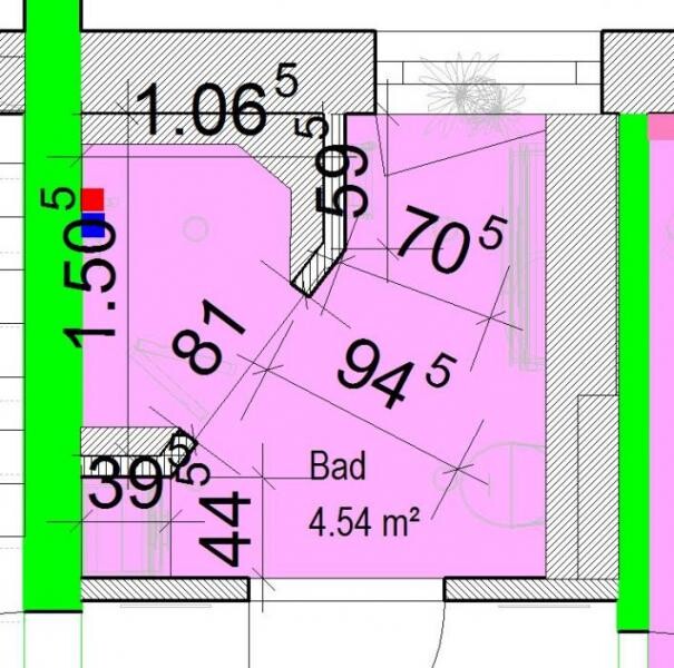

My bathroom has the following floor plan:
Floor plan of a bathroom with pink room area, bath 4.54 m² and dimension lines.

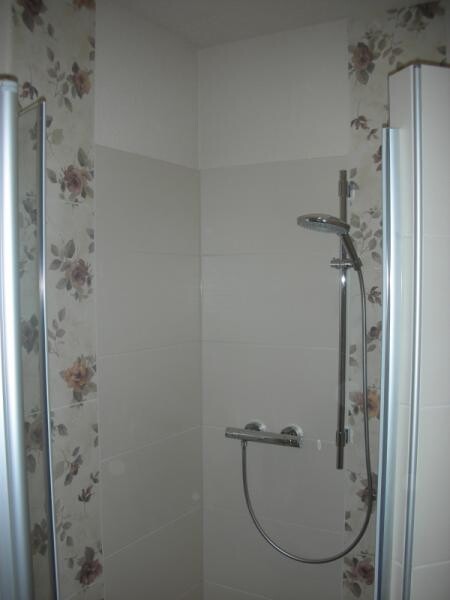

I have a two-part glass shower door from Schulte that opens inward and, due to the shallow depth, folds inward as well. You can see a similar setup here:
Shower enclosure with handheld showerhead, adjustable holder, glass shower screen, light tiles.
(small bathrooms are very difficult to photograph )
At the bottom, on the floor, there is a very narrow threshold about 5 mm (0.2 inches) high, against which the door closes from the inside. This keeps it watertight.
