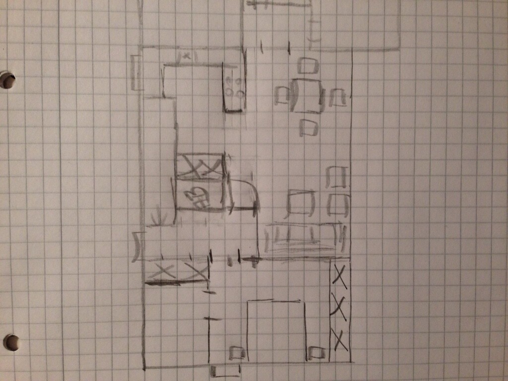

Good day everyone. I’m new to the forum and would like to get straight to the point.
I would like to present a floor plan for discussion.
It is the first upper floor, designed to accommodate a family of four.
The exterior walls are fixed, as is the size of the balcony.
Also fixed are the position of the staircase and the two load-bearing walls.
What can be improved to gain more space and storage, and possibly create a walk-in closet for the bedroom?
The external dimensions of the building are exactly 15 m by 10 m (49 feet by 33 feet).

Maria16 schrieb:
If you don’t have direct access to the basement, you shouldn’t plan an emergency room there for teenage kids...No, it wasn’t meant that seriously. There is a guest room with a bathroom in the basement.ypg schrieb:
What is the total room depth without the loggia? From where to where?
From the north exterior wall to the balcony window: 6.87 m (22.5 ft) excluding the wall itself
