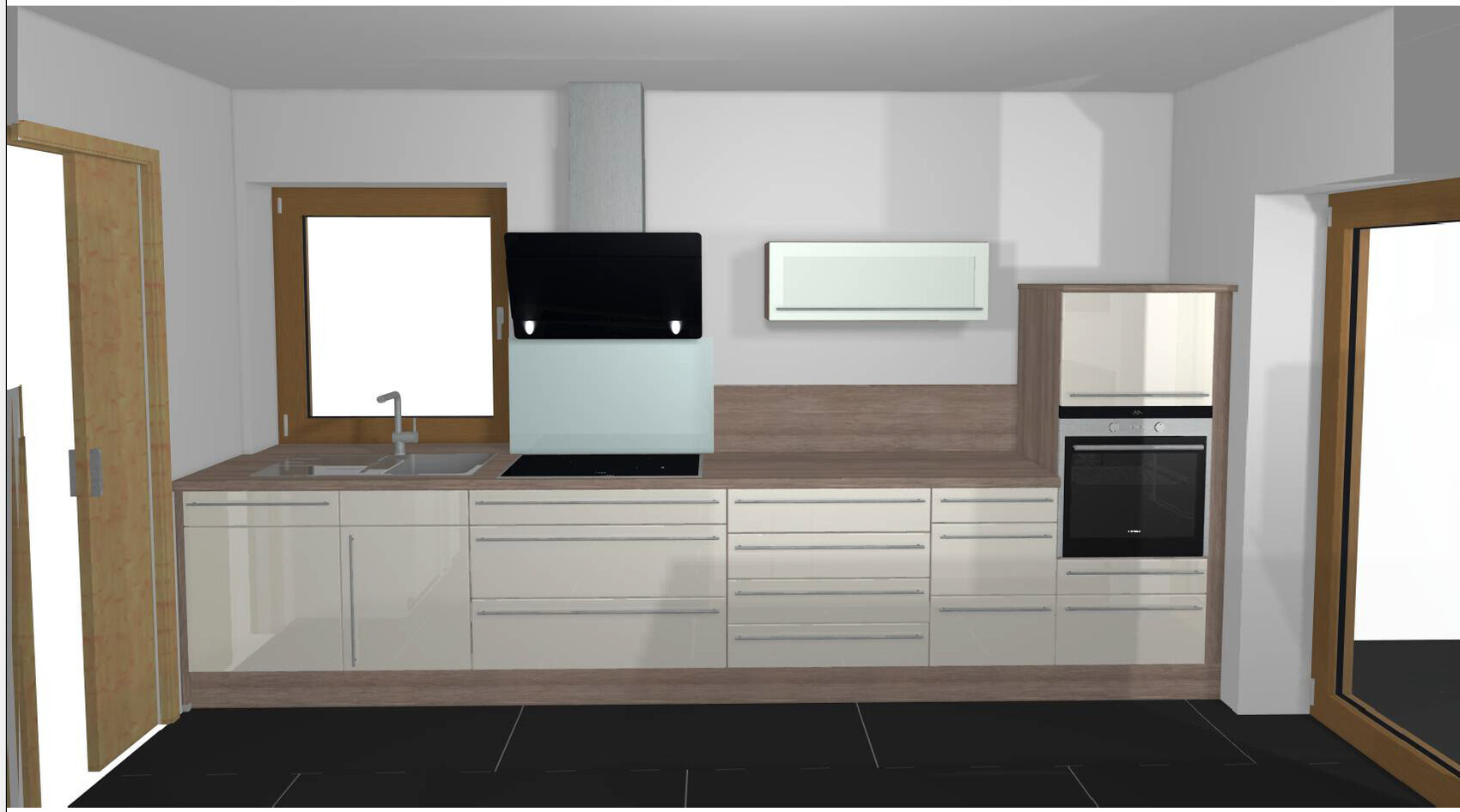

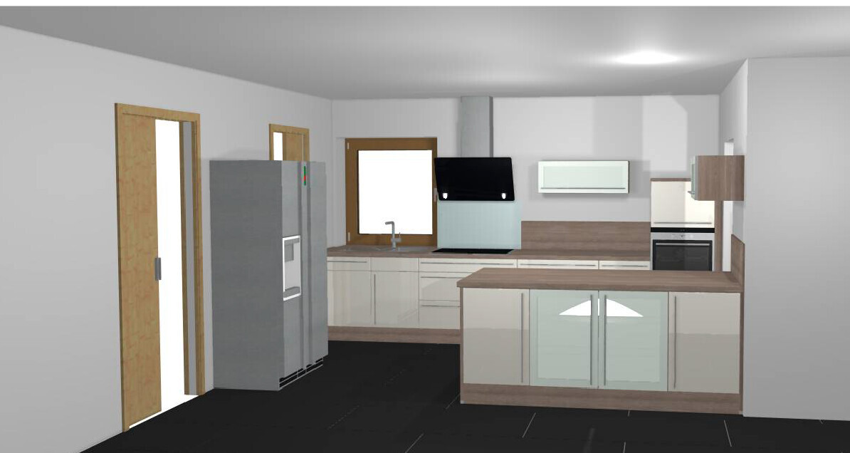

Try furnishing the kitchen at a kitchen showroom—just for fun—and see if it works! (Right now, everything is still possible.)
