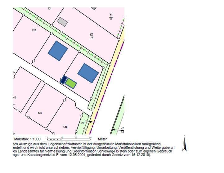

thank you very much for your previous suggestions. I have added the building again to the site plan. Additionally, I included the neighboring property with the house.
Site plan of a plot with parcels, green boundary lines, blue building areas, scale 1:1000
This means my west-facing terrace would be opposite my neighbor’s southeast-facing terrace.

Lulu24118 schrieb:
thank you for your previous suggestions. I have added the building again to the site plan, including the neighboring plot with the house.
One more thing I thought of: according to the development plan, my neighbor’s house is about 1 meter (3 feet) higher than mine. Could this affect the sunlight exposure?
