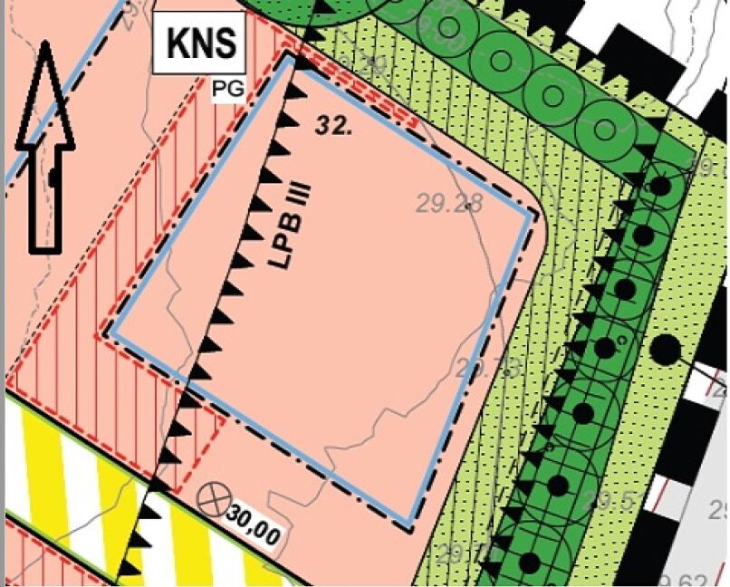

I need your advice and support. Attached you will find our plot of land that we want to build on. It is a north-facing plot, bordered on the left and at the back by a tall hedge.
According to the development plan, the eaves side should face the street, and the red shaded area is designated for a carport, garage, etc.
How would you position the house?
Thank you very much for your help

Lulu2411828 Dec 2016 08:41Can no one help? The plot faces southwest.
It is always helpful to upload such image files as pictures 😉 … I have done that for you.
Where does the property end? Before the green bend? And do the red areas on the left lie along the property boundary?

Lulu24118 schrieb:
No one can help? The plot faces southwest.You have to expect that only very few people will take the time to try to understand this plan.
There is no legend, so you should explain what the lines represent. Also, it would be helpful to know what is located "to the left and right."
Is there a floor plan available? At the moment, it feels like we're just "groping in the dark."

Lulu2411828 Dec 2016 13:26Ok, thank you very much for your suggestions.
A brief introduction about myself:
I am 34 years old, married, with one child aged 4 years.
About our building project:
The plot of land has already been purchased. We plan to build a single-family house of 160 sqm (1720 sq ft) with a pitched roof (roof pitch 45°) next year. According to the development plan, we are only allowed to build with the eaves facing the street.
The plot is located rather to the north. On the right side, there is a hedge about 2 m (6.5 ft) high, which, according to the development plan, must also be preserved. Behind the hedge is a road with a 30 km/h (18.6 mph) speed limit zone.
On the left side is the neighboring property. The area shaded in red is designated for carports, garage, etc.
