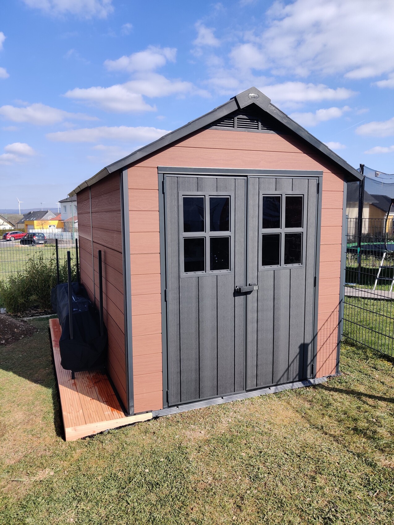

About a year ago, I asked for experiences with WPC houses: https://www.hausbau-forum.de/threads/gartenhaus-bilderthread-zeigt-her-eure-gartenhausbilder.27304/post-398275
Since no one could provide any feedback, I decided to gain experience myself. 😉
We bought a Keter Newton 7511 made of WPC and assembled it ourselves. The base structure consists of screw piles and a substructure for WPC decking and 15 mm (0.6 inch) plywood panels. The house is screwed onto this. Assembly was really easy with two people. The only issue is the left door, which is a bit tricky. We are now having it replaced.
Next to it, we built a small "deck" from Douglas fir, where we store our firewood.
