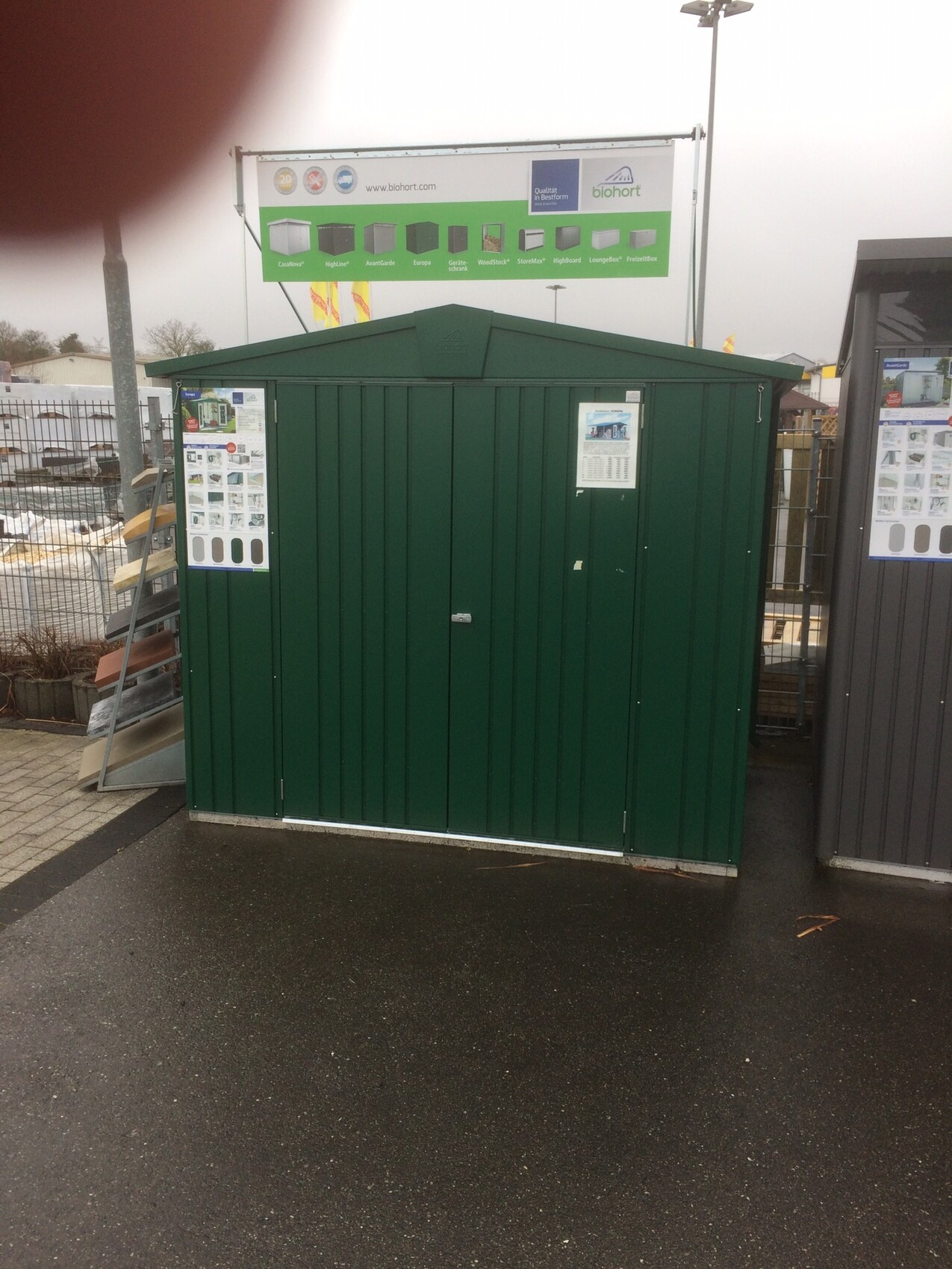

Nordlys schrieb:
We looked at a lot of sheds made of wood and metal and eventually decided that those biohort things are expensive, but very well made, while the cheaper ones all seemed flimsy. The door is tall enough to easily put things inside.So? Does the metal make noise?
