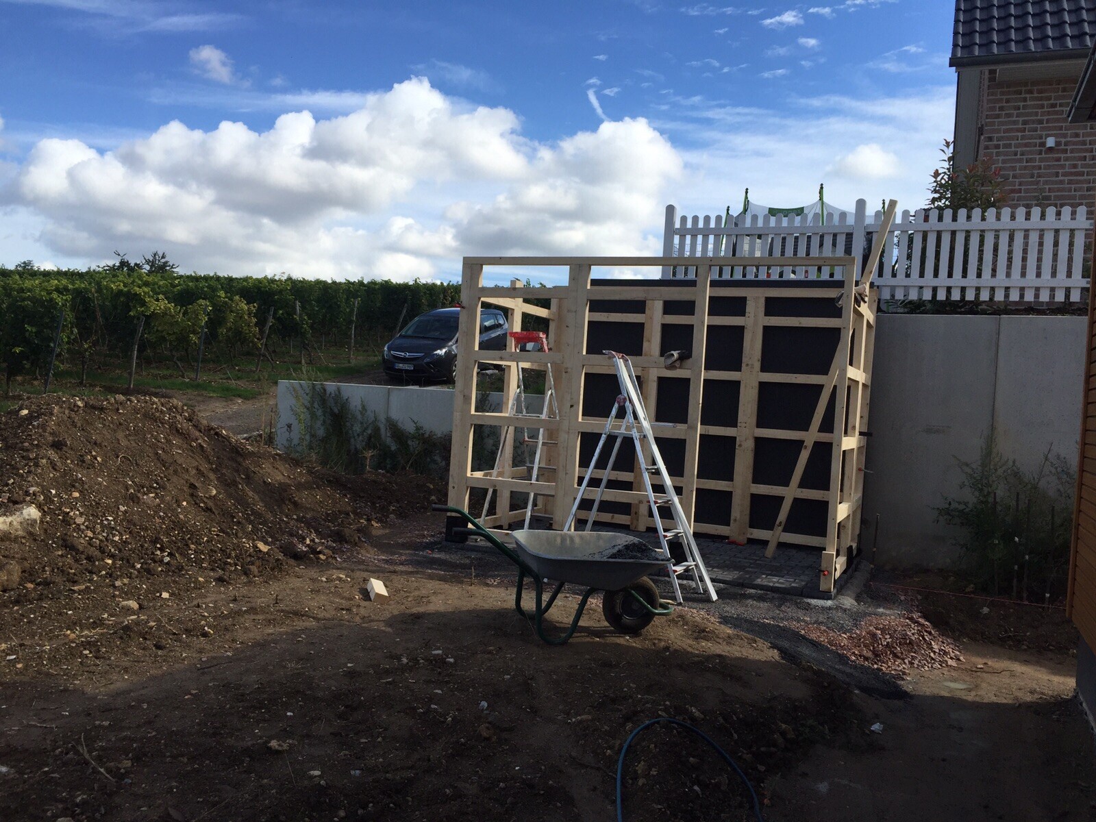

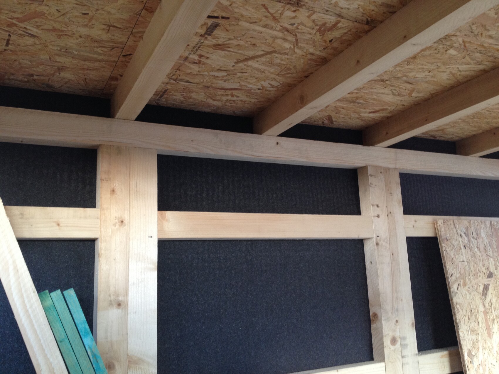

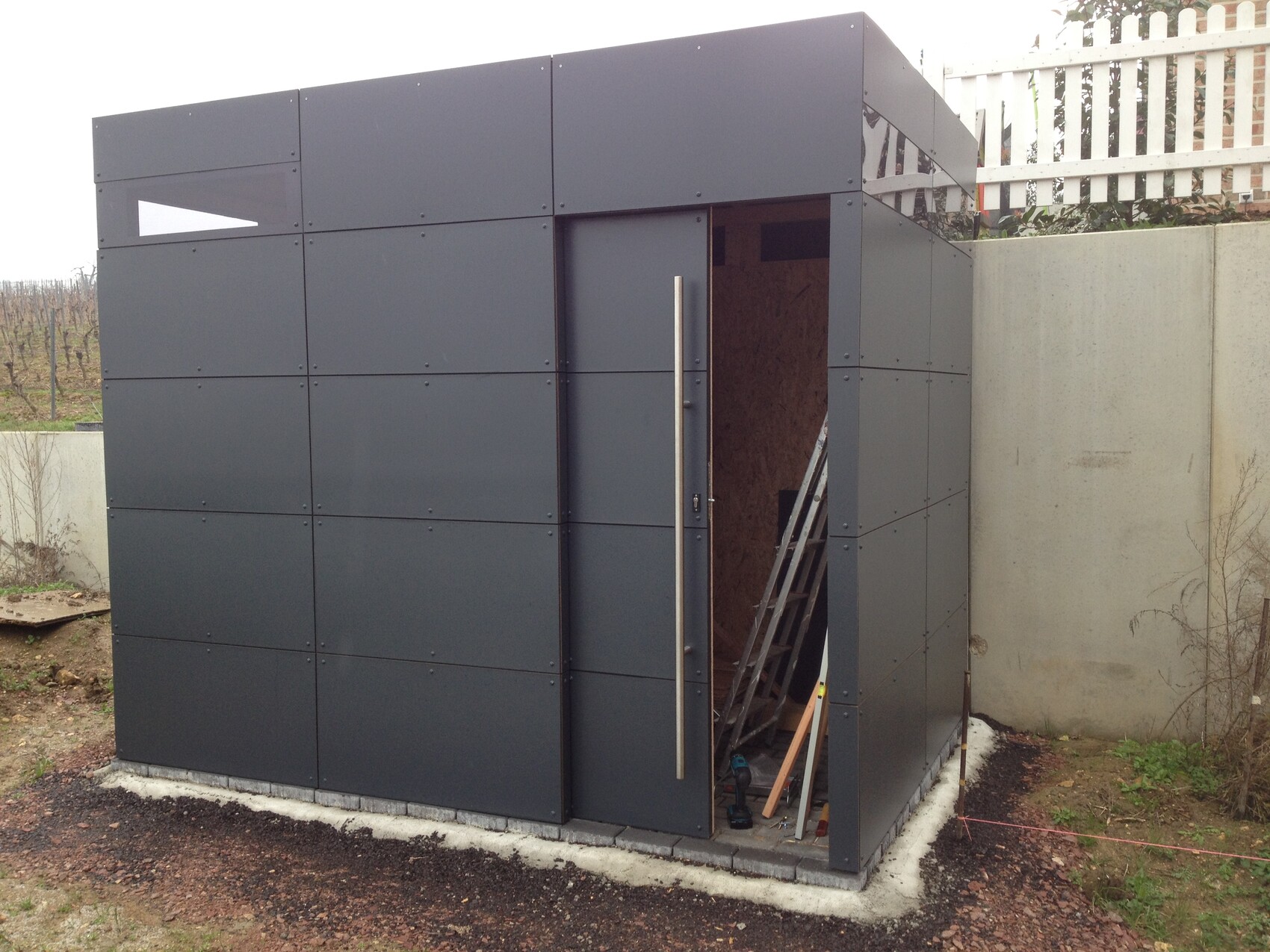

Self-built using affordable 6x8cm (2.4x3.1 inch) spruce beams in a frame construction, topped with 6mm (0.24 inch) HPL panels with a breathable membrane underneath. The roof has a 4-degree slope. The whole structure has been stable for 4 years, standing on gravel and 20x10cm (7.9x3.9 inch) pavers.
Height 2.50m (8.2 ft)
Width 3.00m (9.8 ft)
Depth 2.00m (6.6 ft)
Hans-Maulwurf23 Oct 2019 10:15One00 schrieb:
Self-build using affordable 6x8cm (2.4x3.1 inch) spruce beams in a frame construction, with 6mm (0.24 inch) HPL panels on top and an underlay membrane underneath. Roof pitch is 4 degrees. The whole structure has been stable for 4 years on gravel and 20x10cm (7.9x3.9 inch) paving stones.
Depth 2.00m (6.6 ft) Hello, nice little house, especially the door.
Could you also share some information about the planning process, materials, construction, and possibly the costs involved?
Thank you very much.
