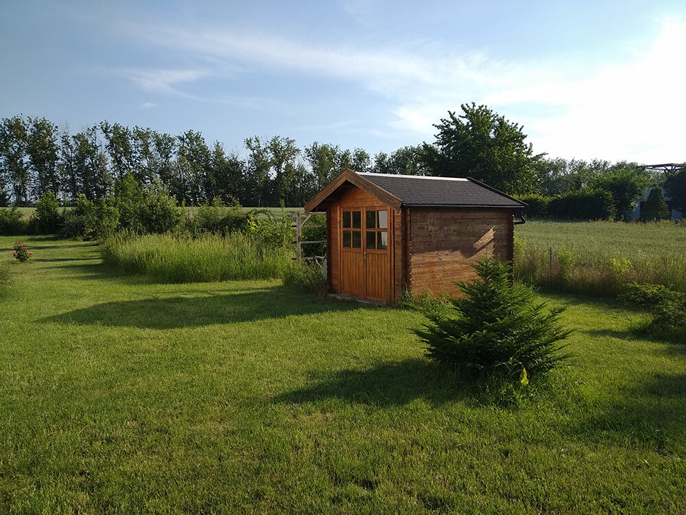

About 10 years ago, we had our garden shed delivered by a specialist retailer. It’s nothing special, but the assembly was very easy and every screw fit perfectly. Moving it to our new home also went quickly. All the boards were clearly labeled. ( )
For the foundation, we used exactly the ground sockets with concrete as you described in your initial post. Steel beams were fitted into these while pouring the concrete. To level the height, we had great experience using sandbags placed under the beams while the concrete set.
On top of the beams, we installed the substructure and then the rest of the shed. This setup is ventilated from below and the shed literally “floats.” Nothing has rotted after 10 years. At the front, we placed small L-shaped stones and installed a grass grid to create a level entrance.

From a distance, the old little shed now looks like this:
As I said, nothing fancy, but everything you need.
In front of it grows my alternative Christmas tree, which of course gets its electricity from the shed during Advent.

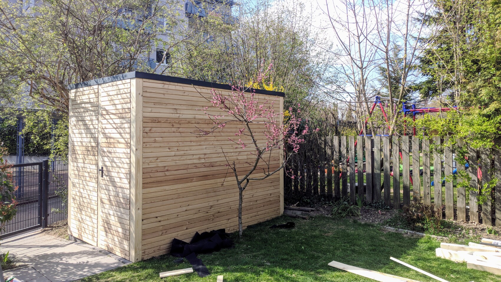

I built it this year together with my father-in-law; it took 4 days. It was entirely self-designed and constructed, with an asymmetrical floor plan. The facade is Siberian larch, the roof is covered with EPDM membrane, and the flashing is powder-coated.
Yes, I initially planned to include windows as well.
My wise father-in-law advised me against it.
In practice, I don’t miss them.
During daylight, enough light comes through the door, and I have proper interior lighting.
Of course, it depends on the intended use—in my case, this is purely a tool shed with a workbench inside; I don’t receive guests there.
A whole side made of glass would definitely turn the place into a serious sauna.
Surprisingly, the shed doesn’t heat up much, despite the black flat roof.
I need to take a closer look; I was thinking about a cantilevered roof and things like that. I have to draw everything up and think it through first, but otherwise, the exterior design is exactly my style. Can you share some details about the structure and construction? I want to use it for garden furniture, tools, and similar items.
