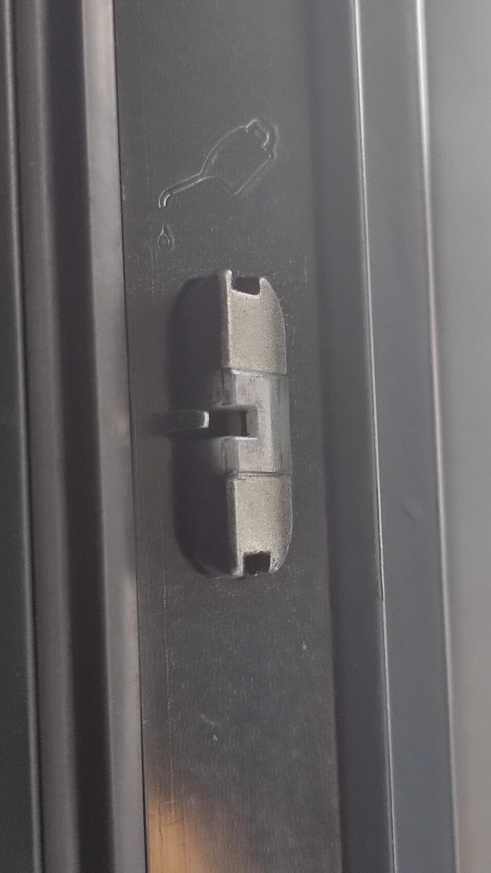

We have a triple locking system, which I think is great. Whether a five-point lock is necessary, I’m not sure, but I believe that if someone breaks in, it’s unlikely to be through the front door since it is always visible from the street.
Here is one of the three latches—I like how simple yet effective it is.
When you press the handle, all three latches retract. Except for the small latch nose; when closing the door, the nose activates the latch and the door is triple locked.
