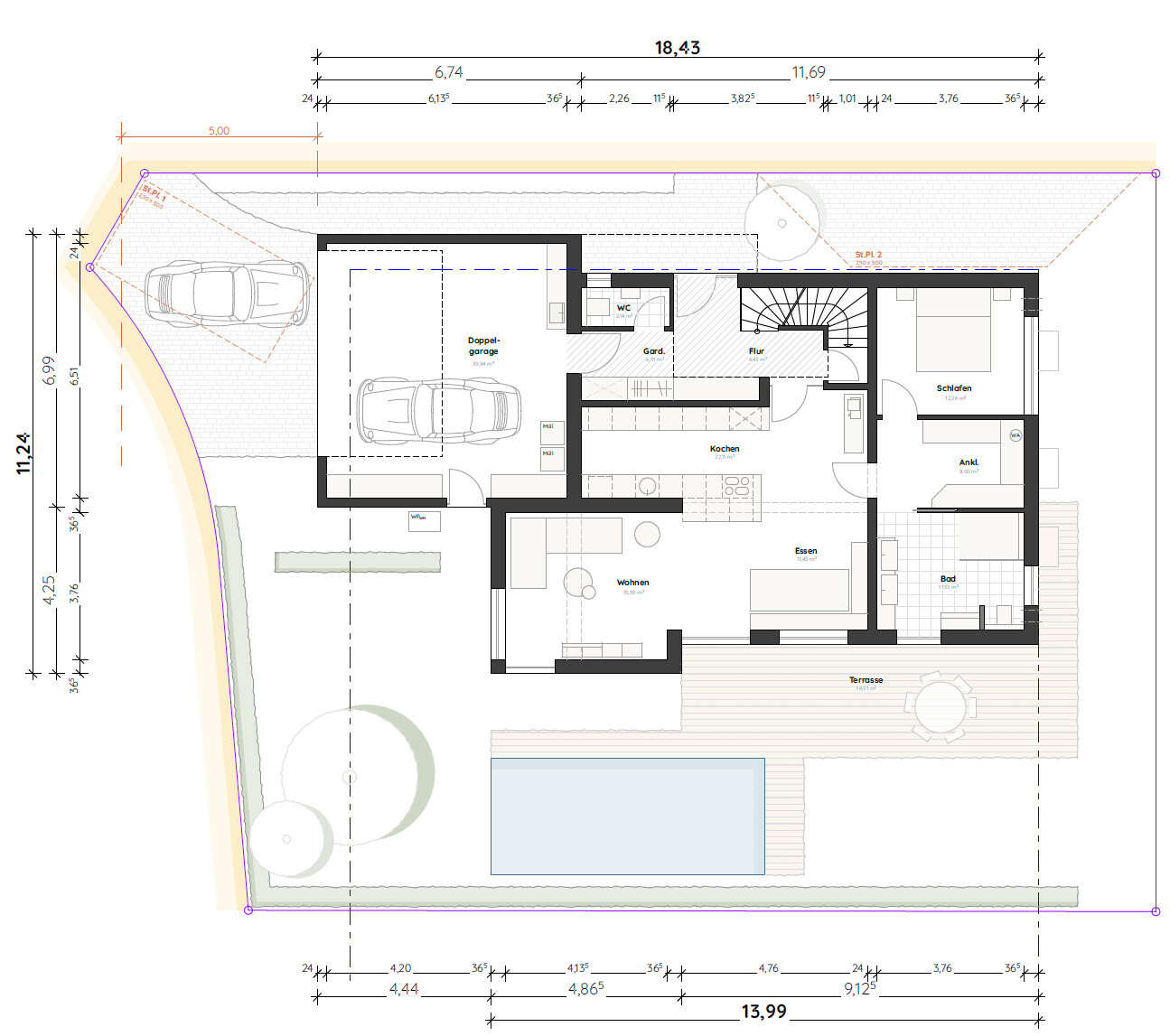

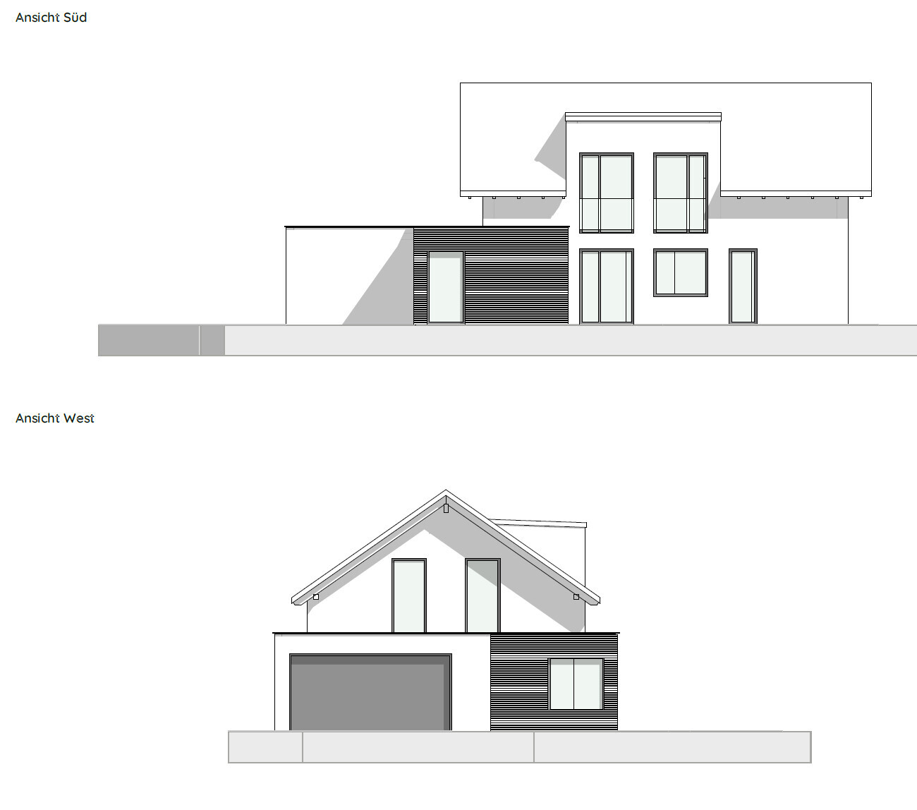

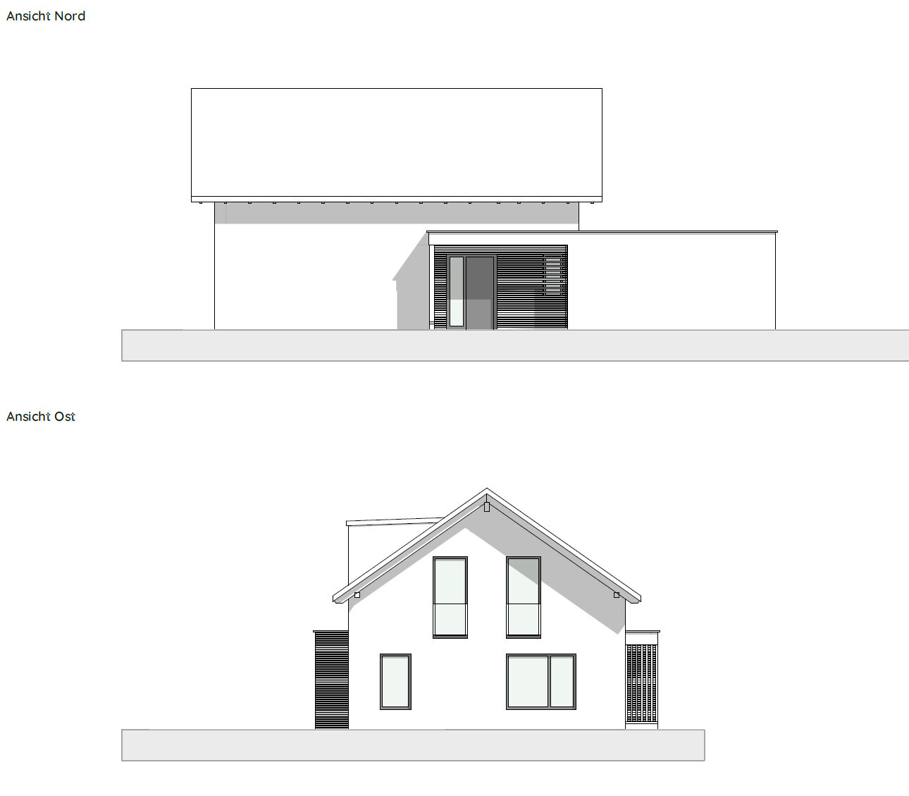

Pfefferfisch15 May 2025 15:22Hello everyone,
in case anyone is still interested in this topic: after many planning rounds, we have now reached this design draft together with our architect, which we like quite a lot.
Just as a reminder, in case anyone asks about the site orientation: our plot is almost exactly aligned to true north, with a very slight slope towards the south.
The basement will be a pure technical floor with laundry, storage, and utility rooms.
The attic floor, with knee walls of 1.40m (4 ft 7 in), will be divided into an office, two potential children’s bedrooms, and an additional bathroom.
We are currently considering whether to install floor-to-ceiling windows throughout the attic floor or only on the south-facing dormer, while using standard windows on the gable ends.

You have clearly spent a long time discussing the design with the architect, so you’ll probably like it just as it is, even though I would do many things differently. Just my two cents:
- Is the garage located outside the building perimeter? Will you get approval for that?
- The paved area seems extremely large to me. Do you have a site coverage ratio of 0.7-0.8? You will probably need that...
- If you place the master bedroom on the ground floor (which is very good for aging in place), then design the door widths to be 0.9-1 meter (3-3.3 feet) wide so that a walker or wheelchair can pass through.
- Floor-to-ceiling windows with external glass protection may look nice at first glance, but in my opinion, they combine all possible disadvantages. They add extra window surfaces to clean, cleaning them is dangerous, they don’t provide more fresh air when ventilating than a normal window, and they reduce usable floor space in the room.
- Best regards, Andreas
Pfefferfisch15 May 2025 16:3611ant schrieb:
I am actually interested in the other two floors as well.Unfortunately, they are not fully planned yet – we are still in the process of "moving walls" 🙂
Unfortunately, the dimensions are not visible. Are the living room and dining room really 15 m² (161 sq ft) each, while the kitchen is 22 m² (237 sq ft), or am I misunderstanding that? If so, the (foyer) area on the other side near the bedroom entrance seems unnecessarily large.
The bathroom, on the other hand, is quite spacious but is cramped between the sink and the door. This apparently requires an expensive and less comfortable sliding door, which I would not prefer.
I would rather reconsider the pool and allocate a bit more space to the open-plan area, similar to the kitchen zone, even if it’s not strictly necessary.
Overall, I can imagine it looking very stylish if furnished sparsely and simply, but the generous kitchen and transition area contrasts with the relatively small living and dining rooms. It feels like the design runs out of space somewhere, which is also reflected in the sliding door, the bedroom door opening outward, the narrow bathroom access, and the door sizes that @andimann rightly pointed out.
By the way, how did you arrive at the 18 m² (194 sq ft) terrace measurement?
If you are looking for constructive and critical feedback, it would help to provide the dimensions, including those of the actual furniture.
