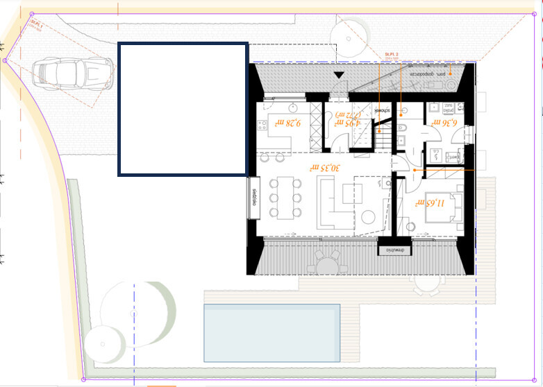

You are absolutely right that a basement is a luxury, but it did not result from a mistake by the architect; it was a fixed requirement from us. We want a laundry room, storage, and technical rooms in the basement and do not want to use ground floor or upper floor space for that.
There is also no difference in elevation: the entire building plot will be leveled to the height of the northern boundary using a retaining wall on the south side, making it flat. A design mistake remains a mistake, even if requested. Thank you for pointing out a gap in my series of posts about the 11ant basement rule: so far it has only addressed the economic disadvantage of the “terrain modeling instead of basement” strategy — the variant “basement plus terrain modeling” is a whole other level of cringe. Congratulations on the budget if you can afford this double luxury.

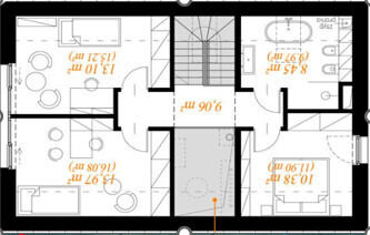

For us, it contains “only” an office, two possible children’s rooms, and a bathroom, spread over more than enough space.
We consider the living area and private rooms on the ground floor to be far more important. This has nothing to do with a sentimental attachment to the floors, but simply with the gravity pulling on walls and wastewater on one hand, and with the understanding that it is easier to derive the less complex from the more complex on the other. From both follows the strong recommendation for the sequence “room program > refinement of the room program > distribution of the room program across floors > drawing the more complex floor > deriving the less complex floor from the more complex one.” Traditionally, the upper floor serves as the master and the ground floor as the slave level. On a slope, with the reversal of “living upstairs, sleeping downstairs,” the basement is more complex, while the gravity situation is dominated by the rising slope. Here, the upper floor’s priority is accordingly reversed.

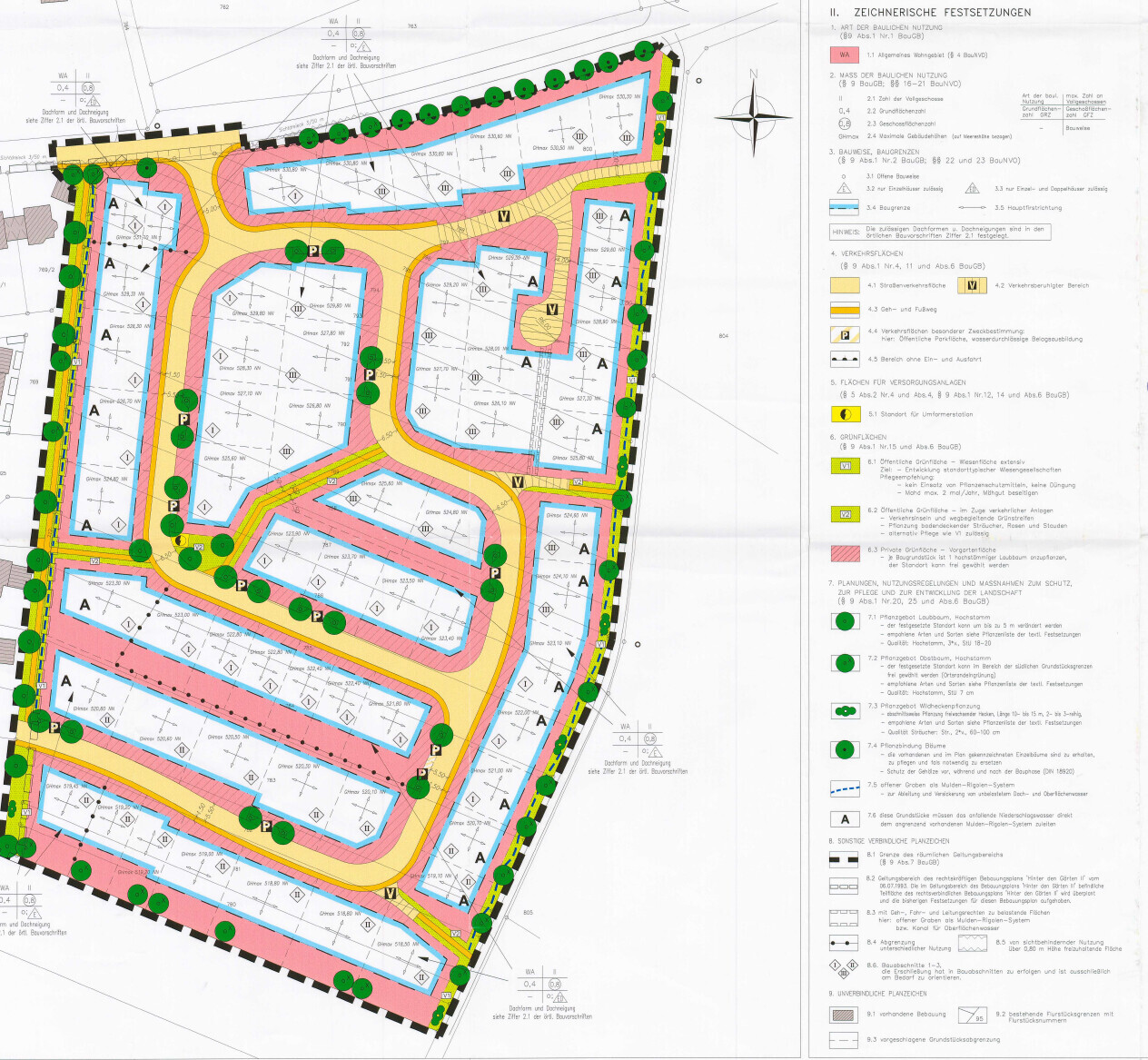

Attached is the development plan Thanks, but unfortunately it’s very blurry on my phone. That’s not your problem.

After many planning rounds, we have now arrived at this design proposal together with our architect, which we quite like. For you, this may be the optimum, but for me the design is flawed in several areas by now, as I said.
I don’t see a final design here, but rather initial approaches with mistakes that should be addressed in planning. If for you no Plan B involving the double garage is an option, then I would at least set different priorities. For example, when I read that there is farmland and fields to the east, I would orient the garden and dormer windows towards the east. Possibly—or very likely—also rotate the roof to allow for other, potentially better options. I would also plan the attic much smaller, if necessary, choose a shorter knee wall for a 27° roof pitch or reduce the interior height.
The important thing is that it suits you. I don’t need to invest any more mental effort into it then.
Somehow, the three-story design doesn’t really suit a potential physical disability.
The whole plan suffers because the ground floor is overloaded with two bathrooms, a bedroom, and a walk-in closet, while the other floors remain mostly unused. Although having a bed on the ground floor might be useful in some cases, what good is a hobby room or office on the upper floor if you can’t access those rooms?
Why not already include a possible lift serving all floors in the planning stage and instead choose a wheelchair-accessible “standard layout” for the house?
