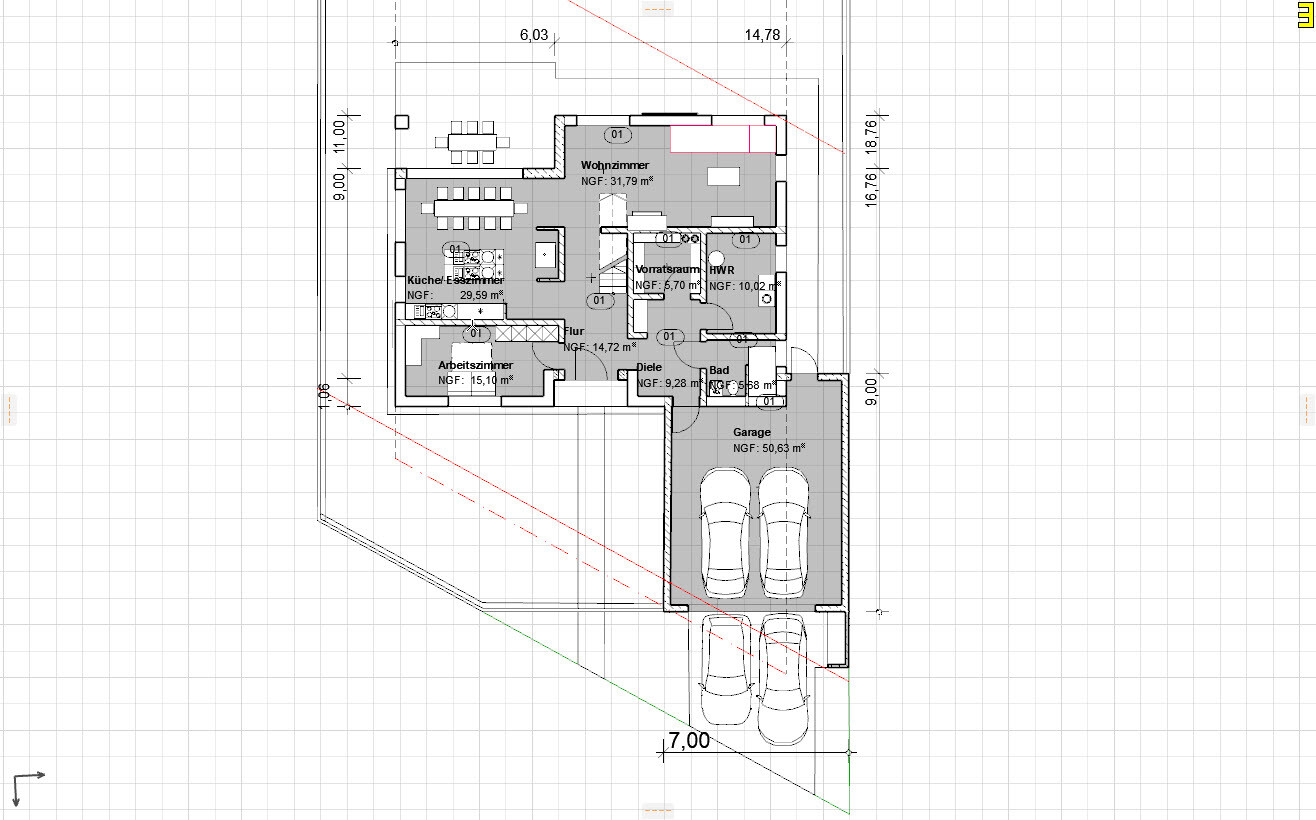

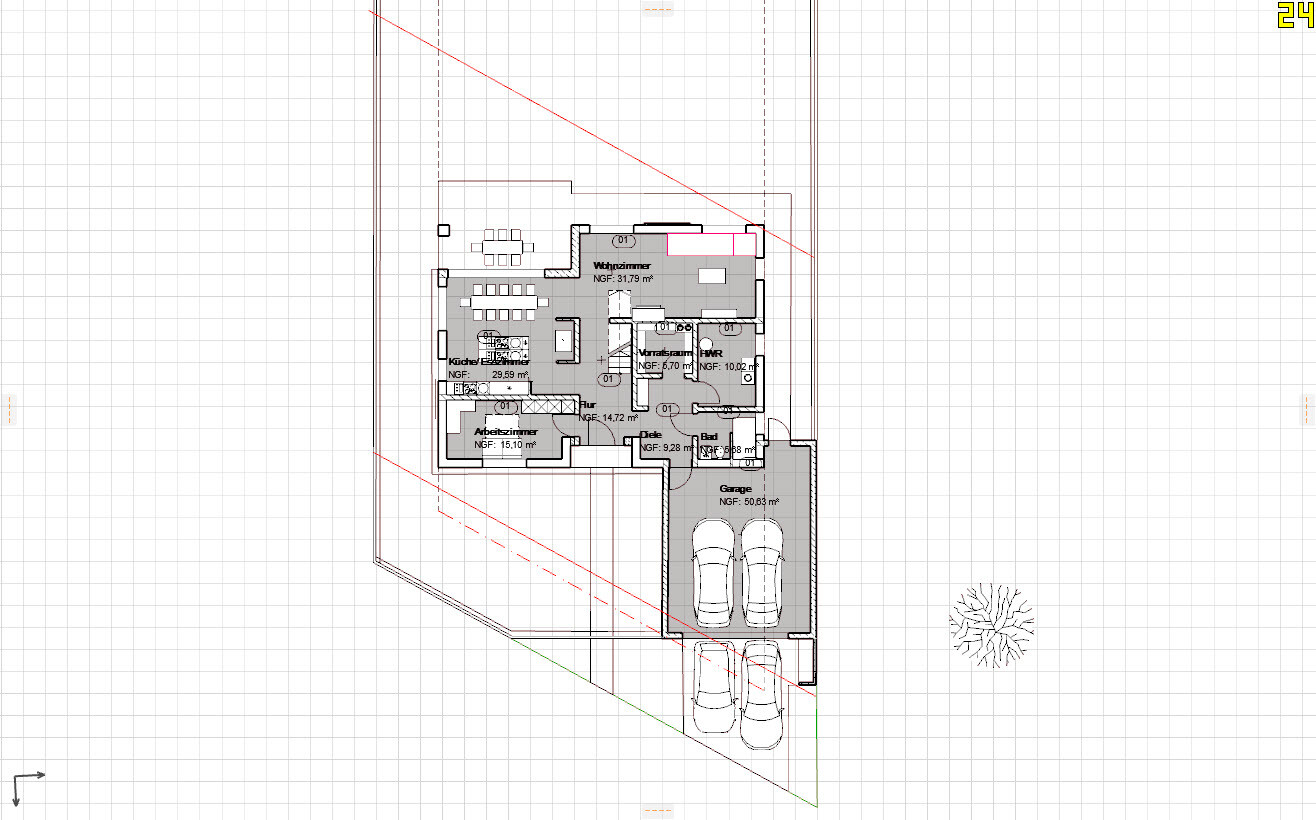

- View from front with entrance
- Garage integration to minimize required space!
- How close can the garage be set to the street?

- So far, I am very satisfied with the plan. It’s basically everything we imagined. But I’d like to hear opinions—maybe we have rose-colored glasses on.
- Maybe you have ideas regarding the entrance and garage driveway.
- Before I take the next steps, I’d like to know if this exceeds our price limit?

Hello, as the first child, I wouldn’t be very happy. Do you need the balcony? Otherwise, I would place the master bedroom upstairs and give the children’s room more depth. Access to the master area through the walk-in closet. On the ground floor, I find the right side a bit too convoluted.

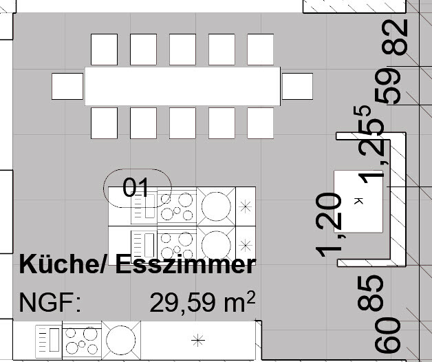

Nice-Nofret15 Sep 2020 19:23If one square is meant to represent 1 meter (3.3 feet), then the kitchen and dining area is designed too narrow.
Walkways should not be less than 1 meter (3.3 feet); from the edge of the dining table to walls or the kitchen island, a distance of 1 meter (3.3 feet) should also be planned.
