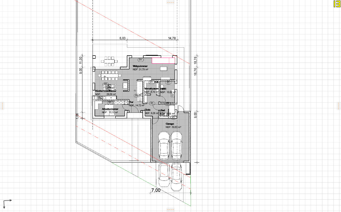

We are about to purchase a plot of land (870m2 (9,375 sq ft)) and are currently designing our “dream house.”
I hope this information is sufficient; otherwise, I’m happy to provide more as mentioned.

We adapted a prefabricated house to fit our wishes.

- View from front with entrance
- Garage integration to minimize required space!
- How close can the garage be set to the street?
- So far, I am very satisfied with the plan. It’s basically everything we imagined. But I’d like to hear opinions—maybe we have rose-colored glasses on.
- Maybe you have ideas regarding the entrance and garage driveway.
- Before I take the next steps, I’d like to know if this exceeds our price limit?

Nice-Nofret15 Sep 2020 19:46Do you already have the refectory table with a depth of 59cm (23 inches)? You can barely sit opposite each other comfortably at that size. Well, it’s all a matter of personal taste.
Tell us, which prefabricated house was the basis. I suspect an error in the use of the design software caused the staircase to be shifted by about half a dozen steps (?)
You have taken the "Meisterstück Cubushaus" design quite freely—one might even say you have reduced it to inspiration. Unfortunately, this resulted in a strong compression of the room axes parallel to the building axis in order to stay within the building plot. In my view, this could have been better achieved by angling the building, that is, rotating it about ten to fifteen degrees clockwise (for the house, and slightly less for the garage). Since the building plot is already such an irregular parallelogram, you could especially do the discussion a favor by orienting the plans to true north.
I don’t understand the plan (and there are probably others here who don’t either).
Is one box supposed to represent one meter (3.3 feet)? What kind of dining table is supposed to be that size? There’s some grumbling, but no real interest in clarification or improvement.
