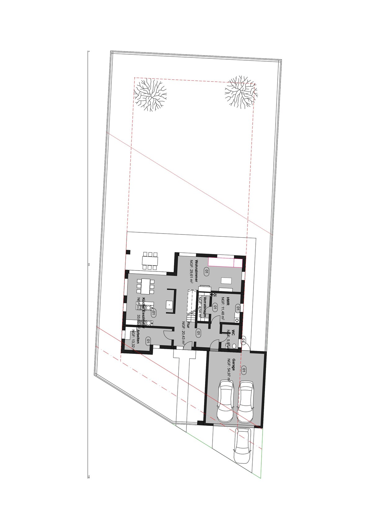

To me, it also looks like the floor plan lacks sufficient depth, causing all the rooms to feel a bit narrow—for example, the kitchen/dining and living areas. The bay window at the top right makes this issue worse; I think this floor plan shape doesn’t fit optimally within the building envelope. I would remove the bay window and straighten the upper facade. This way, the kitchen/dining area gains more depth, and the living area less, but you simplify that complicated layout of the cloakroom, pantry, utility room, and guest bathroom. There’s definitely potential to save a lot of space here and add it to the living room.
A bay window at the top left would naturally fit the building envelope perfectly, but that would block the southwest sunlight—so that doesn’t work either.
On the right side, you have not maintained the three-meter (10 feet) setback from the boundary. Is this intentional or an oversight? If the latter, you would need to make the house narrower.

neo-sciliar17 Sep 2020 09:55Hi, with 290 sqm (3120 sq ft), it should be possible to arrange the rooms more efficiently, right? Why have a corner in the dining room that takes up space needed for the depth of the dining table? And why have a pantry if it feels like it’s a day’s walk away from the kitchen?
I created a table to see the percentage distribution of floor area between bedrooms, living areas, and utility rooms. I want at least 30% allocated to kitchen/living room/dining room. That wouldn’t seem balanced enough in your plan.
When the front door opens in winter and the tea drinkers say goodbye to their friend there, the whole house gets cold. I don’t like that. Also, everyone in the house can hear when the children’s friend tries to sneak out.
Such floor plans are great. But are they really comfortable to live in?

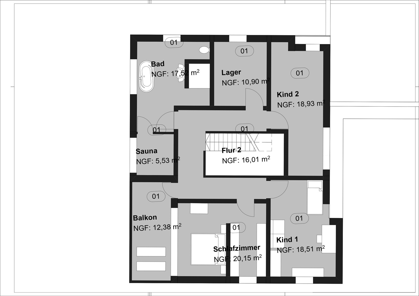

... a very interesting design. I see a high level of maturity. The skylights, in particular, would work very well in practice.
The exterior appearance also seems very consistent. As always, there are personal critiques regarding details. For me, these would be:
- the living room is too narrow and elongated
- the second children's bedroom is clearly too narrow and elongated
- several doors on the ground floor/upper floor are squeezed too close to the corners
- the entrance area is too small compared to the overall impressive size
- the ground floor at the lower right is too complicated in layout
First of all, thank you for the feedback. I will try to address some of the valid criticism on Saturday.
- The clearance on the left (0.3m (1 foot)) and right (0.3m (1 foot)) was not maintained (which ideally should not happen)
- I also find Nursery 1 not ideal. I still need ideas for that. Possibly remove the balcony upstairs
Regards, Florian
Regards, Florian

erfurter11028723 Sep 2020 19:28Here is an opinion and a question for the future cook:
Do you want to walk through the hallway/entrance to the pantry every time before or during cooking? I would always place the pantry next to the kitchen to keep the walking distances as short as possible while cooking.
