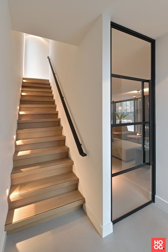

Almost all of your points are valid and we have noticed them too. Sometimes we just had to accept compromises. The door to the office is actually on the right side, since we plan to have a door leading to the living room as well:
Modern wooden staircase on the left with black railing, glass door on the right, view into the living room.
What exactly do you mean by the access to the private rooms? We couldn’t work it out any other way.
Chimney: Are you asking because the chimney exits on the eaves side and might not look great there? The architect doesn’t see any aesthetic issues. However, we do worry that in reality it might not look as good… We can’t think of another solution, or we would have to do without the fireplace altogether. For a chimney on the gable end, we could place it on the guest room wall and rotate the living room accordingly. The downside: the fireplace would only distribute warmth within the living room, which is not ideal either. Maybe you have some ideas?

because we are planning a door to the living room:
A door or an access point combined with the living room entrance is, for me, one aspect that changes the house from “cool” to “living room access could be better and I would change it somehow.” The good part lies in the execution of the planning, the bad part in the planning itself or lack of planning.
This also applies to the staircase: I didn’t see that it will be a closed staircase. Another minus in my opinion. However, this somewhat compensates the basement access.
But it’s not my house anyway. If you like it…

Another sensitive point you bring up. The idea with the loft door is to preserve privacy in the living room (not every delivery person should be able to look directly inside) while still keeping the open feel. But I can well imagine that once the shell is finished, we might be so impressed by the “awesome” space that the loft door will be dropped 😉
Due to structural requirements, a closed staircase is necessary. If you look closely, there are load-bearing columns along the staircase.
Although it’s labeled as a roof terrace, it won’t actually be one. It will be a normal flat roof without access. Access will only be available to the balcony from the hallway or from the master bedroom. That should be fine.
