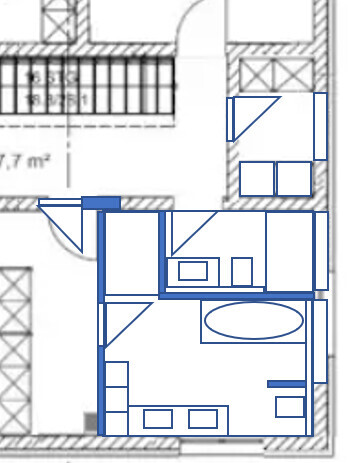

Stein202311 May 2023 15:48hanghaus2023 schrieb:
This is how I quickly planned it. It can definitely be done more efficiently and with fewer tiles on the walls. In the children’s bathroom, a skylight with a sill height of 2.00m (6 ft 7 in). The windows still need to be optimized.
Thank you for your input. Please take a look at our post #56: Originally, we had planned a children’s bathroom, which was the larger one because we wanted to do the laundry there. Currently, we have planned one larger bathroom for everyone, with access from the bedroom, and an additional shower in the guest WC on the ground floor.
hanghaus202311 May 2023 18:27I would not like that in post #56.
