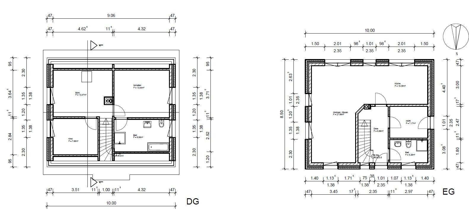

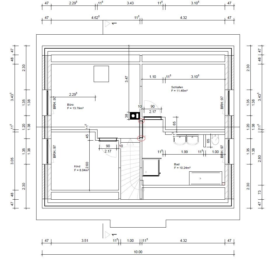

The building is planned without a basement, directly on a slab foundation. I have attached the floor plan as submitted to the building authority (zwischenablage01) and the current layout with the irregularly shaped rooms (zwischenablage02). In the latter, the staircase is steeper. On the originally planned floor plan, I have marked the actual position of the chimney with a pen. This makes it clear that the planned door to the bedroom can no longer be realized. In the irregular layout, I have already sketched in some furniture to help us get more comfortable with the design, but it still doesn’t work properly.

Clipboard 1 was planned and is also acceptable from your side.
Clipboard 2 shows the status on the upper floor – where is the fireplace located on the ground floor?

Do I understand correctly that the child always needs to pass through the bedroom to get to the bathroom, or do you not have a child?
