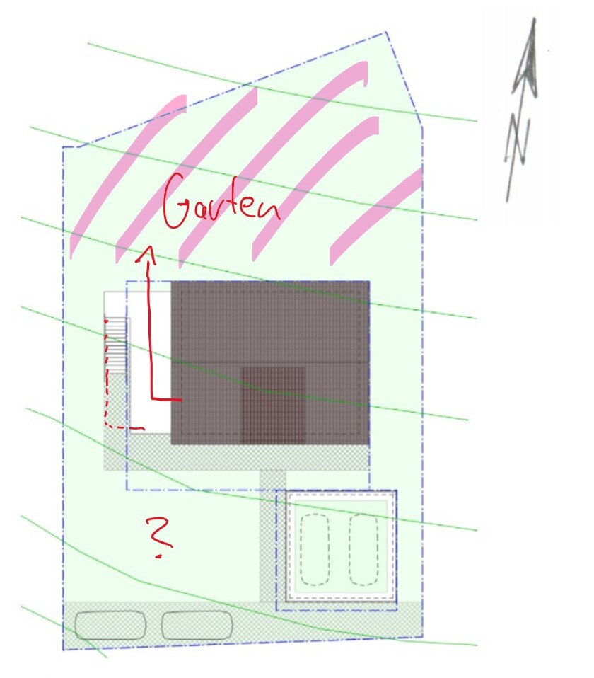

Let me put it this way. Your versions didn’t have any access to the garden. It wasn’t usable either. The option only uses the existing soil masses to level the terrain. The retaining wall also serves as a boundary wall to the neighbor and to the leveled area.
Yes, the carport roof and the platform are supposed to be on the same level.
Is the retaining wall allowed to be on the boundary and that close to the street?
Depending on the budget, you can extend the retaining wall further into the slope (partial basement for the heating system, etc.). (In Bavaria, it may be allowed up to 9 m (30 feet) on the boundary.) Unfortunately, I’m not familiar with the regulations in Baden-Württemberg.
jerimata schrieb:
It may be that the basement rule refers to a comparison between a slab foundation and an uninsulated basement (is that the case?), No, the 11ant basement rule compares the cost of a constructed basement with that of a basement "avoided" at all costs against the “will” of the plot, and it actually applies already to a utility basement (cold cellar). Whether the thermal envelope boundary is the ground or a cold cellar should not significantly affect the calculation – the insulation required for both options is quite similar.
gutentag schrieb:
I'll put it this way: your options didn’t have any access to the garden. I think the problem is also the statement or lack of imagination about how the terrace is used. That's how it was read, right?
@jerimata
When the weather is nice, people usually stay indoors only as little as necessary. The terrace becomes an extension of the living area for everything. Even the kitchen activities move outside for preparation. And when the grill is fired up, cooking happens outdoors as well. Many no longer cook inside at all, even grilling through the winter months. From October to Easter, the terrace is used as a large refrigerator. Starting in March, it’s used for potting and planting. In summer, the bicycle might rest there occasionally. Some people hardly do anything indoors anymore because the terrace is the ultimate place to relax at home. And outside, between Easter and October, there’s always something to do in the garden; the terrace serves as the starting and ending point for that. Why sit indoors when it’s above 21°C (70°F)? Indoor sofas gather dust until sunset. The trend is already moving towards having a third or fourth terrace 😉
Thank you @ypg, as someone currently living in a rental apartment, it’s really helpful to hear your explanations – many things are not even on my radar yet, and it’s easy to underestimate what new possibilities will open up once they become available.
However, I’m still unclear about the following statement:
Of course, the area in the south shouldn’t be completely wasted, but parking spaces, street, and low height made it less appealing to plant a productive garden there..
gutentag schrieb:What exactly does that mean, or what is the qualitative difference compared to your proposal? A direct door to the backyard would be great, but it feels like a luxury if you can access it via the terrace anyway (which might be used for gardening tasks). I wasn’t thinking of a heavily used garden in the south, but really consistently behind the house (as drawn – maybe even shifting the house forward within the building envelope to have a larger continuous garden in the north). Ideally without heavily terracing the slope, but rather creating several raised-bed-like areas… but all that is still quite open. A classic, flat lawn area is not what I want; I prefer a more "natural" and productive space – where I’d place a lounge chair to relax rather than a decorative garden.
Your options had no access to the garden at all. It wasn’t usable either.
gutentag schrieb:
Is it allowed for the CP to be right on the property line and that close to the road? The CP window is set on the dashed line in the plan – but maybe it will have to be a garage, since at the front of the plot (south side), a significant embankment (2–3 m (6.5–10 feet) high) has formed due to deeper road construction, which was not reflected in the terrain lines.
gutentag schrieb:
Depending on your budget, you could extend the CP further into the slope (partial basement for utility rooms, etc.). (In Bavaria, it may be allowed up to 9 m (30 feet) at the property line.) Unfortunately, I’m not familiar with Baden-Württemberg regulations. I think the bigger issue might be building a terrace (the gray area on the left) directly on the neighbor’s boundary. Also, retaining walls, fences, or hedges along the edge are generally not allowed to exceed 1.20 m (4 feet) in height.
I think the problem is also the statement or lack of clear idea about how the terrace will be used. YMMD
jerimata schrieb:
The CP window is fixed at the dashed line on the plan... Who decided that? The local authority? Is that really a fixed area for the parking spaces? The building envelope for the house also looks extremely limited on your plan. Is that really accurate? If so, this kind of information should be included in post #1 of the thread and highlighted separately, since it would be quite unusual. So far, this is all very confusing. I’ll step out until there is more clarity.
