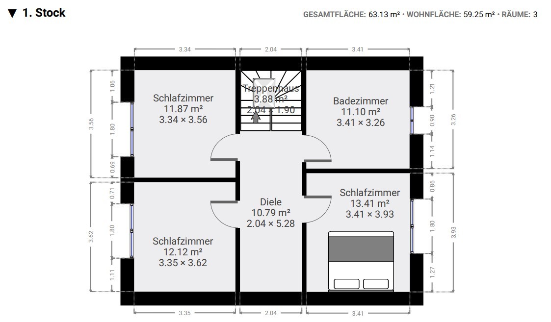

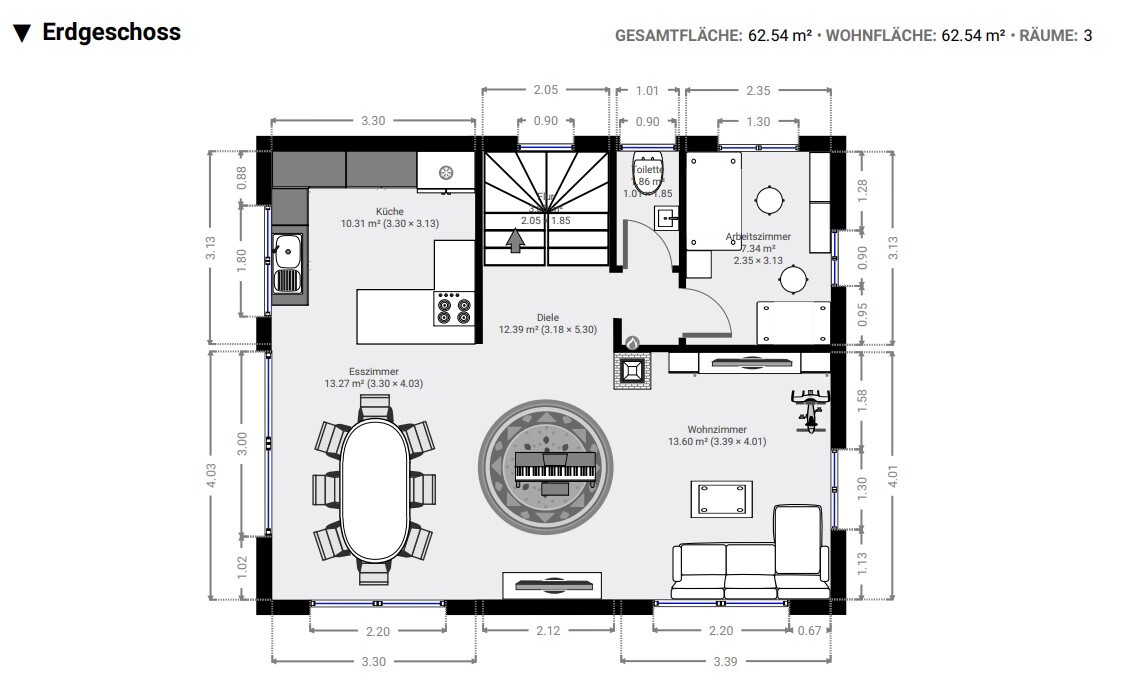

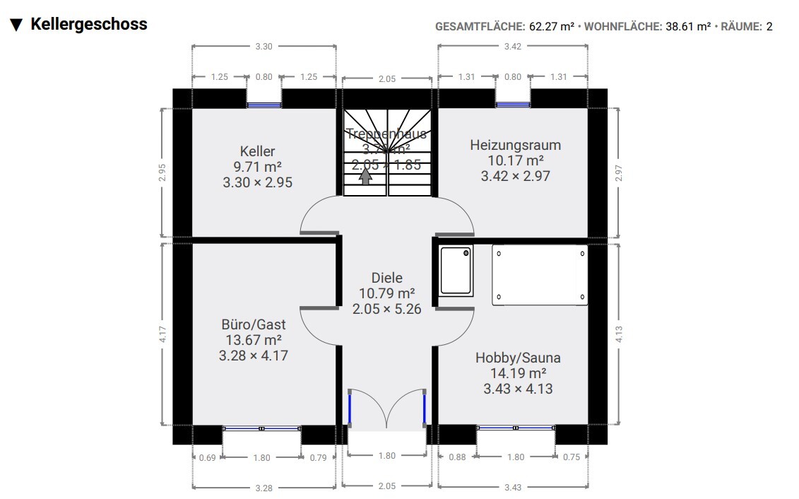

Here is the current floor plan. The entrance is as usual in the basement, centered, with south at the bottom.
Guest toilet now without a shower, since we are planning a second one in the sauna room anyway. The ground floor office has been slightly deprioritized in favor of more living space. Furniture is, of course, only exemplary and incomplete.
Floor plan of the 1st floor: central hallway, three bedrooms, bathroom, and staircase.
Floor plan of the ground floor with kitchen, dining room, hallway, living room, office, and staircase.
Floor plan of the basement: hallway in the center; rooms include basement storage, office/guest room, hobby/sauna, and boiler room.
11ant2 Apr 2022 19:25
jerimata schrieb:
"Smaller models" sounds a lot like tract housing again, doesn’t it?
Yes, of course. A catalog home is definitely preferable to a tailor-made individual design by a draftsman (it doesn’t help much if the client has already done some creative work beforehand).
jerimata schrieb:
Of course the architect working with the shell builder takes care of the entire tendering process,
I already quoted Albert Borland this week: "I don’t think so, Tim!" 🙂
A piano, a piano! (Would you like to add a zigzag wall as well?)
I expected more from a partly below-grade basement than just fitting the entrance, guest room, and sauna there.
