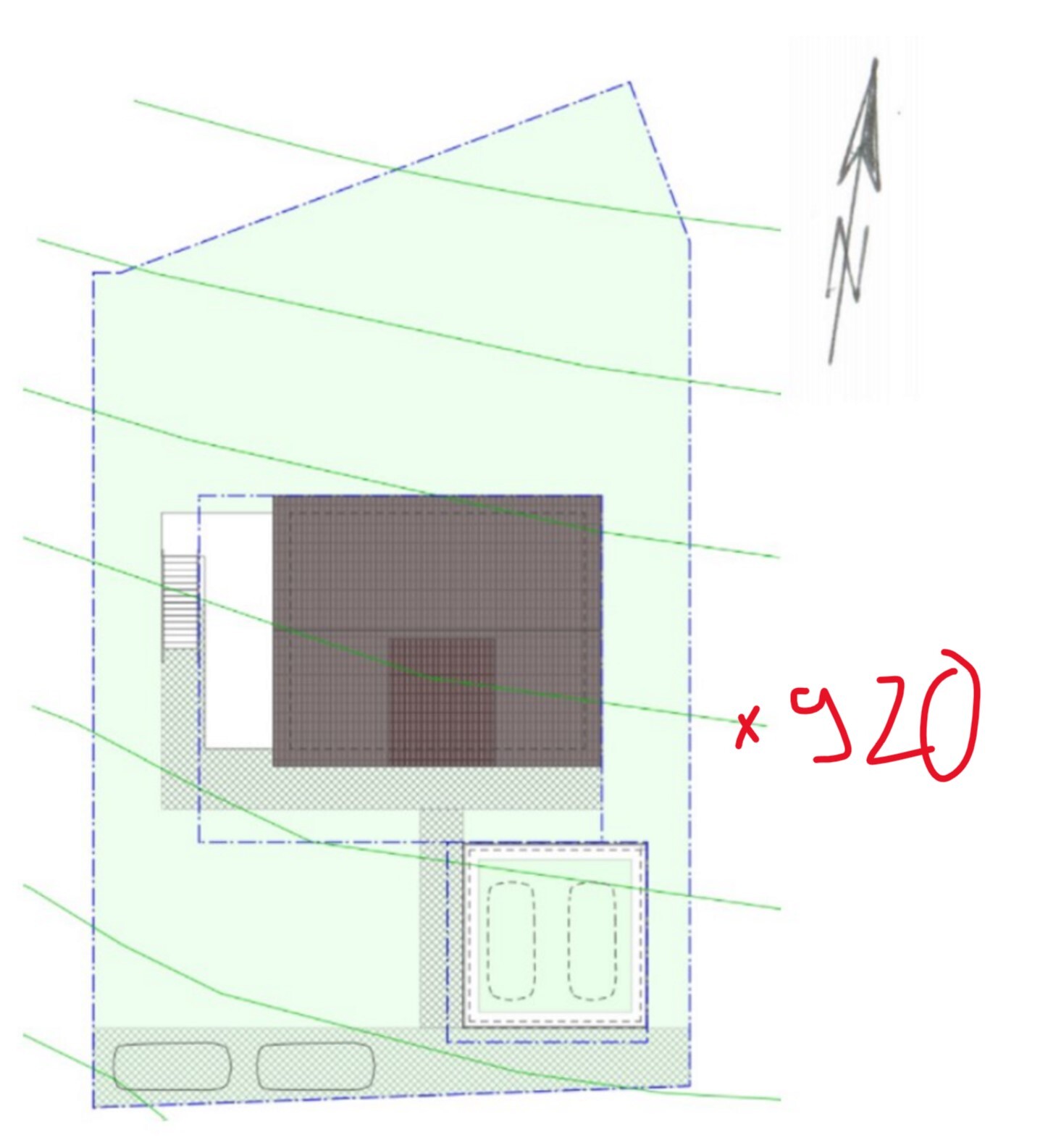

Plot size – 680 sqm (7319 sq ft)
Slope – hillside location, approximately 1.5-2 m (5-6.5 ft) incline within the building envelope
Site coverage ratio – 0.3
Floor area ratio – 0.6
Building envelope, building line and boundary – see image

Let me ask differently. Regarding the finished floor level, @11ant has already replied. Is there a development plan / zoning plan? What does it specify about heights? Reference points, etc.?
I already mentioned the planned finished floor levels above. For the ground floor finished floor height, the development plan specifies a range of 920.5 to 921.1 meters (3014.4 to 3017.7 feet). I have marked the 920-meter (295 feet) line in the floor plan. Otherwise, there is an 8.60-meter (28.2 feet) ridge height and a 3.6-meter (11.8 feet) eaves height (the latter is regularly exempted, which we are also aiming for to achieve better energy efficiency).

Well, we did consider this, but regarding the cellar rule, it was pretty clear to us: it costs about the same as a slab foundation without any real added value. Due to the fixed finished floor height on the ground floor, you would first need to create terrain (good: excavation can be reused; bad: it then has to be secured accordingly with stilts or retaining walls—this costs a lot for no real gain). Assuming you lower the finished floor, the old cellar would simply become the new living space—obviously possible but deliberately reducing height on a slope is counterproductive. However, I am open to better solutions; maybe I just don’t know them yet.

To be honest, I find the initial thread more confusing than informative. The street is to the south, the land rises to the north… but none of this fits the floor plans in my opinion, and I couldn’t make sense of it. I even considered whether the plans referred to basement, ground floor, and top floor, or just lower ground floor and upper floor. I don’t mind sharing a typical house floor plan here, but posting three plans with confusing and unclear entrances is a bit much for me. Then there’s the promising initial situation—being allowed to build an open lower ground floor facing south—which is ruined by symmetry and the main entrance placed between two basement rooms.

To put it differently: It’s not about the exact details. It’s clear that somewhere in the northwest (top left) the “less important” spaces like guest toilet, potential pantry, and possible exit to the north garden should be located.
No, why?! Nothing is obvious here. Maybe that will emerge at the very end of planning, but I would explore every possibility.
jerimata schrieb:
Since the entrance is supposed to be in the lower ground floor (basement), any entrance facing the street would block valuable southern exposure – so catalog designs were deliberately chosen where both stairs and entrance are on the north side – basically, with free planning it would probably be a similar variant, but for cost reasons the exit to the north would then be omitted.
There are options:
- Place the entrance on the east side of the lower ground floor.
- Place the entrance on the east side of the ground floor.
- Arrange the open living area in the lower ground floor with a great terrace facing south and give the children the wonderful southern view on the ground floor. Meanwhile, have the parents’ area facing the garden.
- Arrange the living area, as you plan, on the ground floor spanning the south and west sides. However, I would not make the mistake of cluttering the south side of the lower ground floor with utility rooms.
You can nicely separate the entrance and terraces with hedges, planting, or a low wall to create privacy. I assume a double garage is unlikely due to budget constraints. If you explore all possibilities and consider them, you might even manage with only two stories. The roof could be open inside or a staggered shed roof, which would help bring southern sunlight into the northern rooms. So, if you trust the lower ground floor to be more than just a hallway with utility or at most

Here is the current floor plan. Entrance as usual centrally in the basement, south is at the bottom.
jerimata schrieb:
May I ask what you mean by that? Our basement is also supposed to contain living spaces – we have a wall open to the south –
…you ruin it with a sauna, which should be a private space not located on the street side and can get by without a southern exposure—if necessary, just with a basement window.
In principle, I find your living and sleeping areas on the ground and top floors quite good, except for the fact that in the “living” area you basically get no connection to the plot at all. The only connection is in the “back left,” unfortunately without a patio door and with furniture along the wall. I would rather consider creating the open living space with kitchen and entrance in the lower ground floor, then have the utility room, storage room with sauna, children’s room, and family bathroom on the ground floor facing the garden, and put the parents’ bedrooms and office in the attic.
