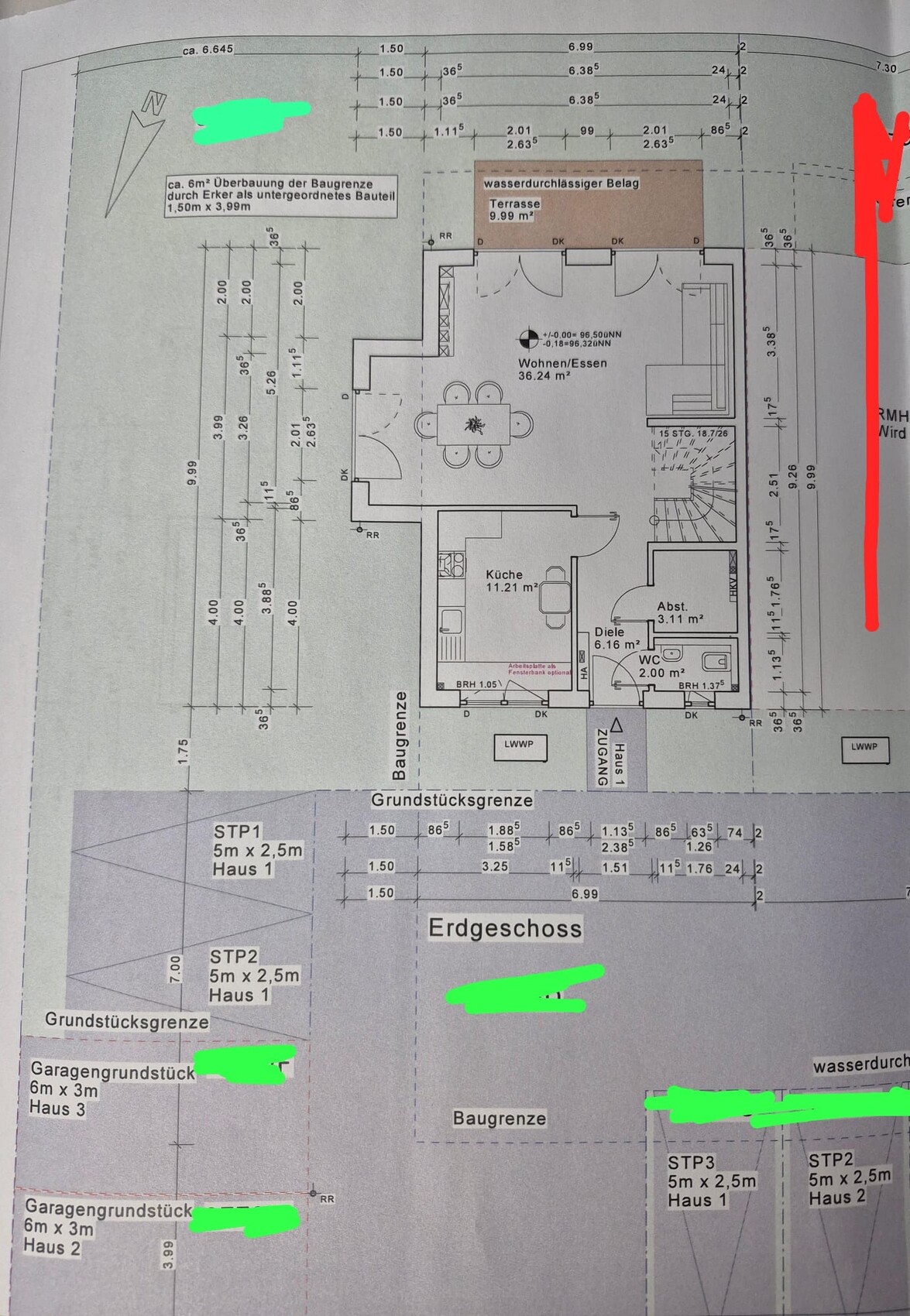

So, I’m sharing a sketch now. You will see that I don’t want to pave much compared to the size of my plot, but the problem lies elsewhere.
I’m uploading a sketch here. The terrace in front measures 7 × 4 m (23 × 13 ft), and at the bay window, it’s 4 × 3 m (13 × 10 ft). The plot, including the shares of the communal area, is 452 m² (4,864 ft²) in total. If you calculate the floor area ratio based on the entire plot, I have plenty of space for everything I want. However, there is a building boundary line that I have crossed with the bay window (with approval). Regardless of the floor area ratio, you are not allowed to build a terrace beyond this boundary, right? That’s why I think I need to submit an inquiry to the building authorities.
Grundrissplan eines Hauses mit Wohn- und Essbereich sowie Küche im Erdgeschoss.

The problem I have at the moment is that the building authority doesn’t provide clear information and just brushes me off on the phone. However, I know that they will later conduct inspections and require demolition if things aren’t done properly. I want to do everything correctly.
A front terrace of 28m2 (301ft2) and one on the bay window of 12m2 (129ft2), connected around the house, would total 65m2 (700ft2). It’s not small, but not huge either. The only problem is that I need permission if it goes beyond the building boundary. There’s another issue: in my documents, the floor space index (FSI) is calculated twice — once with the total area and once with the area within the building envelope. The zoning plan doesn’t mention anything about this. Including the house, bay window, parking spaces, and a 10m2 (108ft2) terrace, I was below the limit with both calculations... Now it’s important to know which one applies for the floor space index.
The total area or the area inside the building envelope. This determines how much I am actually allowed to build.
