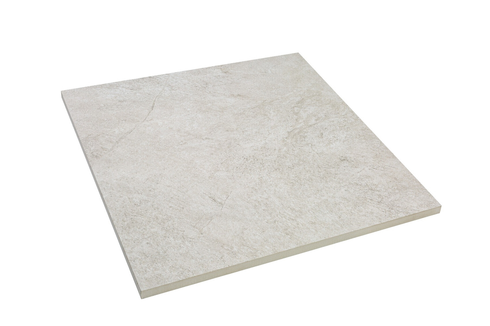

Today, I looked at these:
They look good in pictures, but in person, I sometimes found them a bit too light. What I’m looking for is a light tile with subtle anthracite/beige patterns, so that an anthracite border looks nice and I can place dark furniture on the light floor.
Of course, it’s a matter of taste, but I’m curious what you think about my plan. It should not be too bright, or the floor will be glaring. Unfortunately, I can’t find suitable options from Villeroy & Boch online. It’s very exhausting; I would prefer to go to a building supply store and take a look, but they only ever have one or two tiles available, if any at all.
