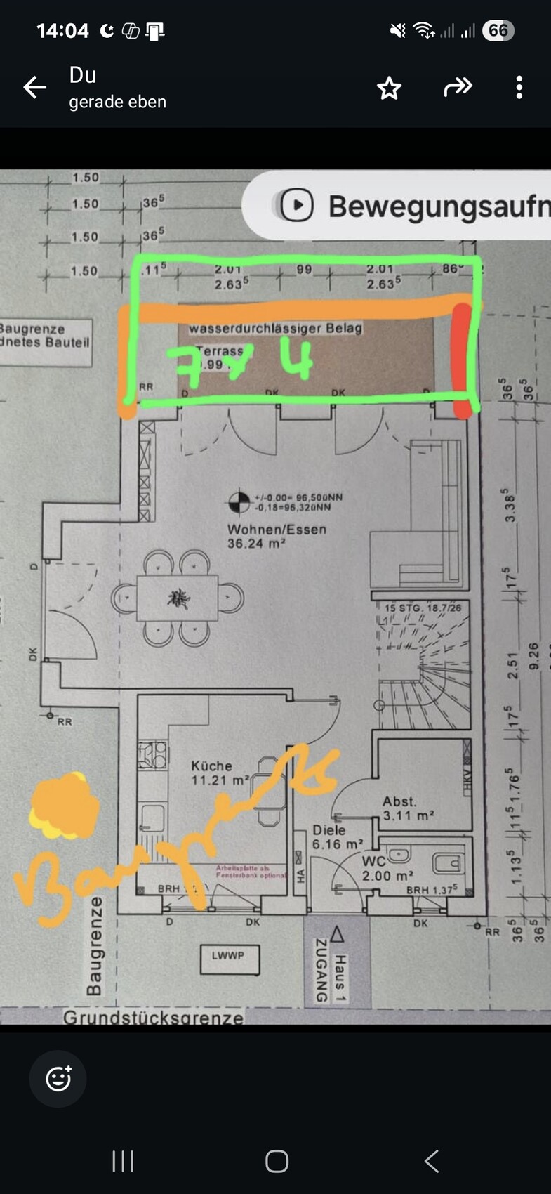

Below is the sketch: The main point is that I definitely want two terraces: one main terrace along the house in the front, 28m² (301 sq ft), and a smaller one on the side, 12m² (129 sq ft). Now I want to connect the terraces, and I have heard different opinions on this. Some recommend offsetting the terrace stones as a pathway, etc. I have actually decided to close off the corner, meaning to expand the main terrace on the side, creating a corner terrace. Sometimes I worry that it might not look good and I’m unsure. We have a large family; I want large tables with chairs, swings, and more solid surface, but without overdoing it. Also, I don’t want to have to take care of a huge garden, so that would be practical for me. The neighbor was not allowed to build wider or bigger due to property division rules limiting the sealed area, but for Jens, that should not be a problem.
Now my question to you:
How would you plan the terrace? The bigger it is, the more expensive it will be.
What kind of slabs do you have, what material and installation method? I have quotes for 2cm (3/4 inch) slabs set in concrete or 4cm (1 1/2 inch) slabs on a gravel/sand base. I want large slabs.
I would like light-colored slabs with anthracite edging. Regarding roofing, I’m not sure if I’m allowed to build 7m (23 ft) wide and whether I can exceed the building limit line. I would like about 7 by 4m (23 by 13 ft)... but that would be 1m (3 ft) over the building limit. On the side, I have already enlarged the living space with a bay window under a special permit; I don’t know if I can add a roof there too. Now I need advice, ideas, tips—I’m a bit lost about what to consider, etc.

- I have already selected the terrace sizes. Terrace 1: 8.50 x 4.20 m (28 feet x 14 feet) = 35.70 m² (384 square feet), and terrace 2 from the bay window: 4.00 x 3.00 m (13 feet x 10 feet) = 12 m² (129 square feet).
- I can afford and pay for that. Terrace roof: 7 x 4 m (23 feet x 13 feet), so 28 m² (301 square feet).
- So, the sizes are fixed. If this gets approved, I will know how much sealed surface area I’m allowed, how strictly this is evaluated, how precise the calculations have to be, and how much buffer I have. Then I will consider how to connect the terraces. If necessary, that could be a few extra square meters built “illegally,” or I might use a different surface material or similar, depending on the approval. If the connection is slightly illegal, it would only be a small area that I might risk — in case of inspection, it would only be a corner that’s too much... but I won’t know that until later.

A terrace without roofing is usually not a problem if it is outside the building line (setback line).
The problem is the terrace roofing, which counts as part of the main building and MUST ALWAYS be within the building line. Now, my main terrace has a building line depth of 175cm (5.7 feet). That means I am only allowed to build roofing up to 175cm (5.7 feet), but I applied for 4m (13 feet). That is 2.25m (7.4 feet) beyond the building line. Towards the street, I would still have more than 6m (20 feet). Along the house, it would not be a problem since the building line runs along the house. The neighbor also has roofing extending beyond the building line (3m / 10 feet). I don’t know if he has permission; I rather doubt it judging by him. Now my question is, how do you assess this—do you think I can get approval for the roofing? What arguments should I present to be allowed to build a 4m (13 feet) deep roofing? I would prefer not to use an awning or similar.
The site coverage ratio, etc., would not be a problem, probably not the terrace alone either, but the roofing. Is this still within reasonable limits? Especially since otherwise, I could hardly add any roofing to the house.

Now my question is, what do you think, do you believe I will get approval for the roof extension? Normally: No.
Bauherrin123 schrieb:
What arguments should I present to be allowed to build a 4m (13 ft) deep roof extension? I would prefer not to use an awning or something similar. Real arguments? None, except: The neighbor built something similar. But that could backfire on the neighbor. I wouldn’t worry about that, since that would be the only relevant argument. So ask your neighbors. Otherwise, use an awning or a fixed sun sail. Those are also more airy.
Is that still within the limits? Especially since otherwise, I could hardly attach a roof extension to the house. You’re too late with that. You knew that BEFORE building the house. So no whining. No one forced you to build the house in a way that leaves no room for a patio roof. That was your own decision.
Oh, and is it within the limits? No. 175cm (5 ft 9 in) is within the limits. Or a sunshade or sun sail is within the limits.
Maybe on Thursday you’ll have a friendly person on the other side who is receptive to your request. But you do not have a right to it (unless your neighbor was legally allowed to build it).
A terrace roof that is considered part of the main building must ALWAYS fall within the building envelope. Yes, this has been stated for years in the regional building codes. A smart builder would have included the roof in the original building application.
2.25 meters (7 ft 5 in) is not 30 centimeters (12 inches), so it’s not a minor issue.
You can’t really argue for special permission, since a roof over a terrace is neither essential nor mandatory.

Be a bit creative. You can permanently install the 1.75-meter (5 feet 9 inches) part and make the rest a "mobile roof." Secure it with wing nuts or something similar to show that you can remove it anytime and store it in the garage. If you don’t do that, nobody will be mad. You can leave an umbrella open all year as well. You can also set up the patio roof completely separate from the house. Then it’s not attached to the house. You can create the transition with an overhang or something mobile. Technically, you’re building a separate fixed tent, which in practice makes no difference from a solid roof.

By the way, regarding the strategy, I completely agree with you. I have already been to the authority with such plans, but they don’t want to cooperate because they’re not motivated to do their job. Even if some people here don’t want to believe me. They don’t bother to familiarize themselves with the files, don’t open the paperwork, reject things outright (like my bay window back then) even though they actually should approve them, and later you get it in writing... The people are nice but incredibly lazy; meaningful consultation is hardly possible.
That’s why I had to take this approach—I first applied for what I want, hoping it might be approved. They will really have to deal with it now, and the appointment on Thursday will be better; they will listen and advise, and if something is missing, they will tell me because they know a building inquiry is in their hands and they HAVE to act. So this is okay; to start a conversation with the authority, I have to proceed this way. But by doing so, I’m also fighting for exactly what I want. Now they’re advising me as well, and if there are problems, I’ll have to make compromises and find solutions, but then they process things fast. I just had to start somewhere.
The building inquiry is therefore for an extension of the patio roof, and now they are reviewing it, familiarizing themselves with the case, advising, and if they do not agree, I will negotiate and possibly submit new applications to get approval. Unfortunately, the authority here doesn’t work any other way. They don’t even bother to reply in general, except for the urban planning department where the women are better. But the official responsible for approval literally gets out of breath when he has to answer the phone. It’s a slightly different order, but it was similar with the bay window—everything was rejected over the phone, no proper information given, then I applied in writing, and after about 100 forms were submitted, it finally went through. No matter what you submit, the authority always says something is missing. That’s why it’s better for me this way: I submit the application, and then we start; depending on what they want, I submit additions, negotiate, and have discussions. When we agree, I formally resubmit the application. Then it’s just a formality. I’m curious. The alternatives you suggested sound good as well, because I thought a 4-meter (13 feet 1 inch) deep canopy would darken my living room. So we’ll see.
