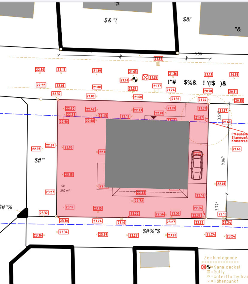

Site plan of the property: house with carport, car, measurement lines and dimensions.

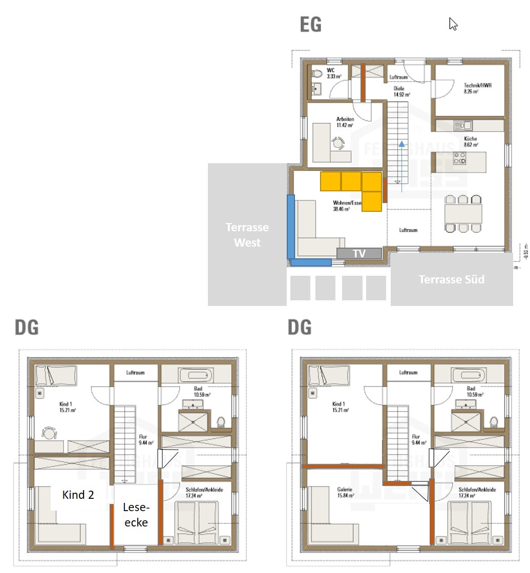

RomeoZwo9 Sep 2020 08:07
Since I was personally addressed, I quickly skimmed through the thread...
What don’t you like about the straight staircase? Actually, I quite like the suggestion from #177 as a basis. I sketched something quickly based on that...
Floor plan of a house with ground floor/upper floor, terraces west/south, living room, kitchen, bathroom, children’s rooms.
Ground floor:
1) Staircase rotated (access from dining area) and built-in wardrobe under the stairs as a closet.
(+) Less dirt from the entrance area being carried upstairs (speaking from experience, that’s annoying).
(+) The downstairs toilet can be made a little bigger and include a shower.
2) Living room window adjusted to the shape of the plot (west-facing garden)
(+) From the sofa, you can look into the garden and at the TV.
Upper floor:
(+) I like that the bedroom is away from the street. The window orientation still needs to be considered, depending on the surroundings.
(+) Both children’s rooms face the garden. West-facing also provides nice light.
- I’m not a fan of open spaces; I would leave both out.
Option 1) Instead of open spaces, a nice reading or play corner with a window seat. Move the door to the bedroom into the dressing room; add another door from the dressing room to the bedroom (not sketched).
Option 2) Instead of open spaces, enlarge the children’s rooms.
For myself, I would probably choose option 1 with the reading corner and place a flat, floor-to-ceiling bookshelf along the wall to the bedroom.

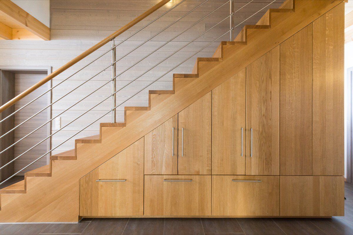

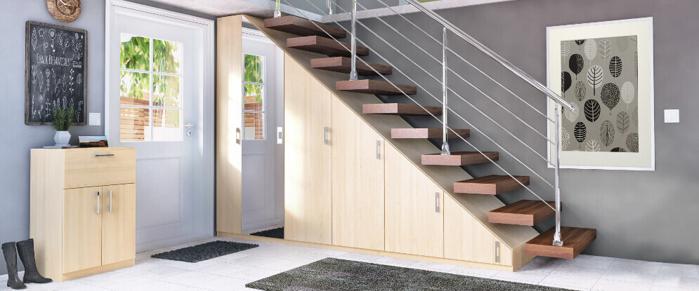

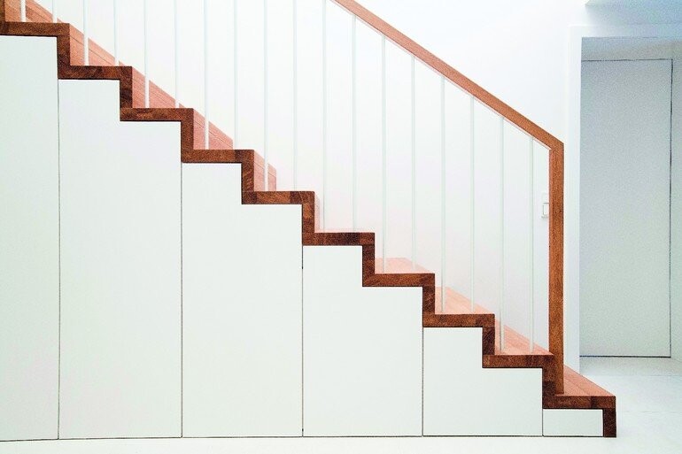

What is actually disliked about a straight staircase?
Here are a few examples with built-in cabinets (source: Internet) ...
Modern wooden staircase with integrated cabinets underneath and cable railing.
Bright hallway with open wooden tread staircase, storage underneath, glass doors and wall art.
Modern interior staircase with white treads, wooden edge and glass railing in a bright room

RomeoZwo schrieb:
I quickly sketched something out for that...
WOW! Many thanks for your effort.
I really like it as it is, and your arguments make sense.
However, I would like to swap the kitchen/dining area with the living room because we prefer the west-facing terrace! Could you mirror the floor plan and determine the dimensions of the kitchen you drew in?
I’m not a fan of open spaces myself. I really like the idea of a reading nook and window seat, and I wonder if the other open space could somehow be turned into a storage room.

I would like to help you, but I see so many question marks.
For example, the floor plan posted by Allessandro and modified by RomeoZwo doesn’t match the wishes you posted here, does it? Half-closed kitchen, at least 13 m² (140 sq ft), home office removed?
Then there was the question of how the rectangle should be oriented. You say you prefer more west-facing garden space because the neighbors’ cars are parked on the south side anyway. But every rectangle posted here actually reduces your west garden. Or have I misunderstood something? Is the red-marked area your property? How deep is the building window (north-south)? In the original site plan, it looks like the 10-meter (33 ft) deep house is already the maximum allowed?
Site plan: red building zone area, gray building, car parking space.
Personally, I don’t find the Allessandro/RomeoZwo floor plan ideal, because it wastes a lot of space in an already rather small house. The entire central axis on the ground floor is practically unusable. Instead, there is a tiny kitchen of 8.6 m² (93 sq ft) with little room for the table and a very modest living room. Upstairs, I find the bedroom borderline small— I estimate it’s no more than 9 m² (97 sq ft).
However, I do find the exterior view very stylish!
Maybe you can clarify things for me, then I can think about your floor plan.
Yaso2.09 Sep 2020 10:37
Würfel* schrieb:
I’d like to help you, but I see so many question marks
For example, the floor plan posted by Allessandro and modified by RomeoZwo doesn’t match the wishes you posted here at all, does it? Half-open kitchen, at least 13 sqm (140 sq ft), office removed??
Then there was the question of how to orient the rectangular shape. You say you prefer more west-facing garden space because the neighbors’ cars park on the south side anyway. But every rectangular design posted here actually reduces your west garden area. Or have I misunderstood something? Is the area marked in red your plot? How deep is the building envelope (north-south)? From the original site plan, it looks like a house depth of 10 meters (33 feet) is already the maximum?
[ATTACH alt="Yaso2.0-Grundstück.jpg"]51184[/ATTACH]
Personally, I don’t find the Allessandro/RomeoZwo floor plan ideal because it wastes a lot of space in an already rather small house. The entire central axis on the ground floor is almost unusable. There’s a tiny kitchen of only 8.6 sqm (93 sq ft), hardly any space for a dining table, and a very compact living room. Upstairs, the bedroom seems borderline small, probably no more than about 9 sqm (97 sq ft).
I do like the exterior look though!
Maybe you can clarify things for me a bit more, then I can reconsider your floor plan.

- Terrace on the west side, since the parking spots for the neighbors are on the south side
I actually like the idea of having a small terrace on the south side and a larger one on the west side.
Given the dimensions of the plot, we want the house not to be deeper than 10 meters (33 feet) so that about 4 meters (13 feet) of space remains on the south side. The width shouldn’t exceed 11 meters (36 feet) so that 8 meters (26 feet) remain on the side.
The plan by RomeoZwo and Allessandro measures 9.50 x 10.25 meters (31 x 34 feet), which in my opinion is within those limits.
On the ground floor, I would consider swapping the kitchen and office, then opening up the kitchen more, and switching the living room and dining area. This would make the kitchen a bit larger, the office smaller, dining area directly adjacent to the kitchen, and the living room a bit further away from the kitchen.
I still have concerns about the bedroom upstairs as well.
