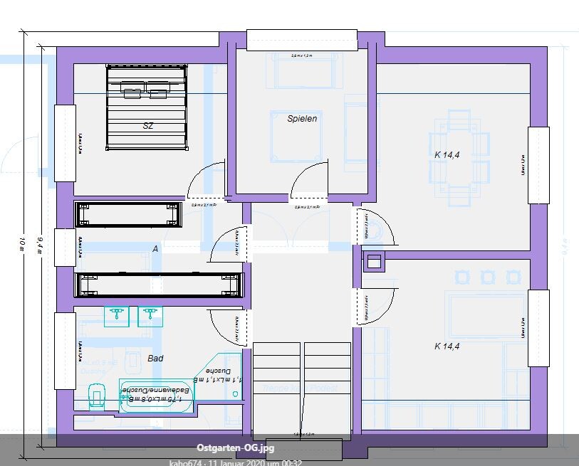

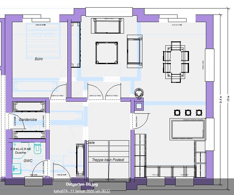

Yaso2.010 Sep 2020 12:11
For a prime facade facing west, I thought about orienting a rectangle with the short side toward the street and only leaving the building setback on the south side. This would probably be under 11 m (36 feet) if you fully utilize the building envelope – still, I considered the houses by @Zaba12 and @Tolentino as the most suitable sources of inspiration.
The only thing that bothers me about the "landing staircase" is the landing itself: compared to a spiral, this landing wastes the space that could be used for steps and makes the staircase roughly as long as the landing is in the floor plan, which means a) it’s overall bulkier in the floor plan, and b) either the stair exit, the stair entry, or both end up pushing into wall areas otherwise suitable for doors.
The all-in-one-solution is, unfortunately, an unattainable dream for designers trying to compress villa layouts. Last seen in Wolperting, but currently on hiatus.
I printed out the floor plans by Zaba and Tolentino and started sketching... ultimately, I sketched so much that I couldn’t recognize anything myself anymore and gave up.
I then searched through the entire category for floor plans and found myself in Kaho’s plans for OWL residents...
Removing the office, but expanding the living room and placing the utility room next to the kitchen... the playroom upstairs becomes an office...
Without the bay window, it has a depth of 9.40 m (31 feet). Can anyone determine the width of the building? Then I would try to redraw it.
Ground floor plan of a house with kitchen, living room, dining area, bathroom, and stairs.
Upper floor plan of a residential building with hallway, stairs, bathroom, bedroom, playroom, and kitchen
11ant10 Sep 2020 12:34
Yaso2.0 schrieb:
I printed out the floor plans by Zabas and Tolentinos and started doodling on them... In the end, I doodled so much that I couldn’t recognize anything myself and eventually gave up.
Except for the last part of the sentence, I’m glad to hear that – would you like to share your doodles? (There’s surely a lot to learn from them.)
Yaso2.0 schrieb:
Then I searched through the entire category for floor plans and found myself in Kaho’s plans for OWLers again...
That makes me happy too, and I will be sure to tell Katja.
Yaso2.010 Sep 2020 14:50
I’m glad about everything except the end of that sentence – would you like to show the sketches? (there’s definitely a lot to learn from them).
I don’t have them anymore, and I wouldn’t have shown them to anyone anyway ops:
