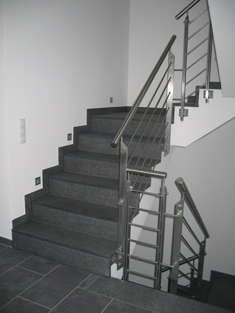

Attached is an example image showing how it might look in real life. We are currently reviewing a few examples to see what possibilities there are—built-in or with railings, natural stone or tiles, with or without an overhang...
