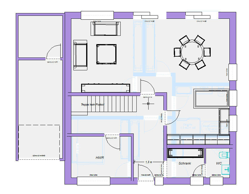

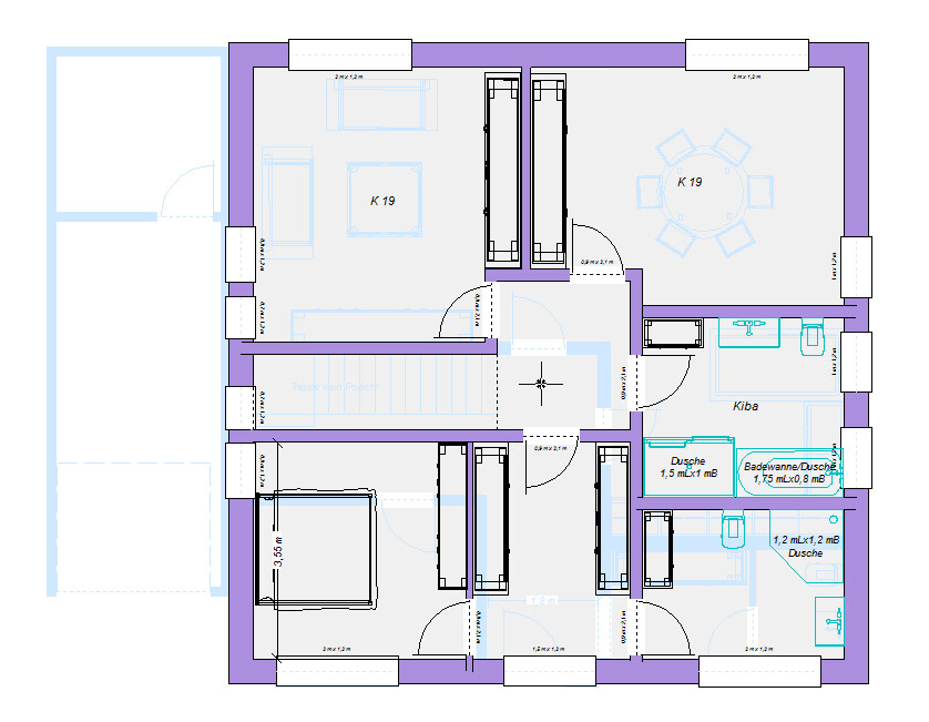

- Where could it still be optimized? Would you recommend different window dimensions or sill heights?
- What do you think is poor or what would you do differently?
- A partition wall will be added in the walk-in closet. That would theoretically allow watching TV from the bed. I am considering a lightweight wall. I plan to place a 211cm (83 inches) Pax combination wardrobe in the closet. The closet is planned with a raw width of 218cm (86 inches). Do you think 218cm is enough for the Pax once the walls are plastered, or how wide should the rough dimensions preferably be?
- Is the hallway on the ground floor too narrow?
- Would you raise the ground level? The house would be 40cm (16 inches) below street level. If I build a terrace into the garden, it would be about 1m (3 ft) difference. You could raise only the house level, resulting in approximately 1.6m (5 ft) difference between terrace and garden. I don’t know anyone living below street level. Raising the garden would probably not be allowed without permits, and affected neighbors likely wouldn’t agree. On the sides of the house adjacent to neighbors, raising is permitted only up to certain limits. I am overwhelmed with the decision.
- Do you have any ideas for arranging the sofa differently and placing the TV sensibly? My husband doesn’t want the sofa back facing a window. I still need to get used to placing the sofa in the middle of the room.
- Is the kitchen size sufficient for a nice kitchen with an island?

Your parents’ area just doesn’t work,
@kaho674 has already got the right approach there Call me Kati, darling.
kaho674 schrieb:
Call me Kati, darling. I’ll call you darling too, Kati, if you want :-*I already like Kaho’s proposal.

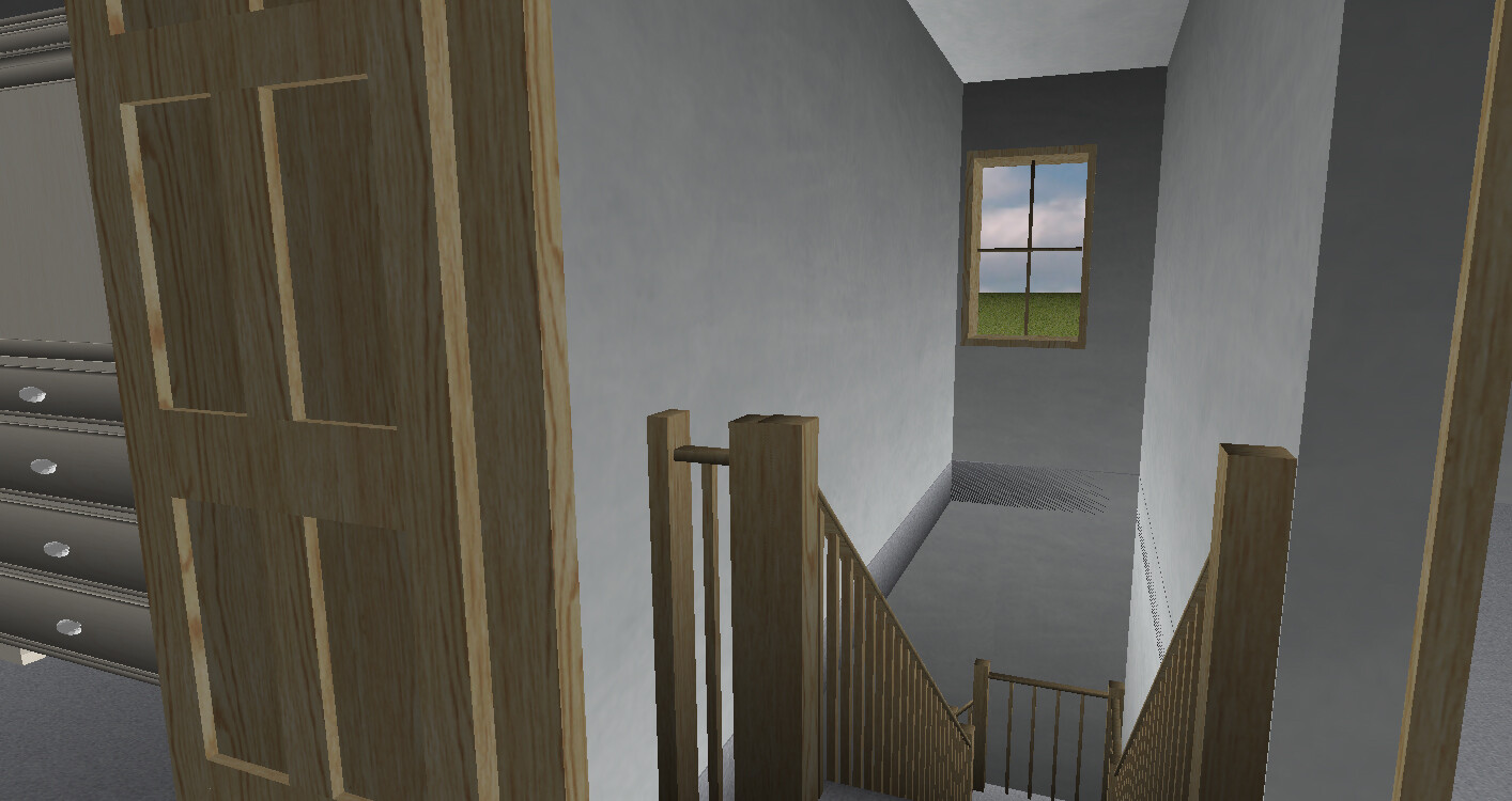

However, I can’t quite imagine the staircase anymore. You go up and immediately have a ceiling above you that gets closer and closer? Doesn’t that feel cramped?
Upstairs, in the hallway, there’s only light coming through a window above the garage by the staircase. What about the window? Will there be enough light to keep the hallway bright enough?
Where is the issue?
Above the stairs, the space is open up to the ceiling of the upper floor. So there is plenty of room. This is always the case when there is no staircase above. The lighting should be about the same as in the current design or even better. Right now, you have a wall in front of half the window on the upper floor. Did you notice that?

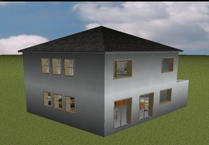

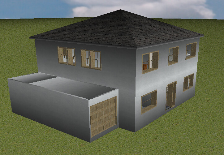

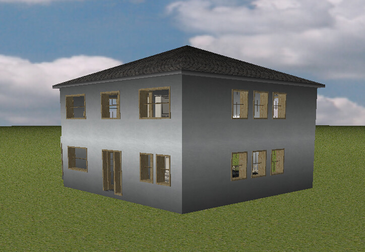

Here, I drew in a few windows for you:
Here’s also a view down the stairs, although the illustration shows a half-landing staircase because my software doesn’t support the other type. The window and door frames all have an awful color, etc., but maybe this helps to give an idea?
Now you could also consider making the window floor-to-ceiling to make it larger and more attractive. Then the adjacent windows should also be floor-to-ceiling for aesthetic reasons, which wouldn’t be a problem.
