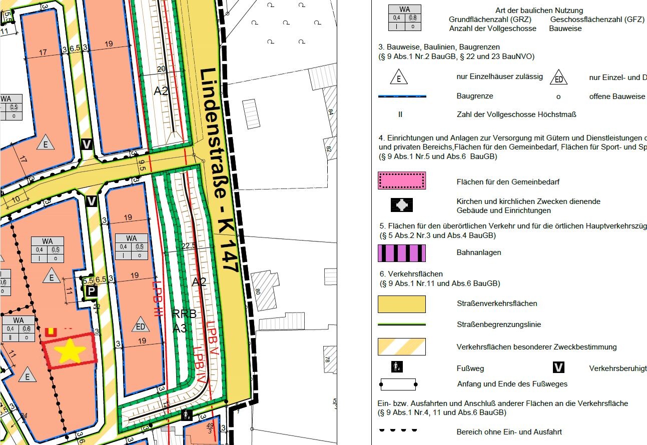

I copied the following from the note about the development plan in post 24:
Page of a planning document: Roof types, roof pitches and roof structures.
Detailed floor plan with color-coded plots, streets and buildings
@everyone ... The building envelope looks good … can anyone see if only hipped roofs are allowed or if other roof types are permitted?
