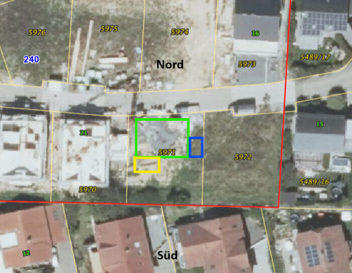

Earthworks Southern boundary: retaining wall needed to manage slope, neighbors (right and left) have done this with 1.4 m (4.5 ft) L-shaped concrete blocks or hollow blocks,
rough offer from earthworks company is available (wall, grading, compacting and preparations for foundation slab, foundation slab, patio and carport [= crane location], graveling, drainage, grounding ring, multi-utility lines, site setup etc. all together approx. 60,000 Euros)

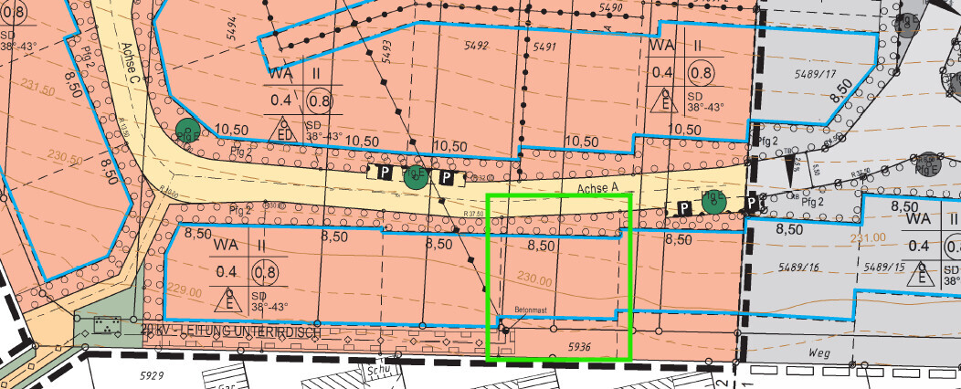

Attached are a section of the development plan and a rough drawing of the house (green), carport (blue) and patio (yellow) on the screenshot from Boris BW.

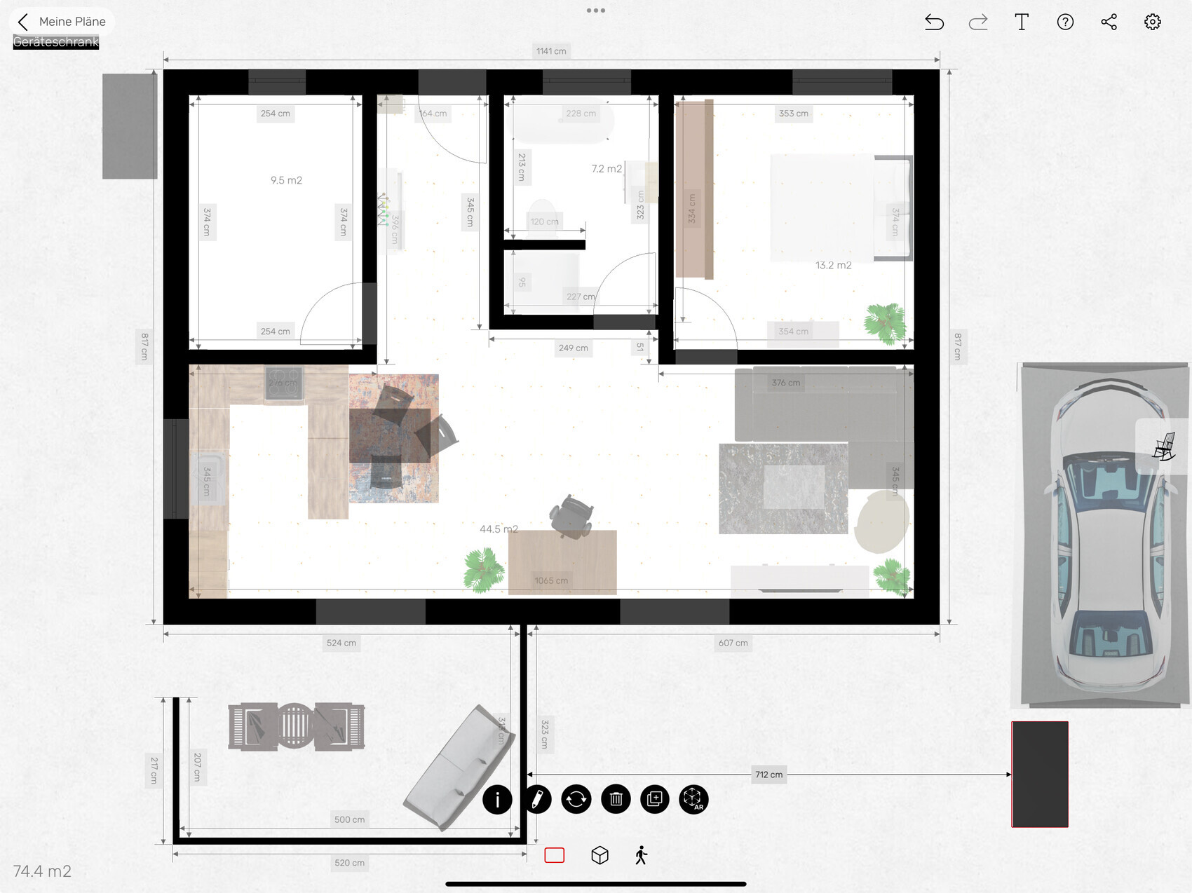

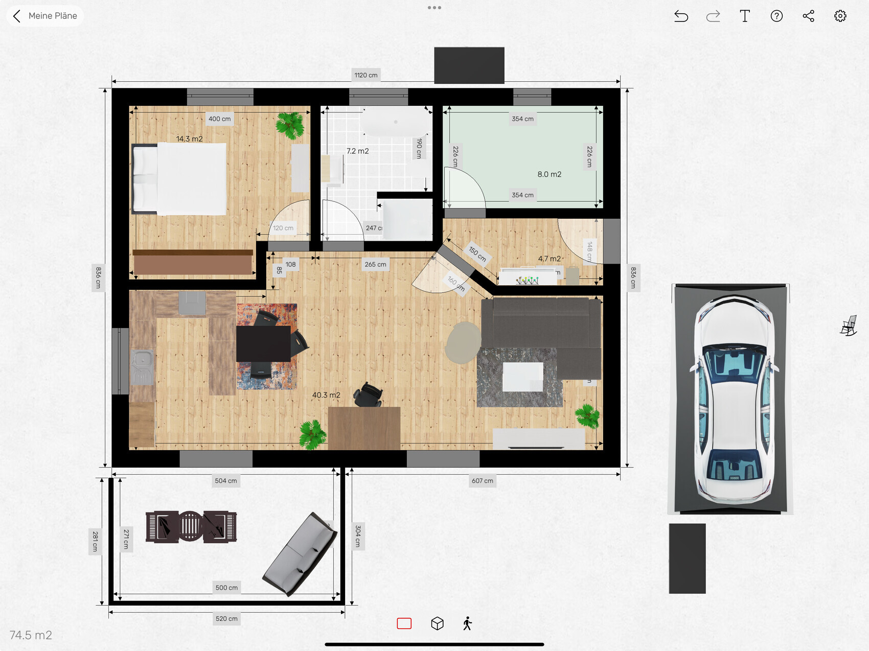

I have also attached my first attempts at floor plans (once with the entrance in the north and once in the east). I probably used the wrong tool for drafting, but I hope something can still be understood or used.
I look forward to constructive feedback.

Regarding the designs by @Newbee-BW
I only took a quick look.
Even if you want to keep the footprint small and be modest, some rules should be followed in the planning. For example, place the wardrobe behind the door instead of right in front, so you don’t have to walk into it (this makes the room feel larger), and avoid having a direct line of sight from the kitchen to the toilet or bathroom.
Even if it’s a small house, it should work well—if not better—than a typical single-family house of regular size.

Exemption for a pitched roof at 30 degrees? Bungalow.
I can well imagine that will not be granted, because the house will visually get lost between two-story buildings. The municipality will probably refer to their zoning plan / building permit regulations.

Even if you only need a small area and are modest in your plans, it’s important to keep certain rules in mind during the design phase. For example, position the wardrobe behind the door instead of having to walk around it (this makes the room feel more spacious) and avoid having to look from the kitchen directly into the toilet or bathroom.
Even if it’s a small house, it should function well—if not better—than a typical single-family home.
Oops, okay. I’m not familiar with planning rules yet, thanks for your input. My main priorities were to have a large living area facing the garden, to avoid the bedroom being next to the utility room, and to have reasonably sized rooms.
