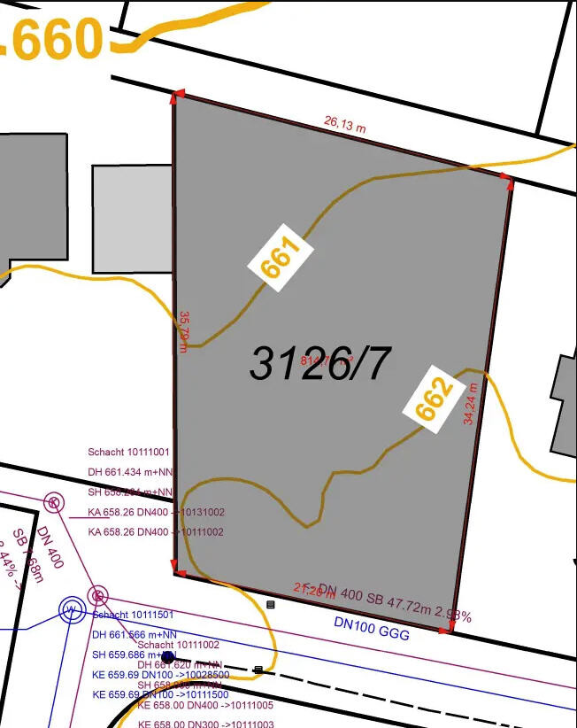

I have a plot of land with a slight slope; the height difference from the front to the back is about 1.5m (5 feet).
For cost reasons, I would prefer to forgo a basement and have as much as possible on the ground floor level. The upper floor is intended to be used either by the children or possibly rented out later, depending on what the children decide to do.
I expect that building upwards with an additional upper floor will provide more flexibility than building downwards with a basement, which is usually less pleasant to live in compared to the same area at ground level.
A large double garage will be built on the east boundary. The neighboring property on that side only has frosted bathroom windows, and the owner (a relative) has also agreed to an easement if the garage is somewhat larger.
Plot size: 814m² (8,761 sq ft)
Slope: approx. 1.5m (5 feet) across the entire area
Floor area ratio (FAR): 0.4
Plot ratio / floor space index: 0.7
Maximum number of floors: 2
Roof style: gable, 30 degrees
Ridge orientation: east to west
Maximum heights / limits: none, the development plan dates from 1980, and various roof and building shapes can be found in this area

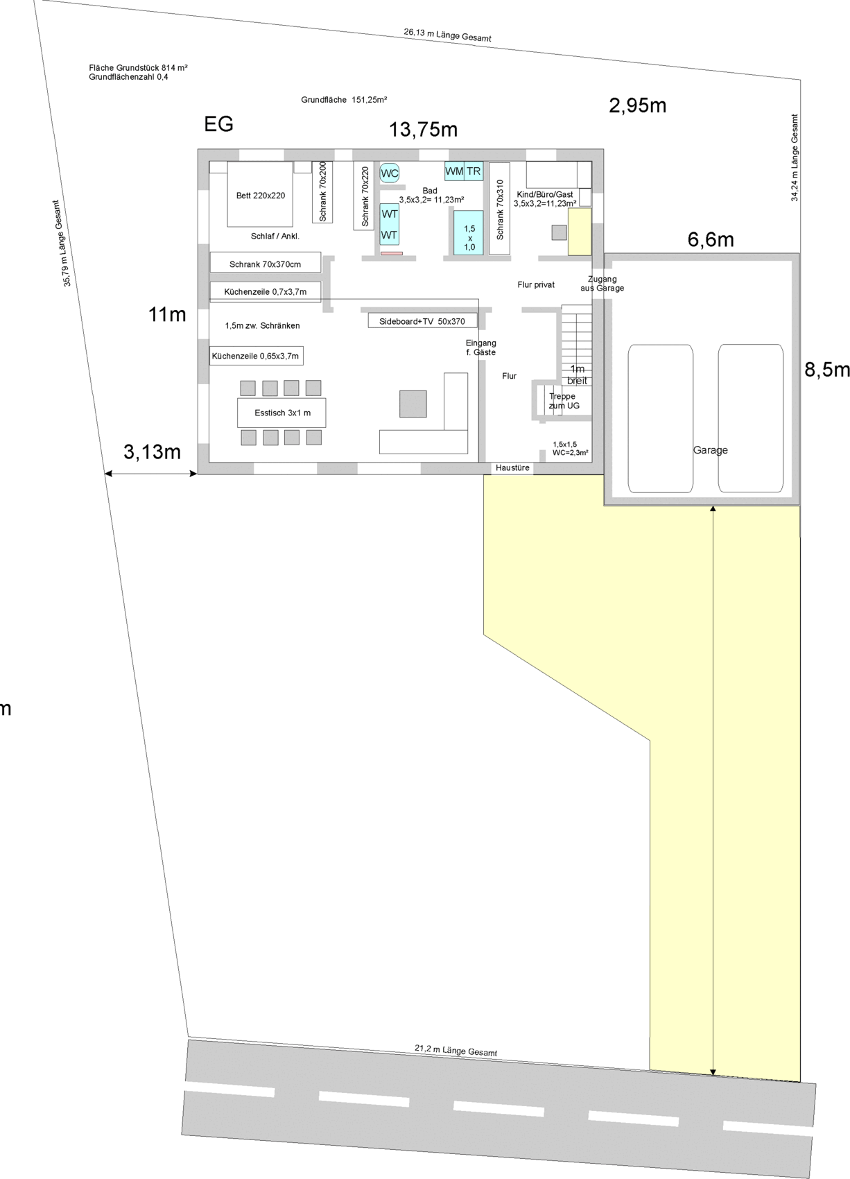

Hello.
When I add up the total costs for my project "basement and two upper floors," I have decided to leave out the attic.
So, only the basement (due to the slight slope of the site) and the ground floor will be built.
We have often discussed the positioning on the property here, and I would like to get some more suggestions from you regarding the layout and room arrangement. The drawn furniture is partly oversized on purpose, so that there will be enough space later.
The remaining children's rooms, utility room, laundry room will be in the walk-out basement with large windows facing north; the windows do not have light wells because of the slope. North is at the top of the drawing.
The ground floor should be accessible without barriers and suitable for living so that the bathroom, bedroom, and office are all on the ground floor.
I actually like version B quite a bit, but it includes a 19.2m (63 feet) long driveway: as recommended, I have tried to create a "private zone"—visitors usually only see the hallway/staircase, guest restroom, and living room. From the garage, I can reach all rooms through my own hallway. The routes to the bathroom, bedroom, and kitchen are reasonably acceptable.
Now I keep considering how to shorten the long driveway (here, sometimes snow at 660m (2,165 feet) elevation, paving work, yard maintenance, etc.), so there is version C with the garage at the front by the street and the house and garden rotated by 90 degrees to have south and west-facing sides.
Garage on the property boundary, house 2.5m (8 feet) from the boundary, footprint roughly the same (150m² (1,615 sq ft)), living/dining/kitchen area about 50m² (540 sq ft), entrance area for guests with coatroom and guest restroom, private area on the right side of the house with entrance through the garage, bathroom, bedroom.
Now, I still need the staircase to the basement and an office on the ground floor, but I don’t know how to arrange them.
You are also welcome to suggest completely different options. The must-haves are:
- Access through the garage
- Bedroom with a walk-in closet area (no separate wall needed, a wardrobe unit is sufficient)
- Living/dining/kitchen area of about 50m² (540 sq ft) on the south or west side
- Bathroom on the ground floor with a double sink, dryer and washing machine, and a walk-in shower
- Office/children’s room of 10–12m² (108–130 sq ft) on the ground floor
What else could be improved in version C, or how could the rooms be better arranged?
Thank you very much.
Ralf
